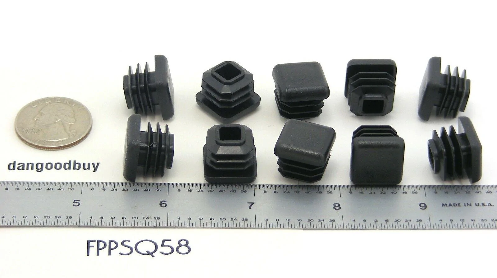

@G8R some ideas and solutions for the defrosters.....
https://www.jlwranglerforums.com/forum/threads/question-regarding-the-windsheld-defrost.15276/
I’m
gonna try some of the plugs mentioned from McMaster. See if it disperse the air flow better.
Cheers
Wow!
Just read all 22 pages..(it’s raining here..) Anyway, the bottom line is that you can buy these plugs on eBay and insert them into the defroster holes starting in the center and work your way out.
You’re welcome..
https://www.ebay.com/itm/24-Square-...h=item3b281733d0:g:ozQAAOxy~dNTHKhm:rk:6:pf:0
Otherwise we could ask @steffen707 to make a plate (not out of plywood!)

HEY HEY! I just bought those exact squares! I already was caught up on that thread and been following it for the last 4 pages or so in real time. Don't push the plugs too hard or they'll pop below the vent openings.

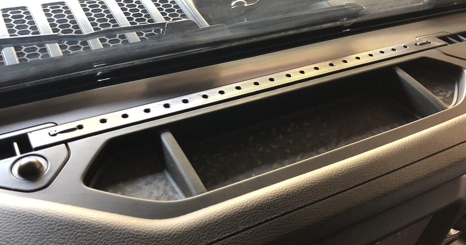

I'm actually planning to make an aluminum plate with holes drilled into it, i'll need to play around with how many and how big the holes are. Got this idea from JL Forum member TRZ Question regarding the Windsheld defrost

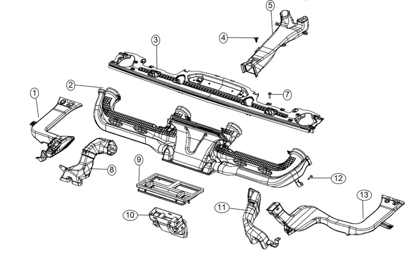

With the squares you really only need about 4 (original square size) openings for 14-18" of center section to still get tons of airflow in the middle, but also air will finally come out the sides. I mean look at how dumb this design is, no wonder all the air comes right up the middle of the windshield. There's nothing forcing it to go to the sides......
Jeep Gladiator First time ride in snow/ice JL HVAC ductwork

I jumped in my truck tonight after letting it warm up for about 10-minutes, the passenger side defrost was pretty useless.
Jeep Gladiator First time ride in snow/ice 900F82C4-50E6-4120-B3E8-FAA8A1BA5D86
In a pinch, I held a sheet of paper over the vent near the center (to divert the air), and the passenger side pretty quickly defrosted, but it didn’t seem like anything was going to happen without some intervention.
Let us know if you make any progress in that air diffuser design.

Where did you get the parts diagram?
