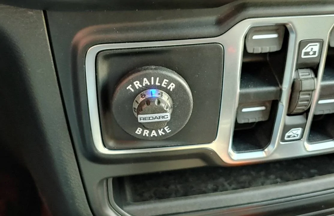

I didnt see any mention of a trailer brake controller. Hopefully, you installed one.
I see people talking about the Red Arc. Which one is best for the Gladiator ? Thanks
GeneralMaximus
Sep 12, 2023
573
1,050
Las Vegas
JTM
I got the Mopar one. Plug and play install. It replaces the cigarette lighter and looks stock.

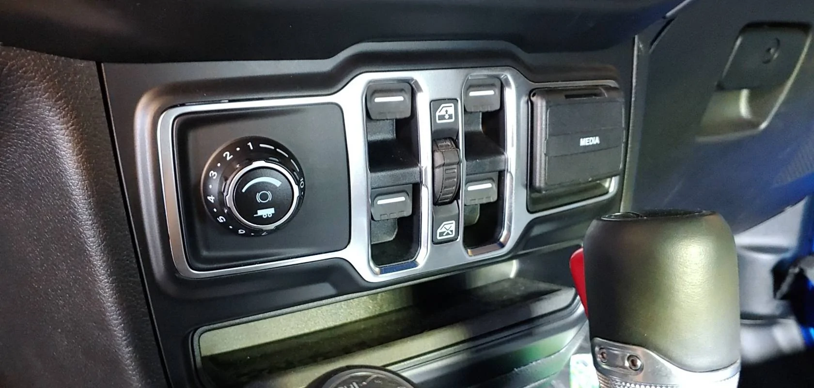

I've had both the MOPAR trailer brake controller and the Redarc (Australian company) controllers.
The MOPAR control knob looks more "factory" but the Redarc one can look great, too.
Both are basically plug and play.
Redarc controller knob appearance ->

MOPAR brake controller knob appearance ->
Jeep Gladiator First time towing and impressed . 20201030_154722_HDR
