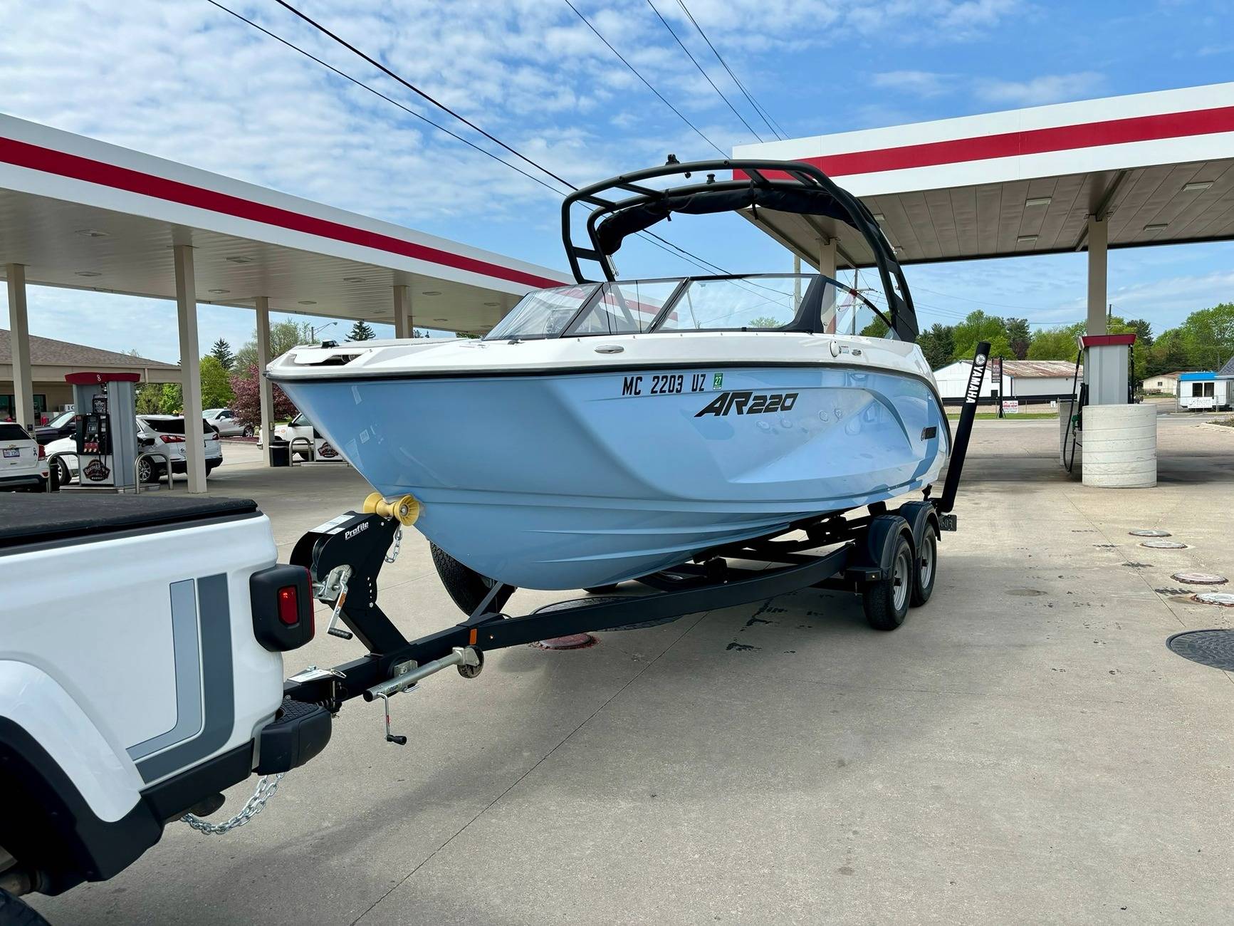

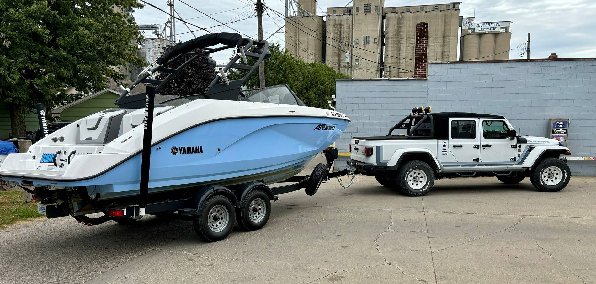

I know it was asked for a which one to buy but if you feel like inclined to do so… U-Haul guide. The guide says coupler height is approx. 18” … it’s usually is in the ballpark of 18~19”.
I agree with you. My hitch is 18" off the ground which leave my trailer level on the Yammi Jet boat.

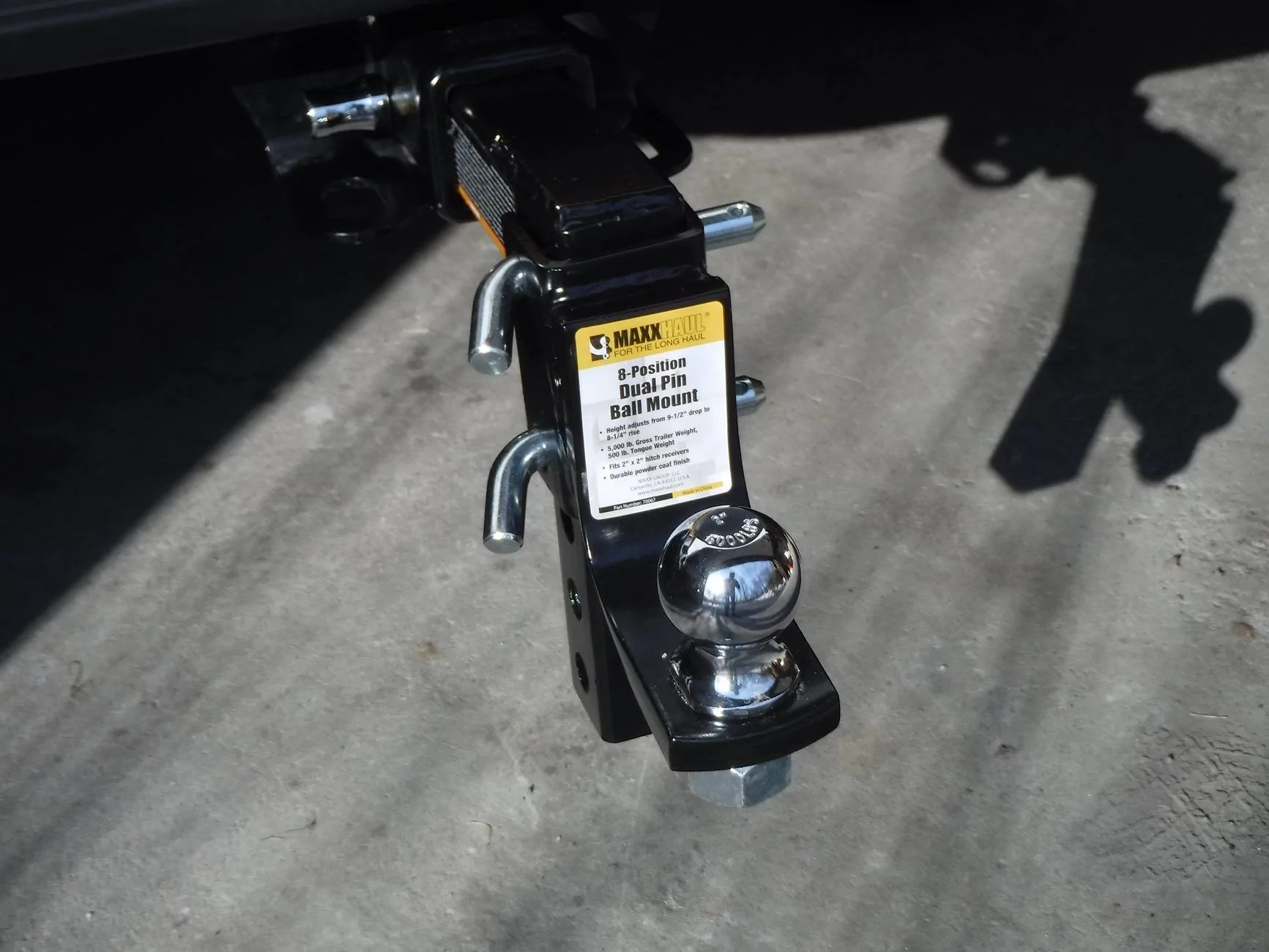

To properly determine the proper drop hitch depth you need to take both the trailer and Gladitor to a flat, level surface. Then level out the trailer. Measure the trailer hitch to the ground. Then measure your Hitch to the gorund. There should be no more than 3 inches between the two. Subtract the taller from the shorter and that give you your proper drop hitch length.
Ideally, you want the truck and trailer to be perfectly level.

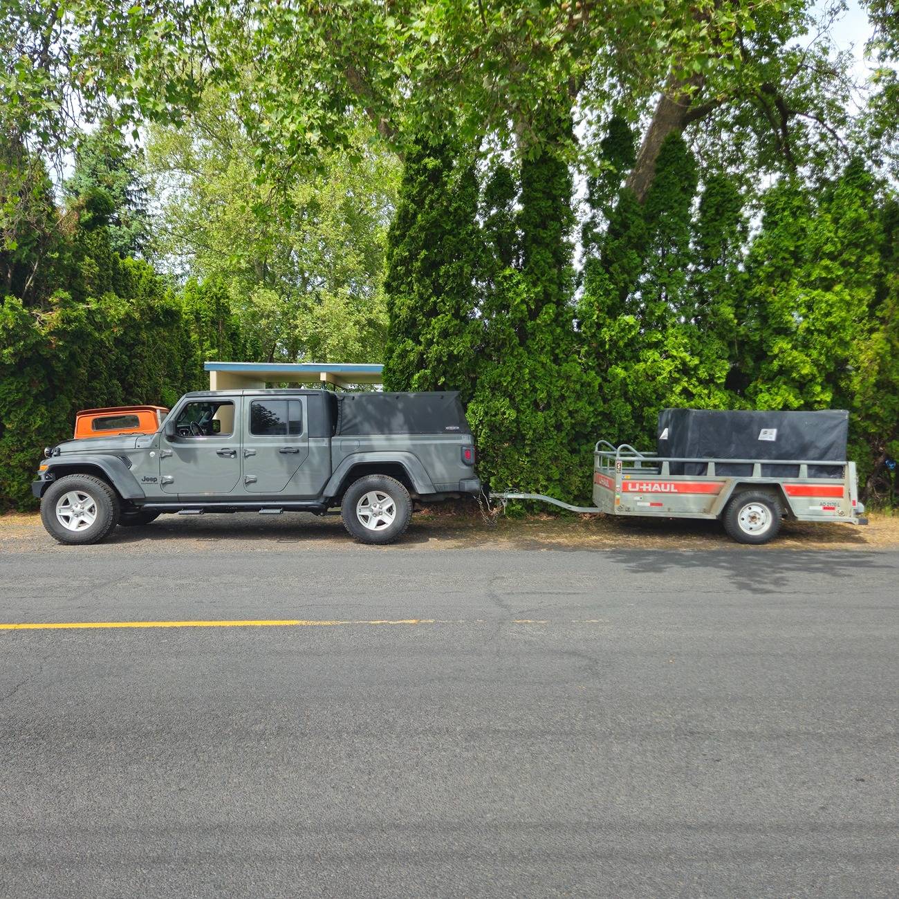

I got a hitch with a 2 inch drop. The uhaul center is a hottub store. The old lady behind the counter printed out the contract and pointed to the trailer I rented.
