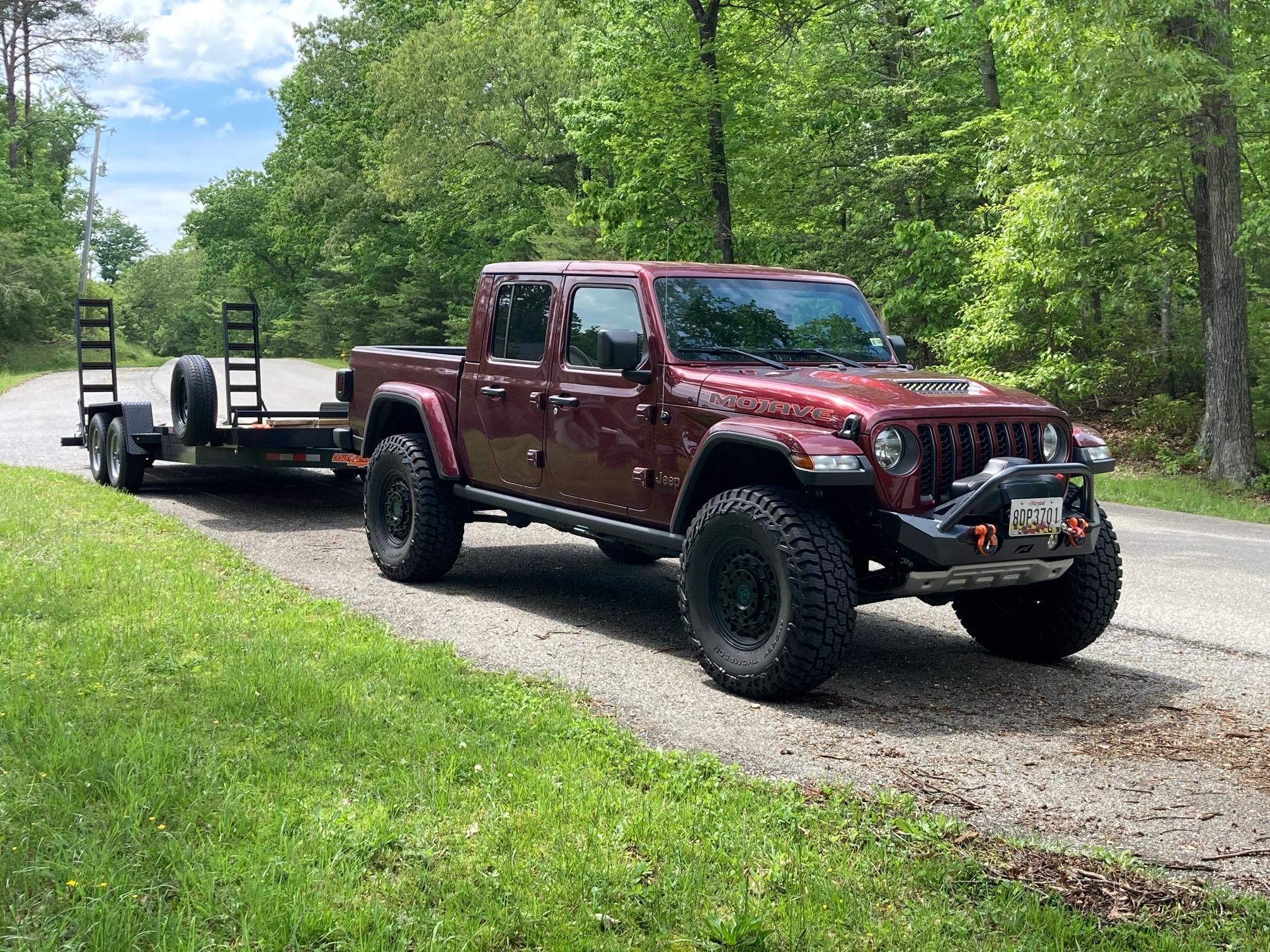

I have a '21 manual tranny Mojave and towed with it for the first time this past Monday.
It's on a 2" AEV spacer lift, 37" tires, and I have not regeared the axles yet - which IMO sucks in many ways. This will be remedied soon as I plan on installing 5.13's and locking the front.

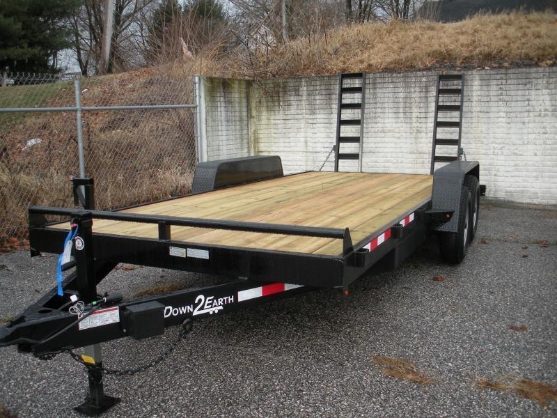

I picked up a new HEAVY (~2,600#) 20' 10,000# GVW equipment trailer so that I could tow my 1 ton YJ rock crawler, plus either a Honda SXS, Yamaha 700 Kodiak quad, or the Gladiator.
Although the trailer was empty with exception of a spare tire, the Gladiator did NOT like towing this beast geared as it is, which probably goes without saying.

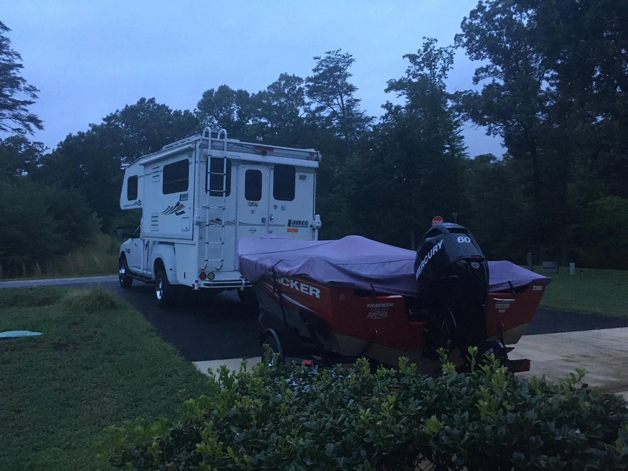

I have a Bass Tracker Pro Glide V16' aluminum boat that I'll occasionally use the Gladiator to tow with.
As far as the new trailer goes, I have a Ram CTD dually for tow slut duties that'll tow the new trailer & whatever junk I put on it, plus it's Lance slide-in camper.

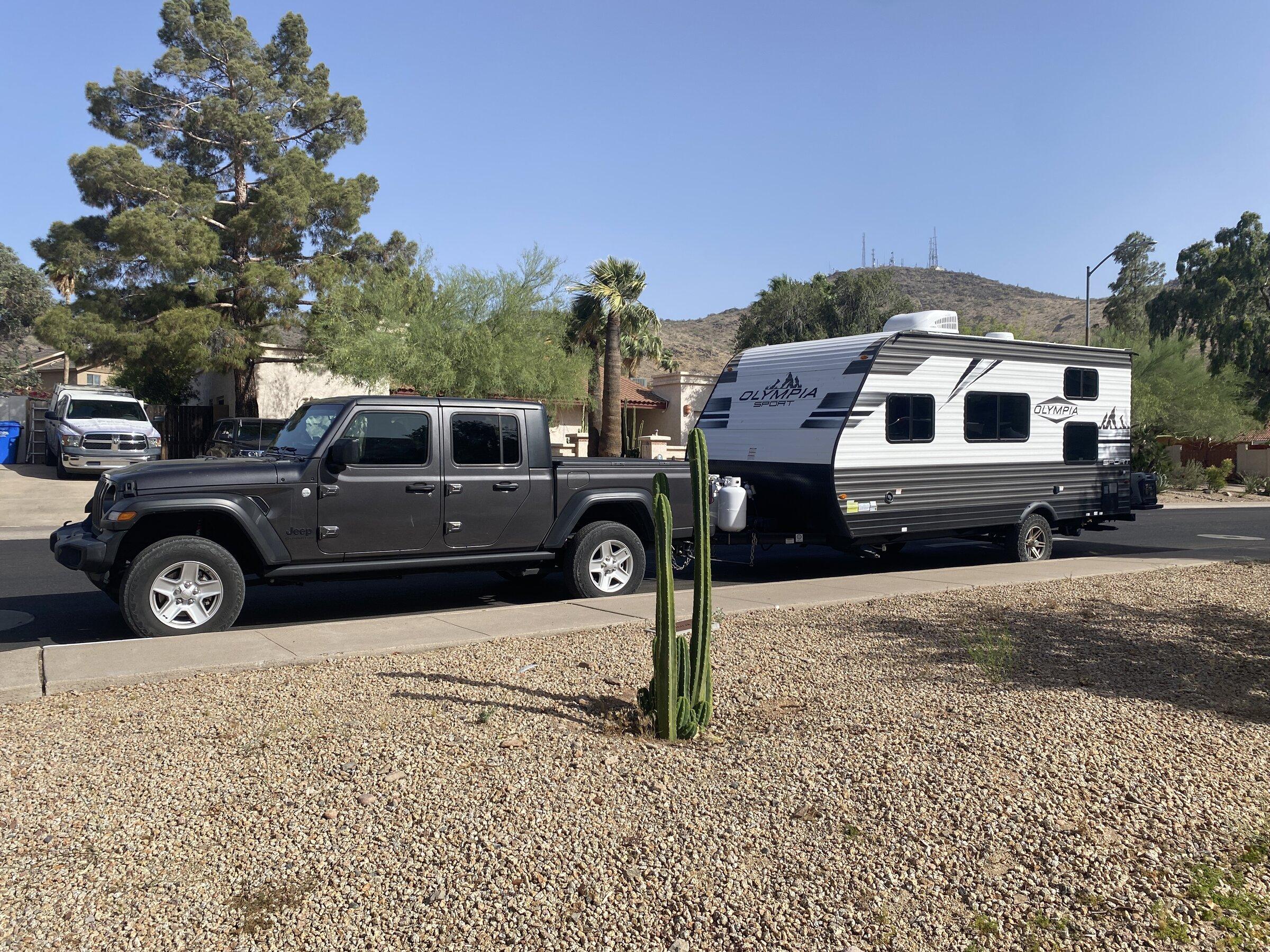

My 2020 Sport S non maxtow handles my boat at approx. 4500 pounds with out a problem. I also pull a 18' enclosed trailer with a 12" raised roof. The trailer doe no weigh as much as the boat but the wind load is a lot more. No problems pulling ,pulling the trailer I average 12-13 MPG the boat 14-15.

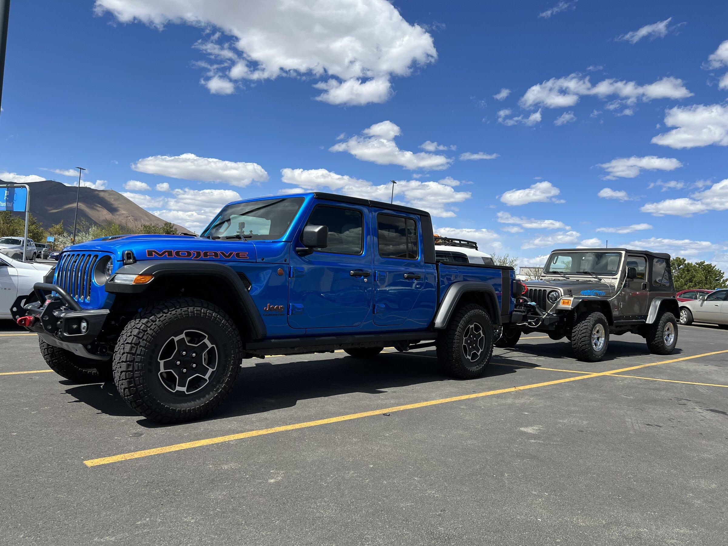

Enroute to Moab currently with a group of family.
Mojave is fully loaded with a bed load of coolers, tools, chairs, food, etc.

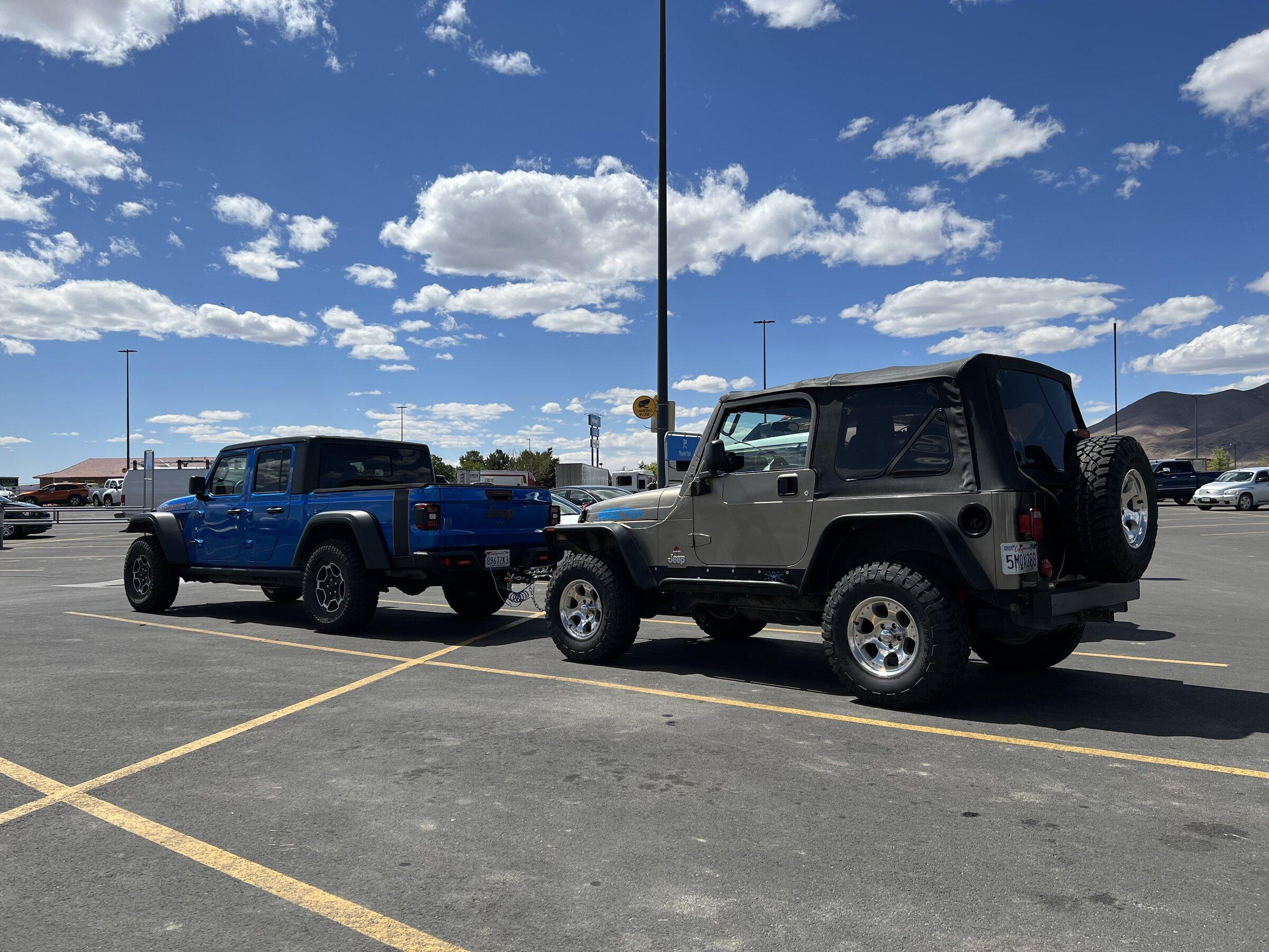

Flat towing the TJ which so has stuff in it.
I’m getting 10mpg.
Not great, but not unexpected. Any slight incline and it drops to 5mpg. And it’s at 6k rpm often.

It's tolerable in 1st to 4th as is, but it's certainly not ideal at all. There's very little acceleration in 5th or 6th unless going downhill.
Yes, I've spoken face to face with a number of folks with the manual, 37's and 5.13's or 4.88's. Plus I've read numerous threads/posts here set up the same.
For where the Gladiator will be wheeled in the not too distant future, 5.13's and I'll either install a Rubi case or most likely an Atlas will need to be installed due to the crawl ratio I'm building towards.

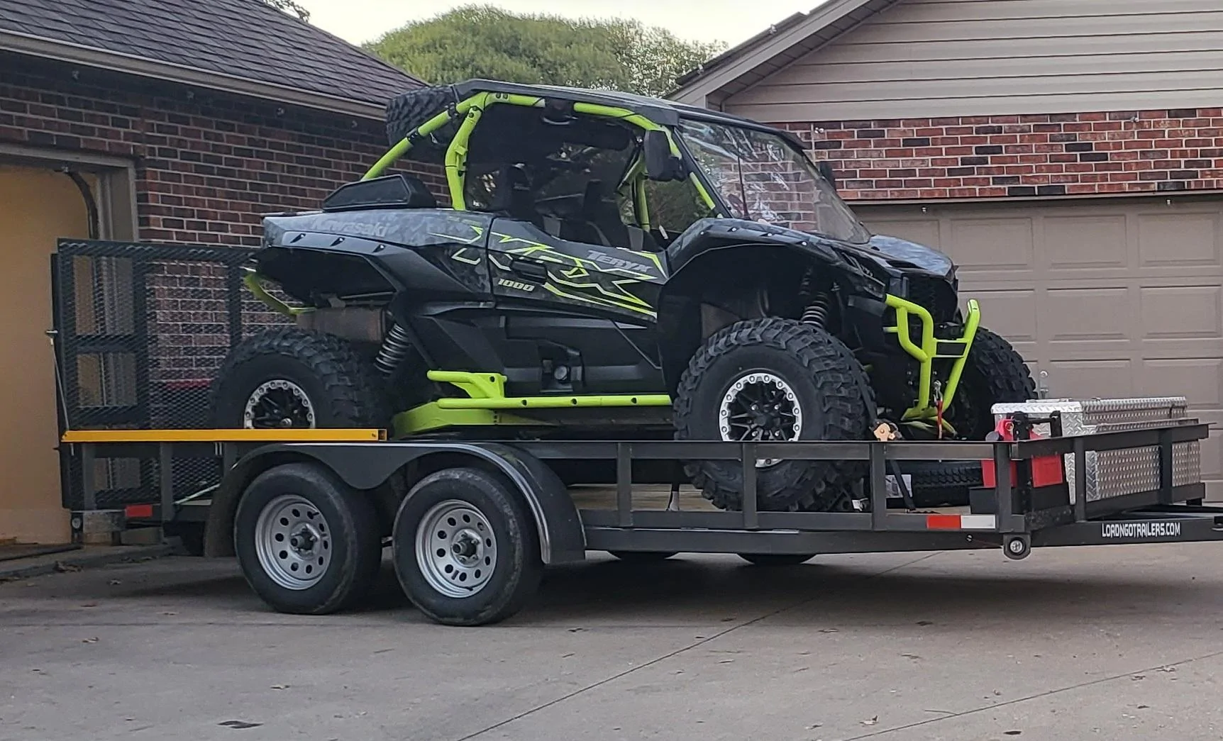

What I normally tow, 7x18 trailer, around 1300lbs, KRX is about 2400 lbs. I get 10-11 mpg. Ordered my diesel last week...tongue weight with this setup is right at 350 lbs (yes, I do have a tongue scale) Tows this like a champ, 5 out 5 stars, would do again. :)
