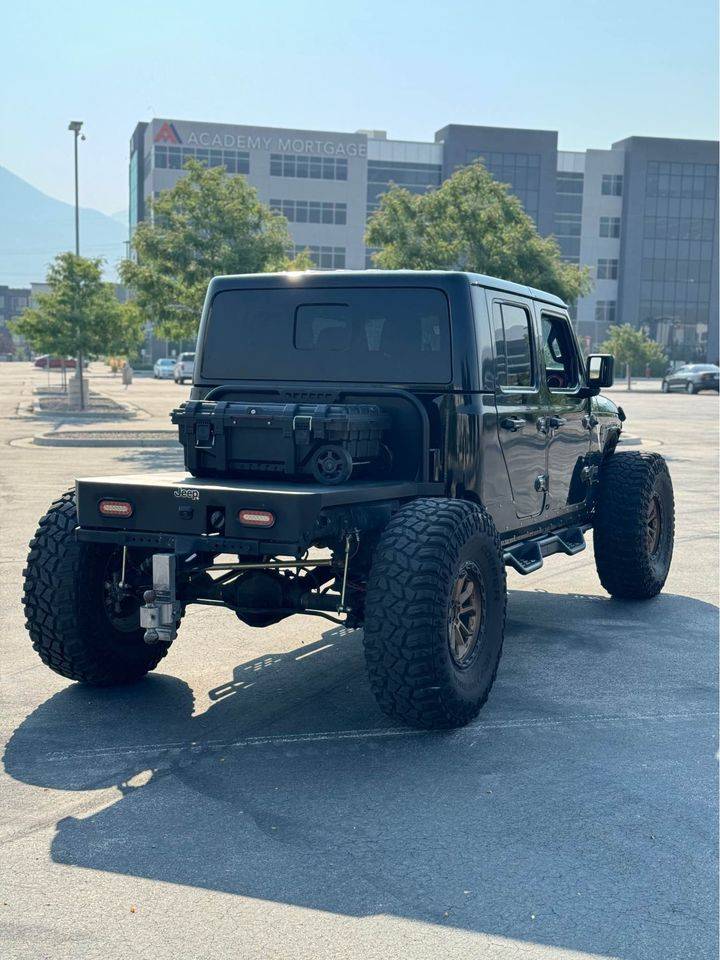

OK, but what's the benefit over a regular bed?
  • Better able to be knocked around without getting seriously damaged
  • Sits up above the wheels so you don't have wheel wells inside the cargo area
  • Larger cargo area because you don't have the hollow areas between the inner and outer skins of the bed
  • Stronger cargo floor and tie downs
  • Headframe to protect the cab and roof from damage (doubles as a place to put lights)
  • Can be equipped with drop-sides for easier access to cargo.
  • Usually have locking storage boxes under the cargo floor or behind the rear tires.
Just off the top of my head.

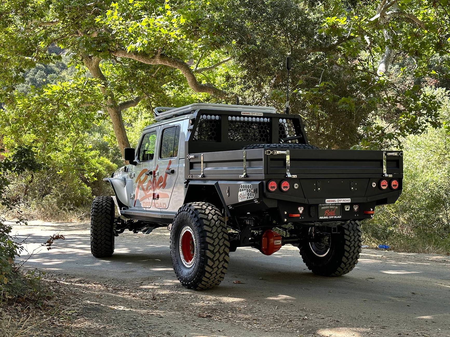

This one looks great:
https://rebeloffroad.com/rebel-flatbed-tray-canopy-system
But you’re right, not cheap. But I think it would make the bed much more useful. And more durable, lighter and better departure angle.

Oof, "Request Quote" button always foretells a big bill. That is exactly what I'd be looking for minus the ladder rack. The rear end looks really great in this setup, great angle and nice that the tow hooks remain in place. It's like a Hilux bed.

I had an older Ford with a Lunber flatbed but I custim built it from oak and it mirrored the fram and then the deck was resessed into the frame runners it was a very sleek job. But ultimately lumber even the oak I used will not hold up for more than 3 to 5 yrs due to wet,dry heat cold drying etc..
Metal is the way to go . Use tubular steel of a lesser thickness to acheive strength without weight. Ultimately the suspension will have to be beefed up. My suggestion is air. Not just cheap innercoil air bags I am speaking of coil spring removal and truck air bag type replacement. This will be the only way to counteract the load associated with such a rig as what you show in the pic. Additionally starting with the Dana 44 is probably not idea. I suggest a set of Dana 60 axles from and rear . Unless the Overland box plus load is not expected to exceed 1200-1400 pounds. One must also account for the top heavy nature of a box like that on a Jeep suspension. I again go back to the bigger options. When offloading even mildly certian dips and plunges will get you in big big trouble. Cheers good luck on the build !!
