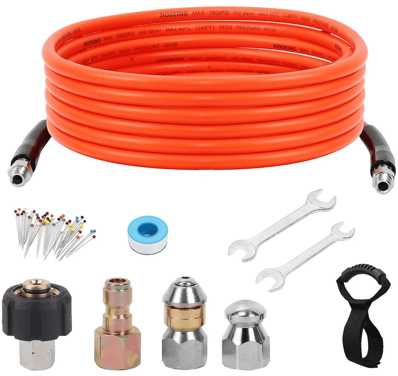

Bought one of these for flushing the mud out of the inside of the frame rails:
Jeep Gladiator Flushing inside of frame rail 1720551366727-f6
Amazon.com: 15FT Sewer Jetter Kit Pressure Washer,1/4‘’NPT Drain Cleaner Hose 5800PSI,With Sewer Cleaning Tool High-Pressure Nozzle. : Patio, Lawn & Garden

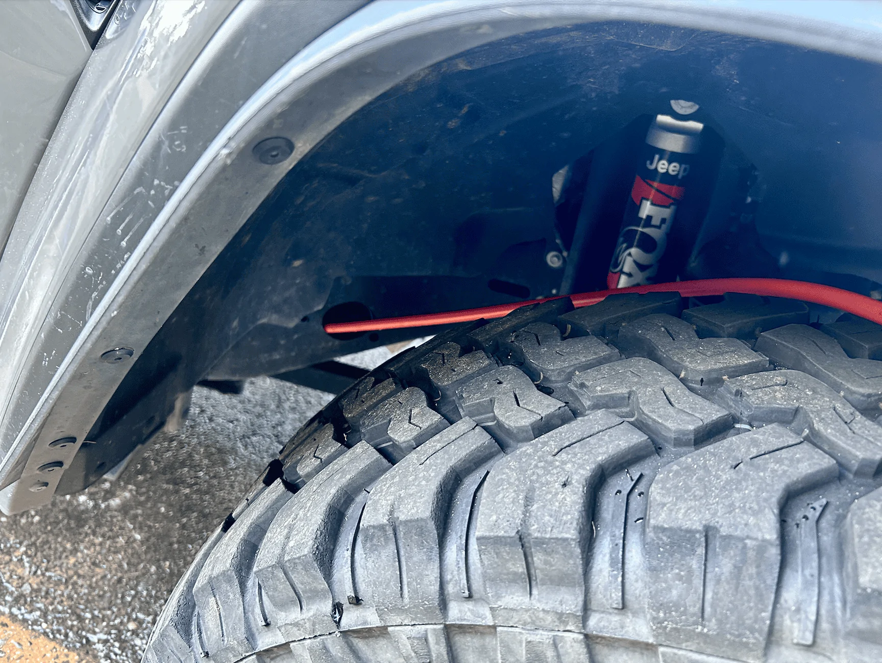

Used the rotating nozzle on one end of the hose and attached the other to my pressure washer spray gun. Inserted into the frame rail from the front tire well on each side. Worked really well. Pushed it down all the way to the end. Had to jiggle the hose in a couple of spots due to a bolt sticking up inside (maybe from my rock sliders). Once at the end, pulled the trigger and the water came out all brown and later turned clear. Then pulled up the hose a short way until the water was brown again and repeated until the nozzle reached the entry hole in the frame rail. Very pleased with how well it worked. Fifteen feet of hose is plenty long.
