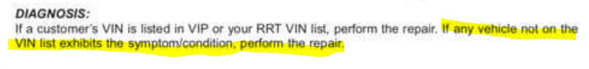

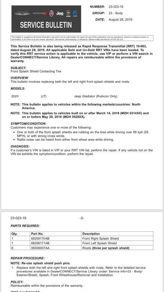

Saw this on Facebook. Hope it helps someone

smlobx Well-Known Member First Name Eddie Joined Jun 28, 2018 Threads 86 Messages 2,644 Reaction score 4,502 Location Mid Atlantic Vehicle(s) JTR, F-350 diesel, Porsche Spyder, Model Y Occupation Semi retired consultant Aug 28, 2019 #3 So Rubicon’s built after May 29 are not affected? Did they make adjustments in materials during the assembly process?
ksh67 Well-Known Member First Name Kevin Joined Aug 18, 2019 Threads 10 Messages 123 Reaction score 172 Location Madison, WI Vehicle(s) Sting Gray Sport S - Ordered 8/7, delivered 9/9 Aug 28, 2019 #4 Fix it if within the date range or if the vehicle has the symptoms.

2020 SCRAMBLER Well-Known Member Joined Jul 30, 2018 Threads 18 Messages 525 Reaction score 899 Location Los Angeles Vehicle(s) 2020 Jeep Gladiator Jan 19, 2020 #6 Mine is exhibiting it...July 2019 build. Are these just the same splash shields and should I expect the new ones to do the same? Sponsored
