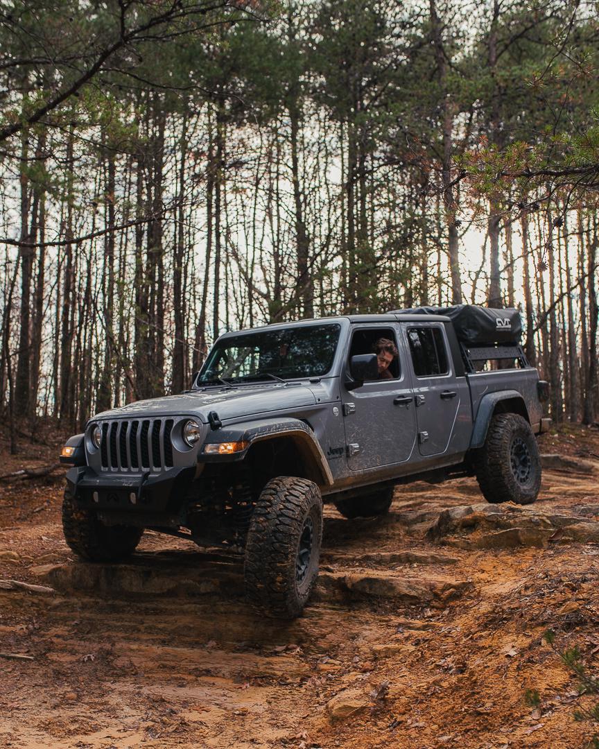

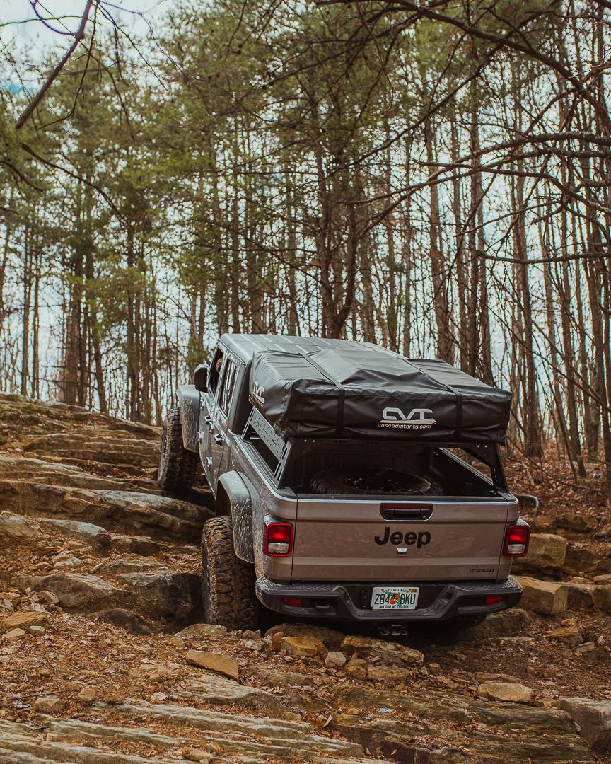

I'm running 38x13.5 Milestar Pats on stock Max Tow axles and wheel pretty hard. So far, they've held up just fine. I may do a swap sometime in the future for my own peace-of-mind (and because it would be fun), but for now, I'm in the "try it and see what happens" phase!
