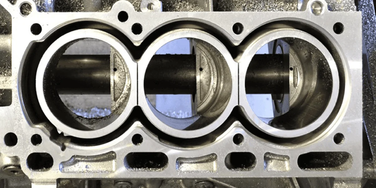

I know not much, but I like machinery. The term "open deck" is new to me, so I used my google fu to learn. I found that the rods in the stock engine are forged.
3.6L Pentastar Engine | Dodge Challenger Forum
"An open deck, as the name suggests, is pretty much fully open between the cylinders and the engine block walls. Open deck designs have the coolant channel cast into the top of the deck. This design improves cooling and reduces hot spots in the cylinder but provides much less strength and rigidity at the top of the cylinder. "

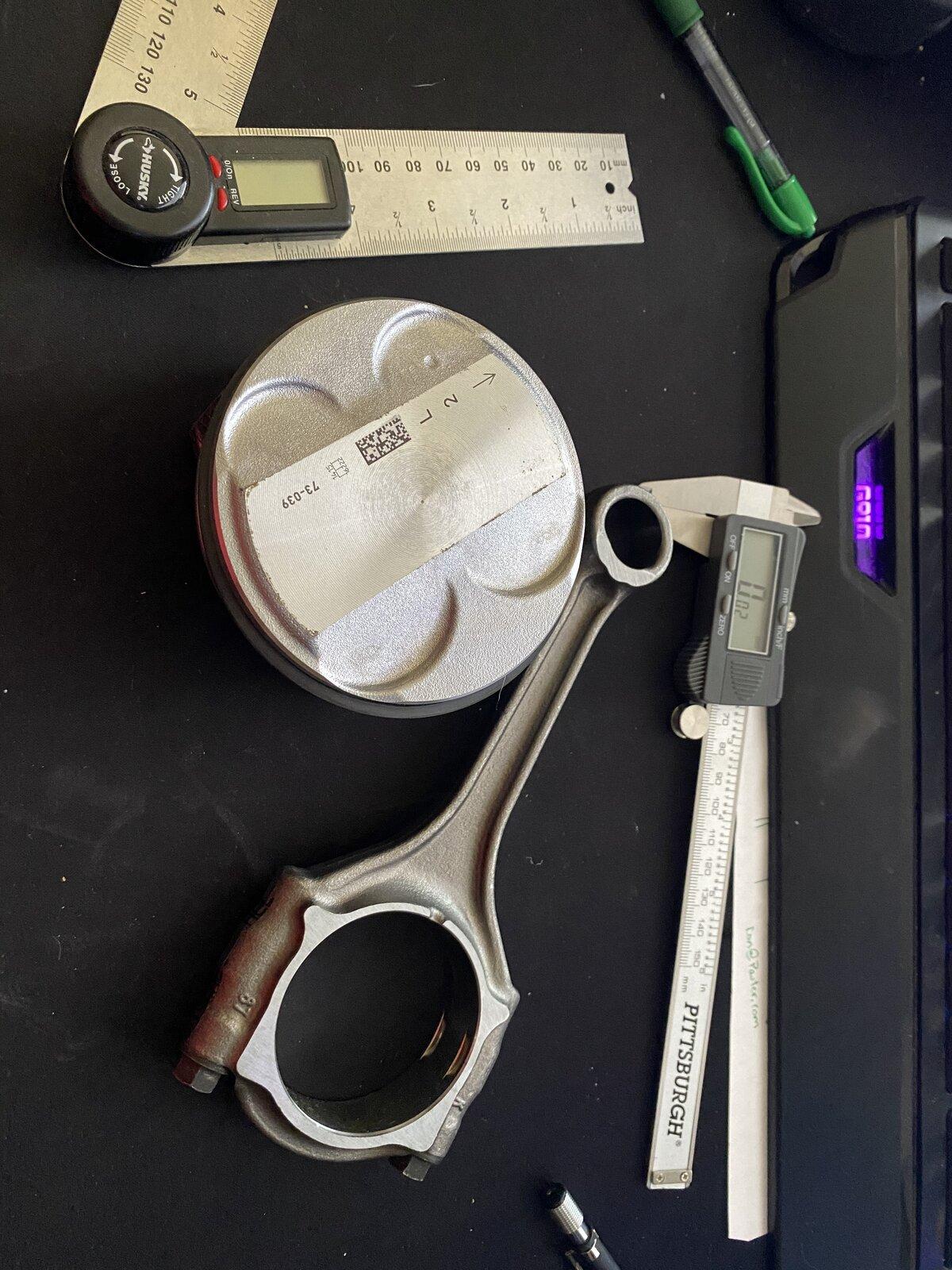

Tomorrow I am purchasing a rod/piston combo. I will be sending the corresponding pieces off to have them produced forged and ready for boost.

Already Talked with Hamburger about getting them a set of rods and pistons to throw in a block and put their kit on it and see how much it can make on the engine dyno... maybe even on a bigger supercharger and really stretch it.
