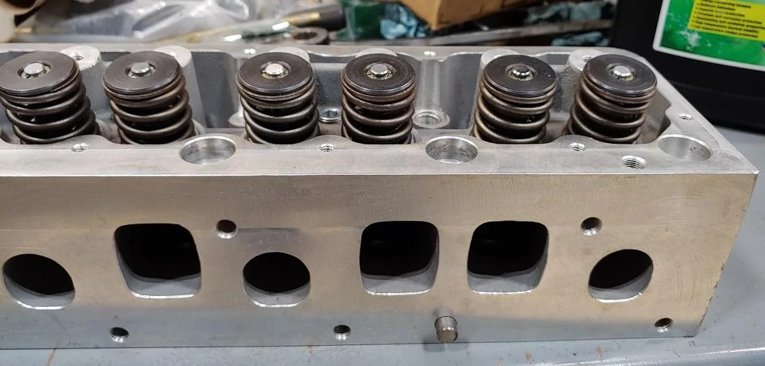

LOL - twin brother here, eh? Yeah, I can relate. Give me cubes, porting, a well-designed cam and I'll give you power.
Here's a 1 of 3 made prototype 4.0 head I'd love to take time to put onto my SX4's 4.0 but it runs too danged nice as it is and it's quite a job tearing that thing down in that little engine bay. I shoe-horned things into that engine bay and I just know I'd mess up the paint and finish under there pulling a long cast iron head off and there's zero room to get to the manifold bolts.
I have another 4.0 with the later intake style (96 I believe) I can play with, I guess.

Nice!!
I had a buddy in GA. that stroked his 4.0 out to a 5 L wet sleeved in his XJ..... Way to much $$$$ and work in it then scrapped in for a small block chevy engine. I wish I had the money to do stuff like that. Young we want more power and speed then some of us then want more MPG's n power. :like: I never really needed more speed or lacked power in my MJ, XJ or LJ just maybe another gear higher in transmission in LJ like a over over drive ☺
