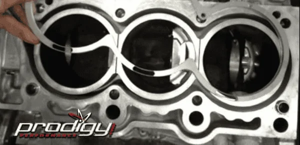

Is the closed deck the same as this?
Jeep Gladiator Building 3.6 with forged internals 1708126564579
I would maybe look at forged pistons, too...
