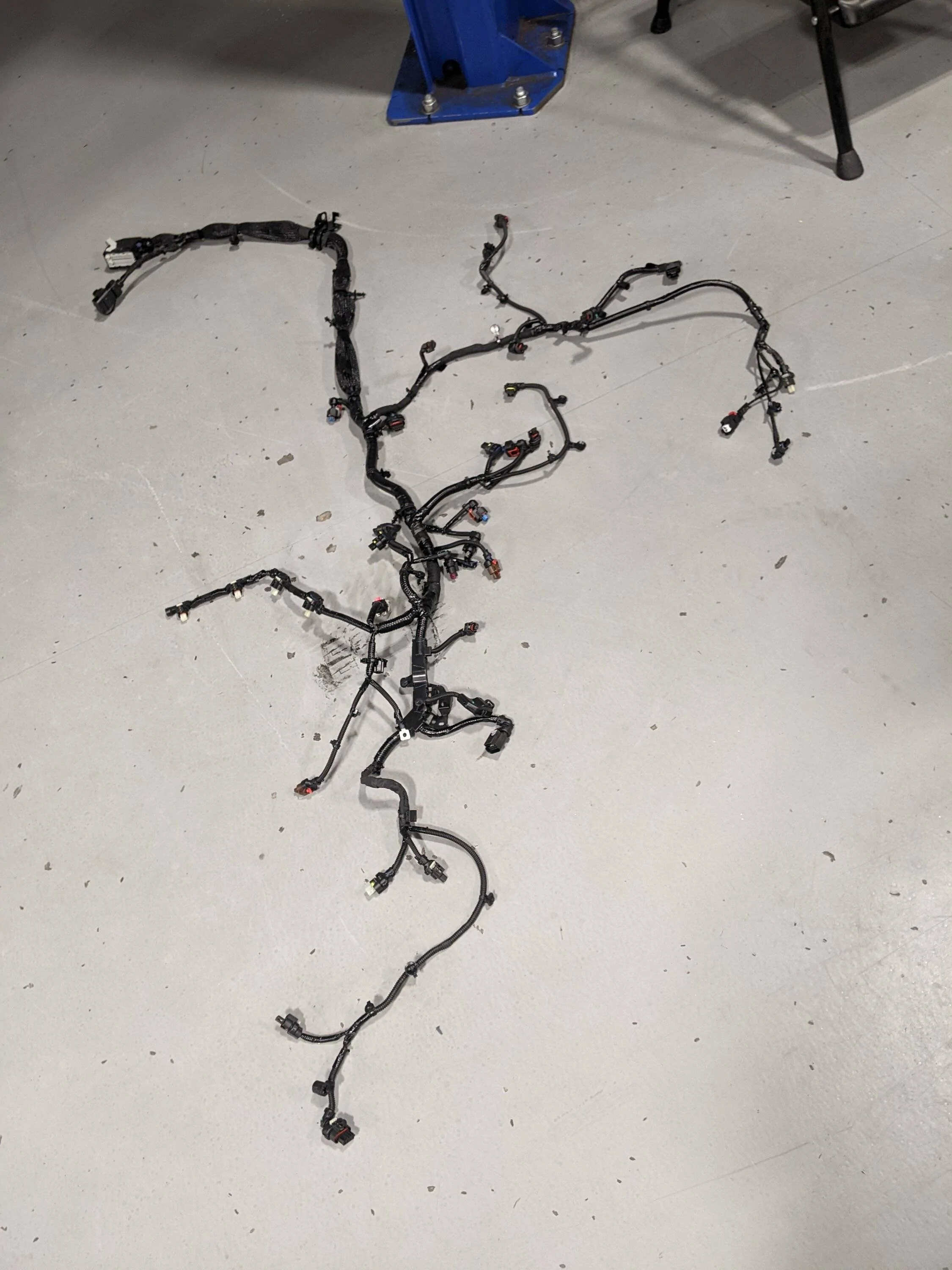

I have also found that sometimes, Jeep also sneaks in an extra circuit or two. I recently ran into this when doing an engine swap in a Wrangler. When I began connecting the harness, some circuits had changed pin out sequences. Also found that changing the pin positions in the connectors wasn't an option, because some additional circuits were present. My apprentice and I found that the best way to proceed was to swap the entire engine harness. With the engine installed, it took about five hours.
Jeep Gladiator Superchargers with GSPEC5 ECU??? PXL_20230803_114441420

That sounds exactly like what I read a while back. You brought back more detail to the memory. It's not a matter of simply swapping ends.
Thanks, you just added a piece to the puzzle I was trying to recall.
