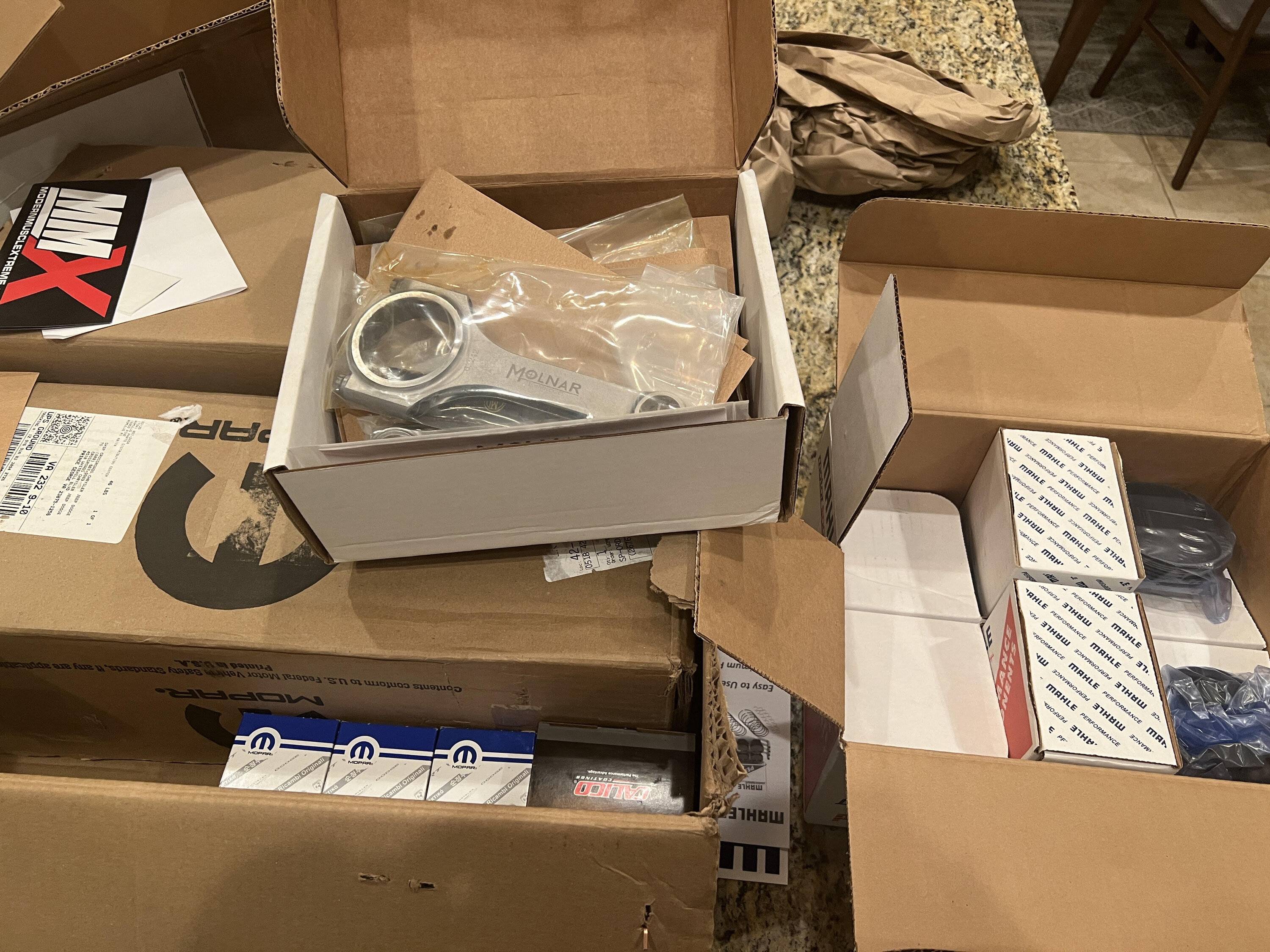

Since I have not seen any built 3.6L motors on a Jeep. I decided to build mine since I run Magnuson and want to try to get 450-500whp.
Jeep is in the shop now getting engine redone. I should have it back in the next 30-45 days.
Purchased from
https://www.modernmusclextreme.com/p-1713-36l-v6-pentastar-forged-piston-and-rod-kit.aspxAlso got a brand new balanced crankshaft w\ help of @DAVECS1 tune
Engine Buiders:
MJM Engines ( Mike )
Address: 222 N Vinewood St, Escondido, CA 92029
Phone: (760) 745-4104
