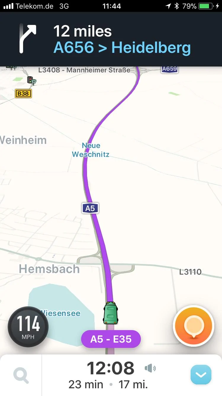

Thankfully I got the I wanna go fast out of me in Europe... A speeding ticket for 164 kph in my MJ...... some Autobahn's have speed limits!
I can kind of relate... The picture is a snapshot of the Mazda 6 I was driving, flat out in Germany. My coworker had a Focus that would run 135 mph... but getting passed when you are going 114 mph by cars that make you feel like you are standing still is rather impressive.
