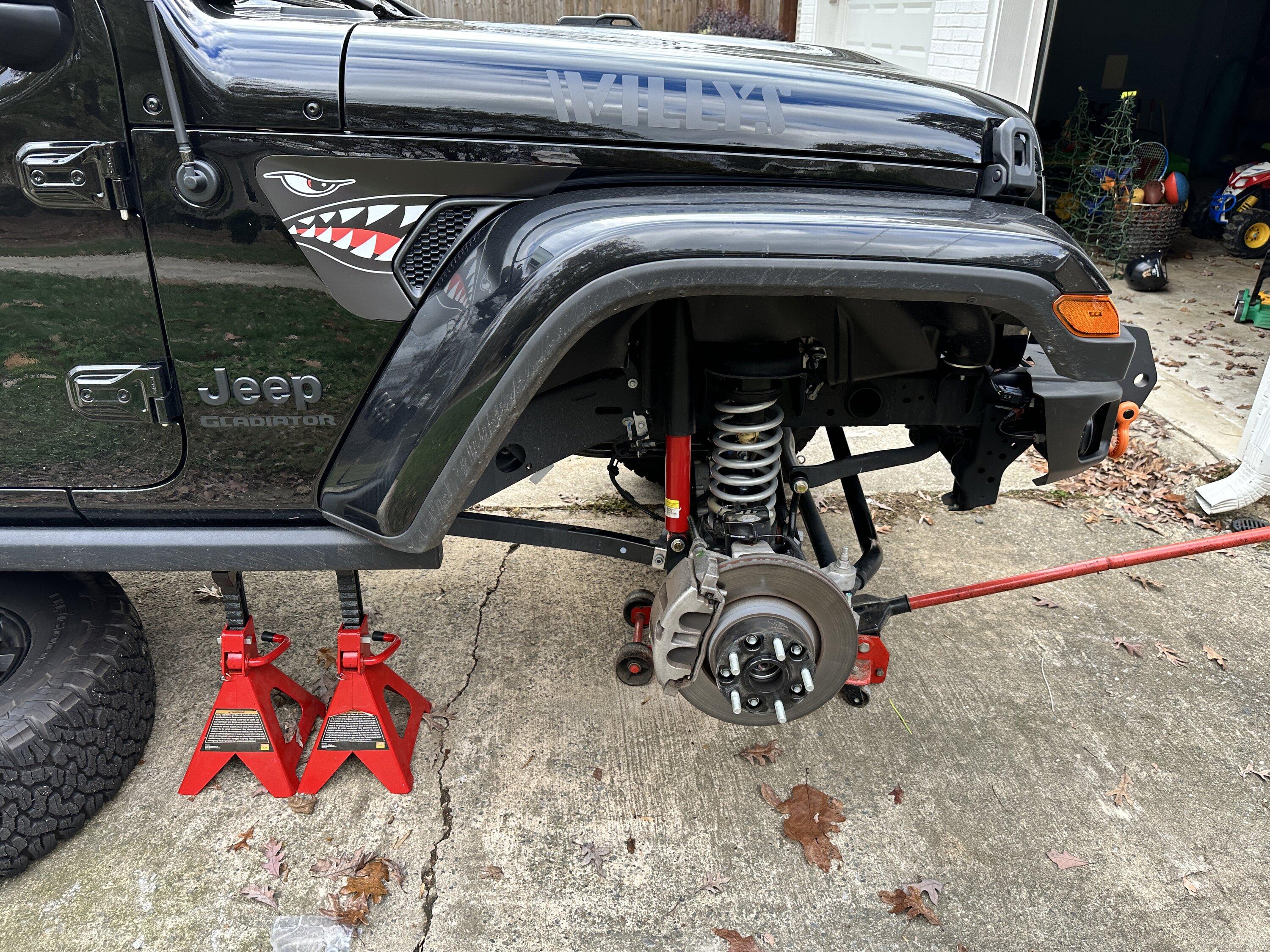

Jeep Gladiator Fox 2.0’s on Mojave? 20221112_195831917_iOS

I've read the whole thread, I can only guess it was your title haha that set some off or otherwise....
Rubicon takeoff shocks will work just fine, will just need small bushings and then the regular (non mojave) bolt in the bottom shock mount holes to be right. You just need to bring the shock mount hole down to the size of the normal shock bolt. That's your only hurdle. Your shop should be able to do that no problem. Others have upgraded to Mojave shocks do the same in reverse, they put a sleeve in the shock bottom hole itself.
