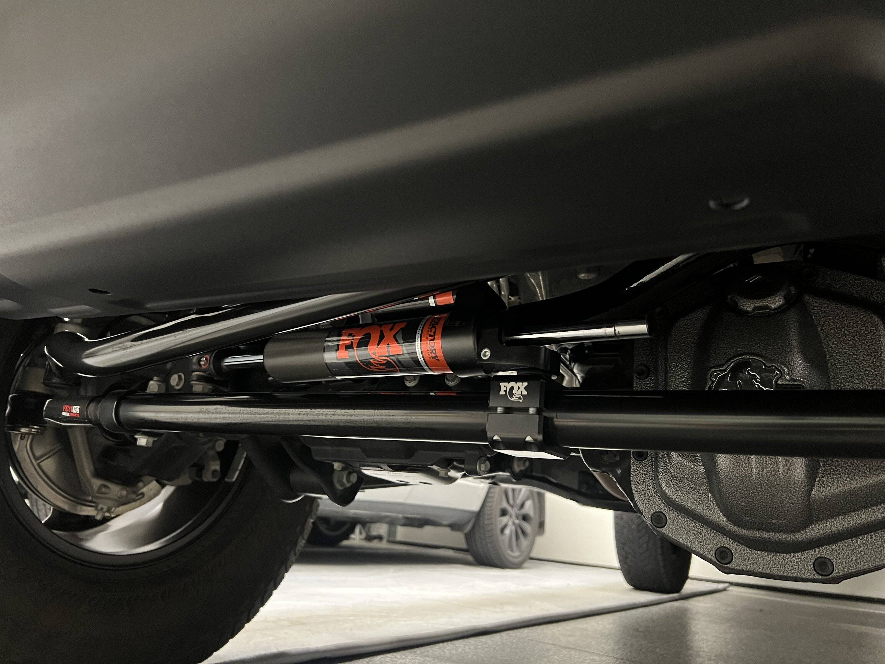

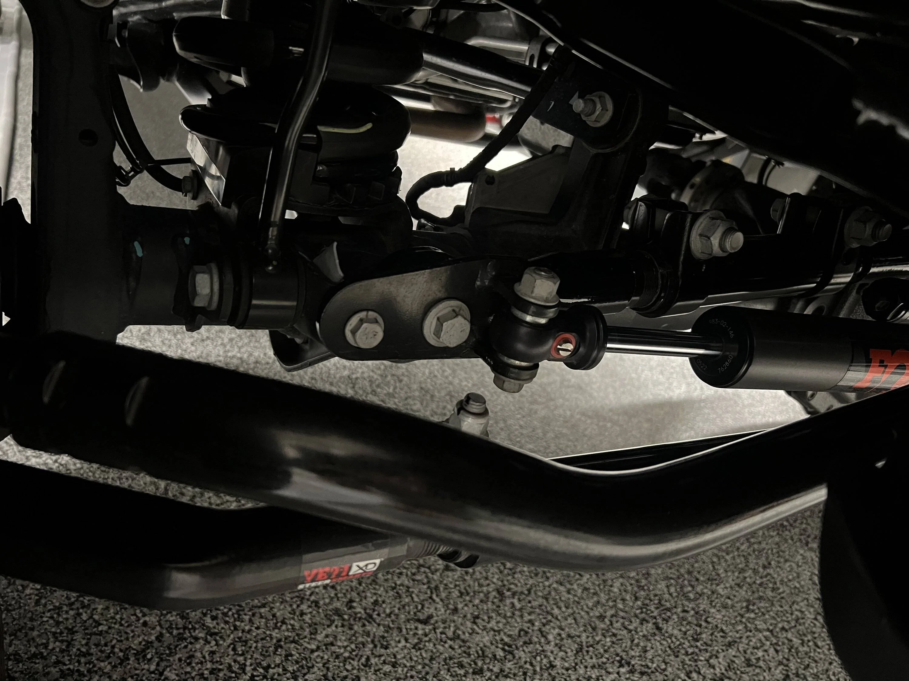

I’ve got the Mopar lift on my ā€˜22 Rubicon. I purchased the Steersmarts Yeti XD trackbar and tierod, along with the Fox ATS with high mount bracket, all from Northridge 4x4. It installed easily and I’m happy with the performance. I’m still running the factory draglink, mainly because I like how easy it is to adjust.

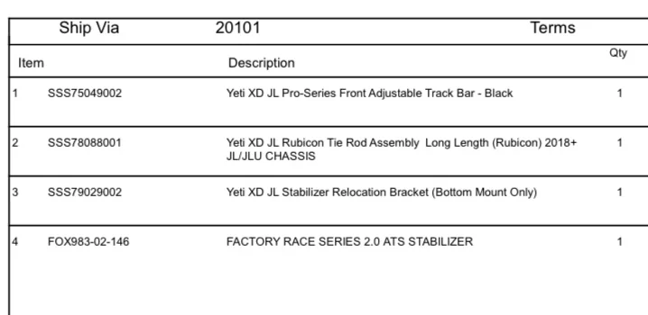

I just ordered the ATS 983-02-146 and the Yeti XD Relocation bracket from Northridge. I will give that a try and see if it works with the stock Tie Rod. I will probably do the Yeti Tie Rod and drag link in the near future. I have to see if I am going to lift it or not...

So I went ahead and just ordered all the Steer Smart front end components. Tie Rod, Track Bar, Drag Link, Sector Shaft Brace... I figured might as well just do it now...
