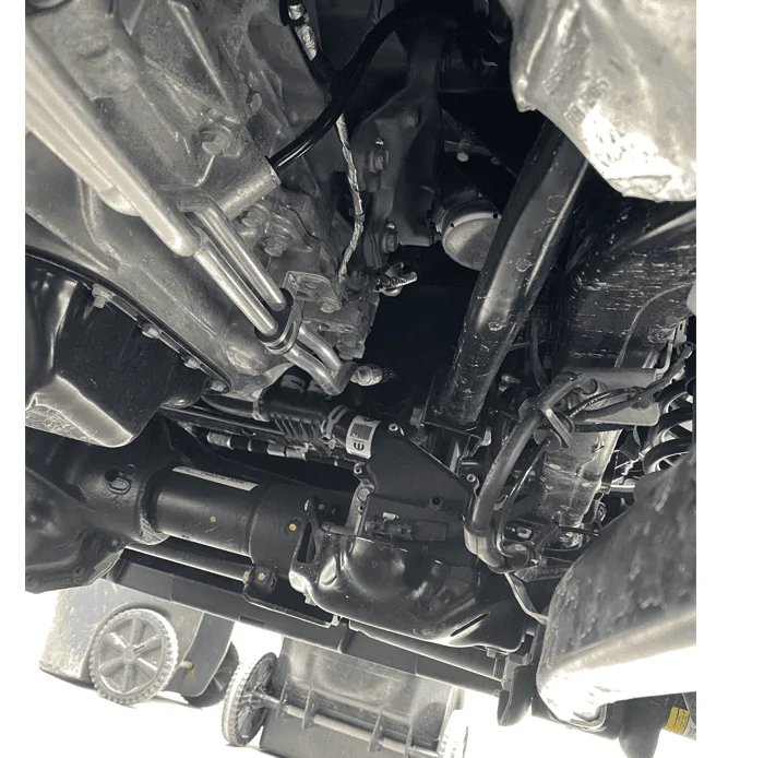

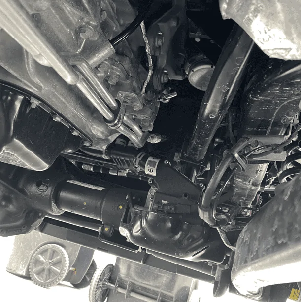

Very easy to determine if it has FAD or not - look at the right side axle tube. If it goes all the way from the differential housing out to the knuckle without a break, it's a no-FAD setup. In other words, if it's like the left or driver side, no FAD. If there's any sort of a box there with any wires, it's got FAD.
Now why would the Willys version not have FAD??
Jeep Gladiator Front Axle Disconnect. 1646256653616
Just got it back from the Dealer. Took this pic to show the axle. I'm guessing that is the FAD but ignorant when it comes to things other than changing oil, tires etc. I did take it for a spin and I thought I heard the noise twice. I could be imagining it though. On a positive note...normally it would make the humming/vibration noise 10 times per minutes.
Jamie
Mar 2, 2022
Michigan
Gladiator Willy 2021
na
Ask them what specific bushings they greased, and what specific cable & bracket they moved.
Chances are that the Service Manager is confusing FAD with sway bar disconnect.
The invoice says
Lubed exhaust hanger bushings and repositioned a cable bracket. No further noise. LOL
