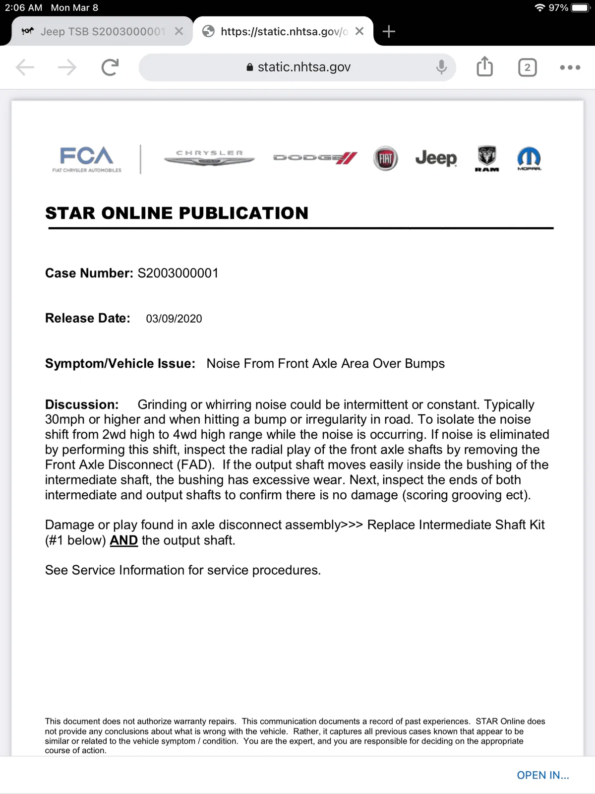

I’m having similar problems and have been to two different dealers... I’ve personally re-torqued every suspension bolt. I even had a third party, private mechanic look at this.
I had a JL before with zero issues. This is a really nice truck. But the front end noise has me ready to swear off FCA for good - this is total BS for a truck with 17k on it!
What is the TSB# for the FAD issue?

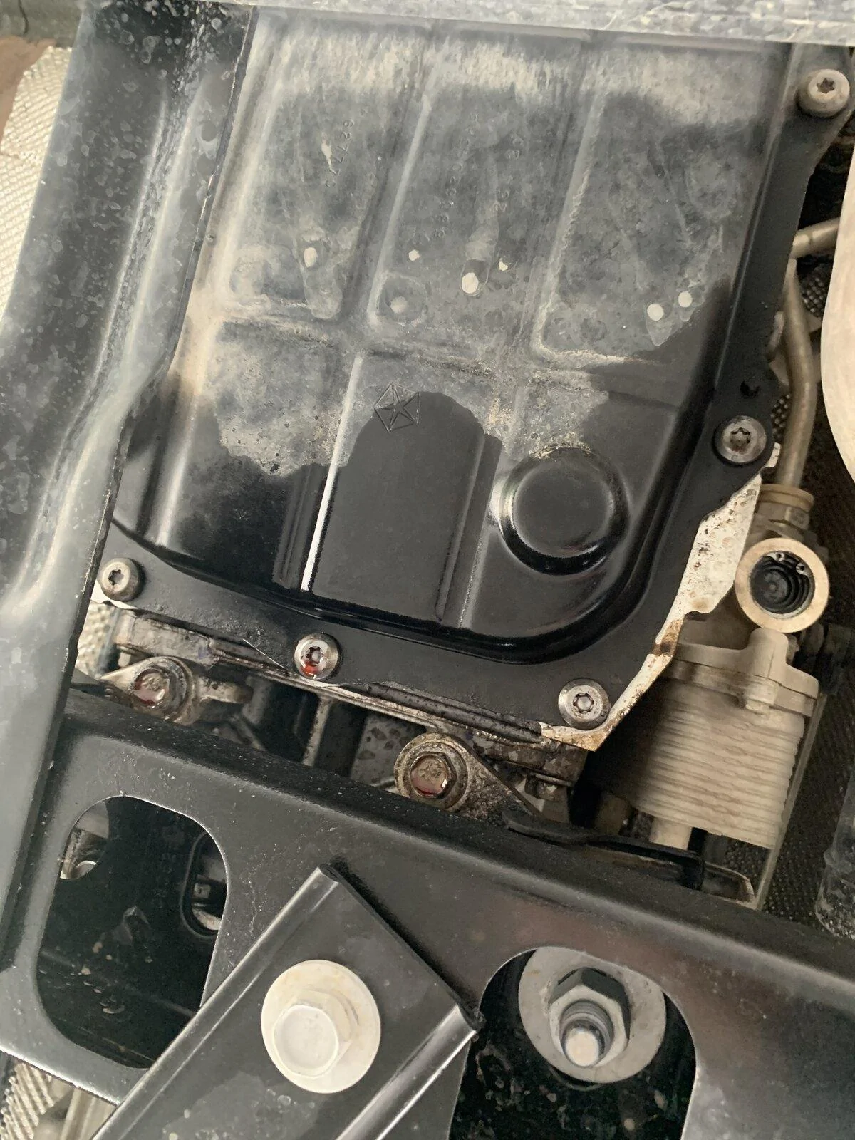

I just experienced this with my 2021 Rubi this past weekend. Will be going to the dealer tomorrow. Also found oil leaking as well...
Jeep Gladiator Front Axle Disconnect. 1615187358992

Taking my 21 Rubi in for an appointment on march 15th. Same issue. Sounds/feels like I am going over rumble strips. When I hit dips in the road, etc. Either sets it off or stops the noise for a bit until it starts/stops again. Less than 3500 miles on my Rubi. It got progressively worse since 3000 miles. At first I thought it was nothing because it was very infrequent, now its almost doing it nonstop. I know it should be covered under warranty but I'm still annoyed that a new over 50k vehicle is doing this. I guess I got one of the unlucky parts.

Mine is at 4200 miles. I dropped it off at the dealer today and waiting for updates. I might also have coolant leak. I got the unicorn?
