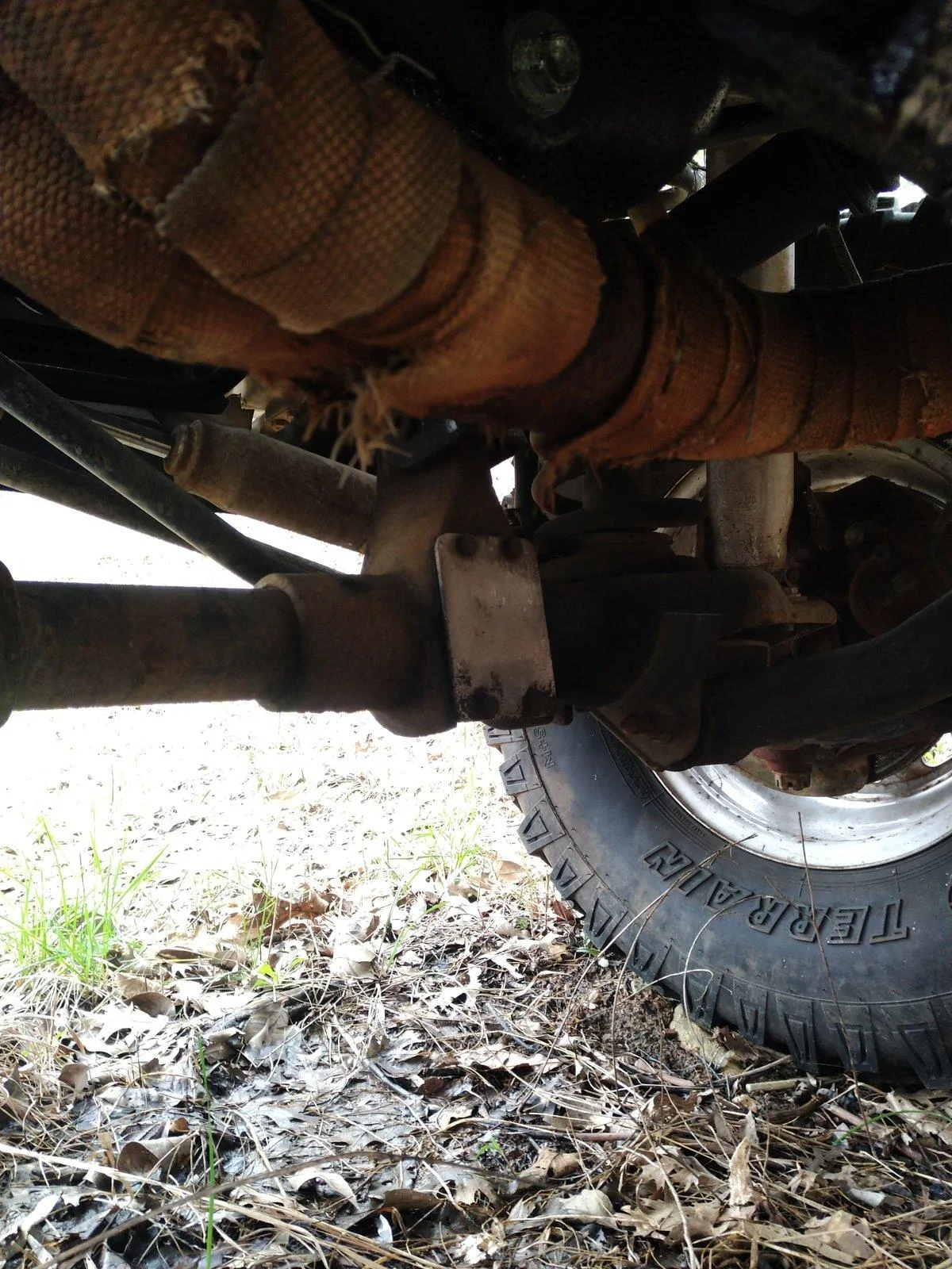

Why do I think the full fix will be this... The same fix for XJ, MJ and YJ. :giggle:
Jeep Gladiator Front Axle Disconnect. IMG_20200303_150340

Renegade. The one in photo isn't quite that it's a replacement 1 piece axle shaft.:like: Vacuum disconnect crapped out on trail. No more problem, might be the end result for this again:whatsgoingon::whatsgoingon:
