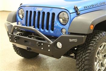

I've has a front reciever on my last 2 trucks, a traditional hitch bar as pictured in earlier post. I also already have a Warn winch with a cradle for it, and every truck was setup for power (for the winch) front and rear. Since i own a tree service, this setup was pretty valuable for me.
But my preference for the Gladiator is find a steel front bumper with a reciever built into it, not a hitch bar.
Similar to this but without the winch mount plate.
Jeep Gladiator Front hitch receiver RH-5009-2T
