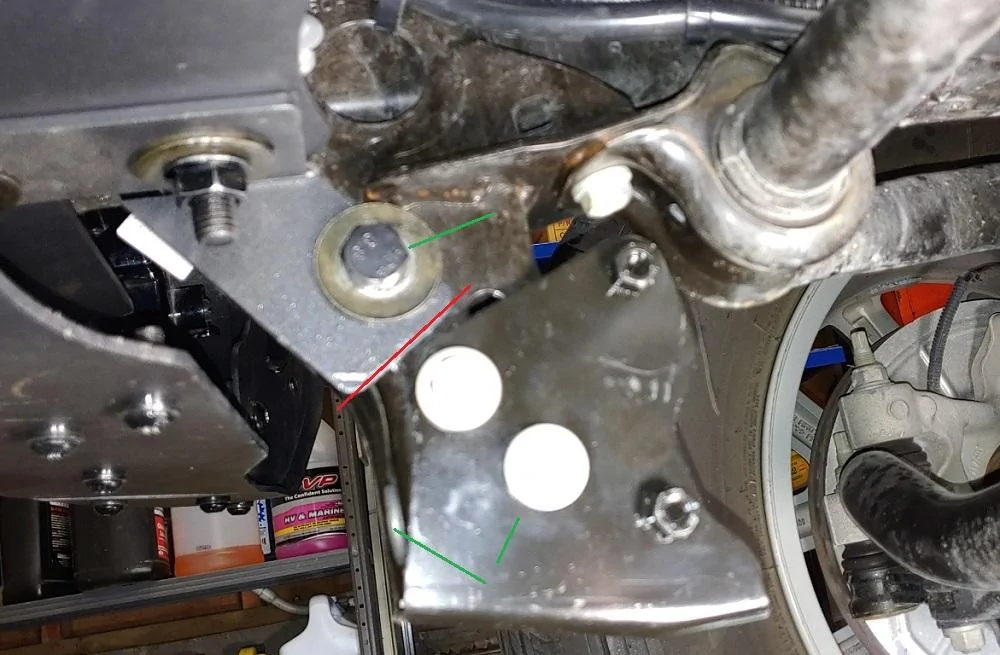

Thanks....I'm fine with the way it has come out so far....just want to get the rear of the skid plate bolted up dead nuts this weekend, assuming the dreaded coronavirus doesn't get me between now and then....:fingerscrossed: When I do so, I'll try to get some better shots, and measure up the cuts in the skid plate. It was definitely not a dremel job for the skid plate - sawzall with a hacksaw blade, as well as a stout drill bit for corner cuts. The skid plate is a hefty gauge steel.
Did you get a chance to post the pictures and measurements for the cuts?
Thx

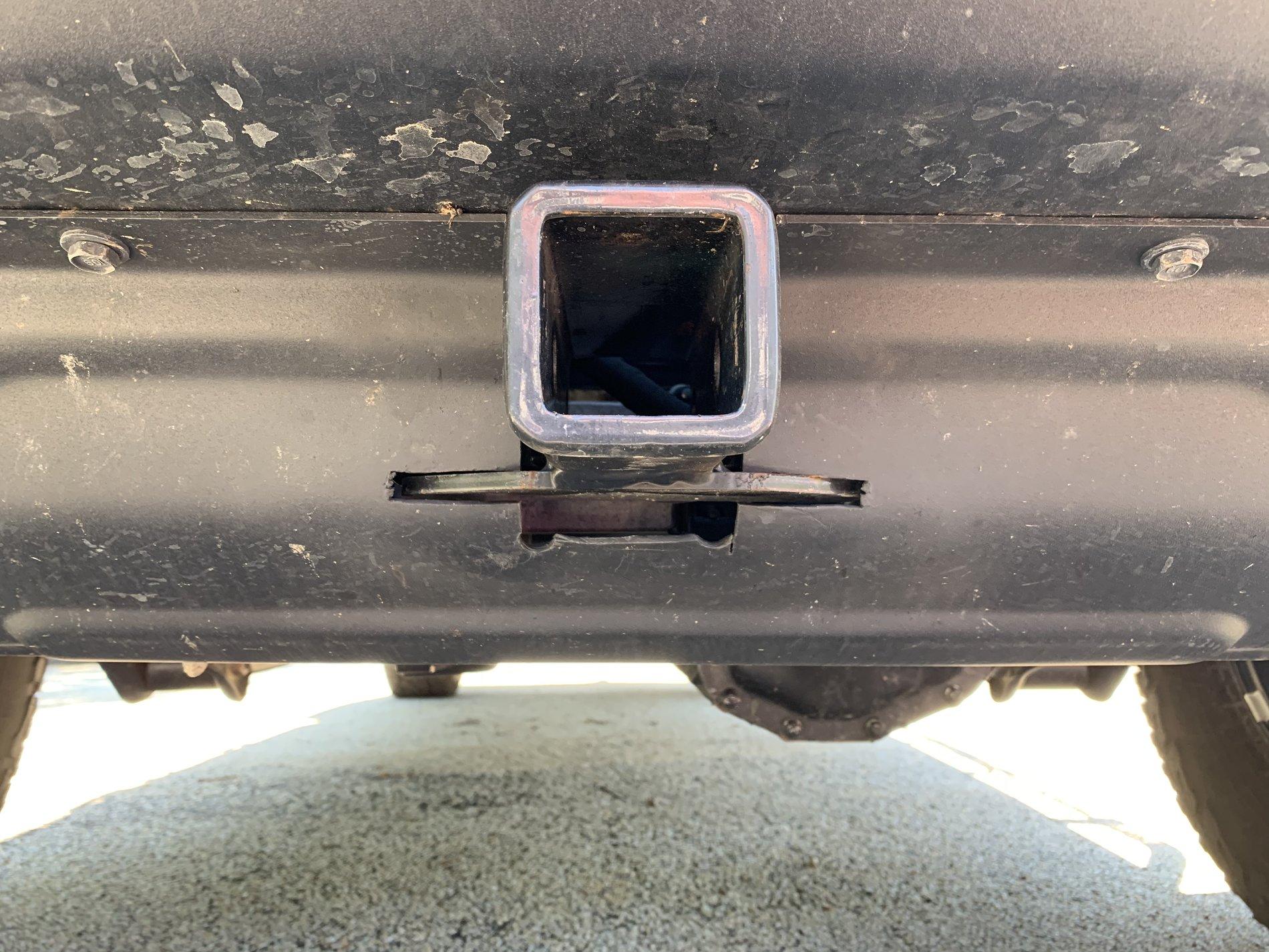

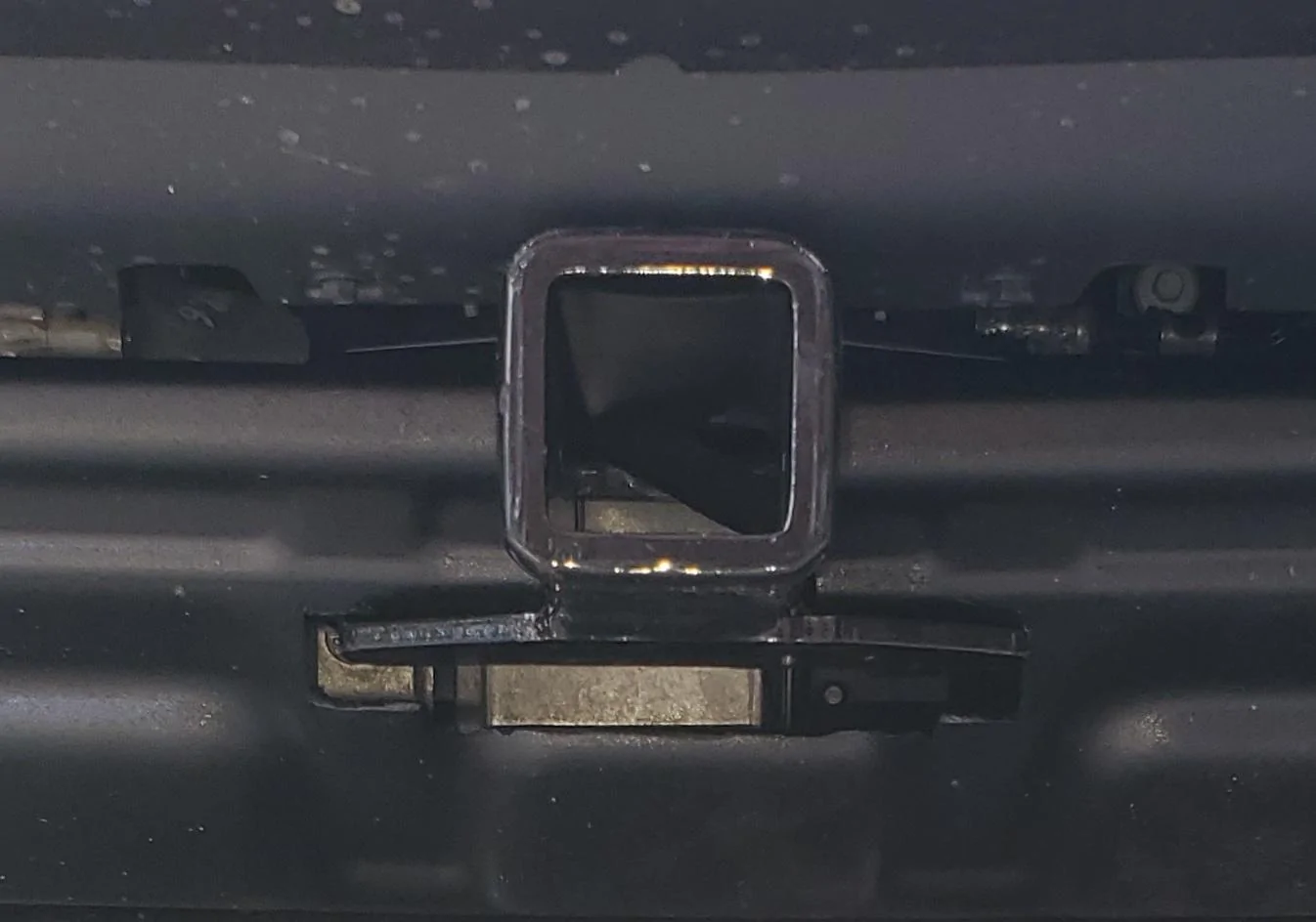

Sorry, no measurements, but here's a better pic. I just simply cut to fit - had the hitch mounted and just kept cutting until it fit in. Cut it clean from the top of the skid plate, and down low enough to clear the "T" portion of the hitch. Cut the slots for the "T" and it's done. Not too difficult, but it is a heavy gauge of steel, so a good cutting tool is necessary. I used my sawzall....

Thanks, I just jumped in and cut mine looks good on the top but the bottom is crap. I'm gonna glue some fuel line on to fill the gap.
I did cut the original rear skid mounts to match up with the reveiverqq. It left one bolt in the original, but it is still seems stronger than the add on rear mount tabs included with the receiver.
If anyone needs a set of the tabs I'm happy to give them away.

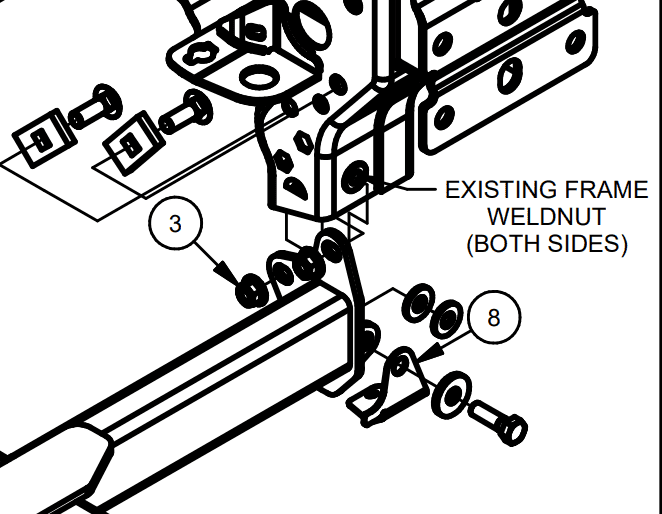

I've had my Draw-Tite front receiver on my Overland since last winter shortly after I got it.

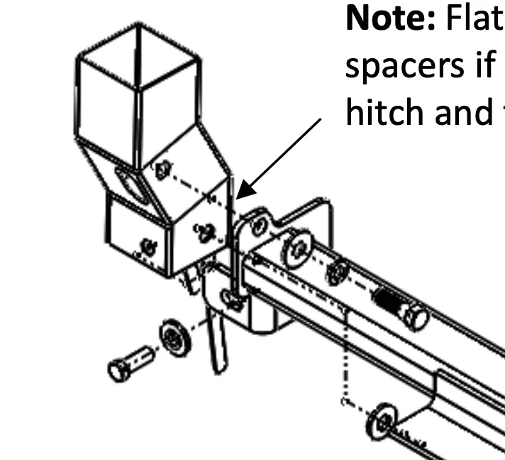

Worked great. Wasn't the best to install due to how they have the brackets and such, had to use washers as spacers between the frame horns and the receiver but it worked fine....... until today.
Now I really wish I had bought the Curt.
I found out the hard way that the Draw-Tite front receiver will NOT bolt up if you have the Rubicon steel bumper skid plate as those rear brackets are in the way of the receiver. There's not enough space to fit it in between the frame rails with those brackets on.
I can see why they furnished washers to use as spacers in some cases - if you have those nutserts in the frame and left the brackets for the skid plate off completely, the receiver would be a piece of cake as it woulde then bolt to one of those nutserts on each side, but still use one handle-nut on each side, but the washers as spacers would not be needed.
But - you can use either the skid plate brackets OR the receiver brackets, but not both.

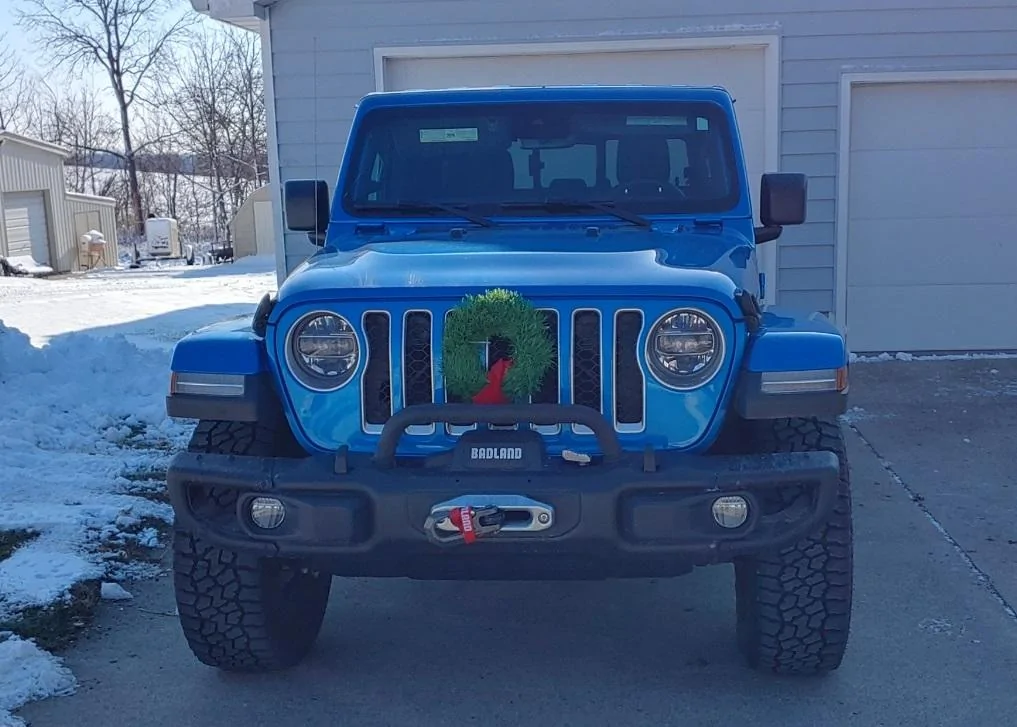

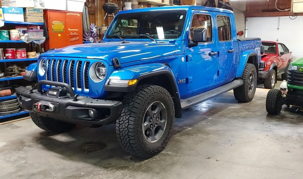

That doesn't look like the steel bumper?
The receiver does sit below the winch with a winch plate in the steel bumper. My winch plate attaches to the frame using the same top inside bolt hole shown in the Draw Tite installation instructions.

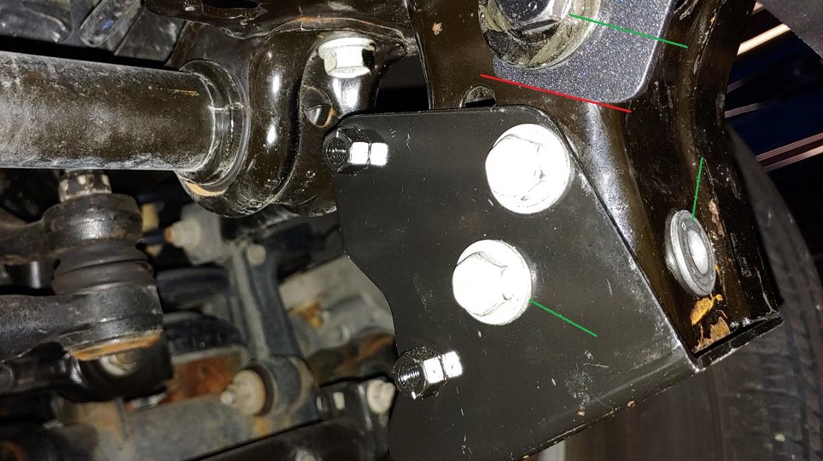

The lower inside hole is used by the bracket used to hold the skid plate that adds a nut facing downward in the middle of the frame member (2nd photo). Think that interference would be the same problem with any front receiver with the steel skid plate.

Looks like Curt uses the same nuts, so would be a problem there too, though they come with fasica brackets that may be able to work with the steel skid plate?

That pic is showing the receiver with the ORIGINAL bumper.
I now have this but left the receiver off because it won't fit between the frame rails with the skid plate brackets in place.........
The issue is not the winch plate, but is with the space between frame rails once you have the skid plate brackets in place.
The nuts you install into the frame to hold the skid plate brackets stick out some, plus the bracket thickness, there's not enough space between the frame rails any more.
If I remove the skid plate, remove the skid plate bolts and brackets, there's still not enough space because those nuts in the frame rails are tall enough - the receiver just fit between the frame rails as it was. Even 1/8" on each frame rail means it won't fit between any more - then add the thickness of those skid plate brackets, you are really done.
Yeah, basically same thing I was saying. Even just dropping the skid plate brackets, looked like it needed another 1/8-1/4" clearance with the inside bolts (mine is a Rubicon LE and came with steel bumper, so skid plate bracket nuts were there from factory). Think I updated my post with the Curt install instructions that show similar issue with the skid plate bracket, though it comes with a fascia bracket that may also be useable for the steel skid plate.
Regardless, if you have a winch/winch plate installed, may be easier to bolt an RV receiver to the winch plate rather than try to deal with all the interference issues of winch plate, skid plate, skid plate brackets, receiver, etc. If you mount it further aft you may need to notch the skid plate/bumper to get it all back together, or mount it a bit forward of the skid plate drop/line of bolts to avoid some cuts. After clamping it together and seeing how things look, I've opted not to put a front receiver on my setup regardless of drilling/cutting required. But that may be an option for someone like you with winch/steel bumper.
