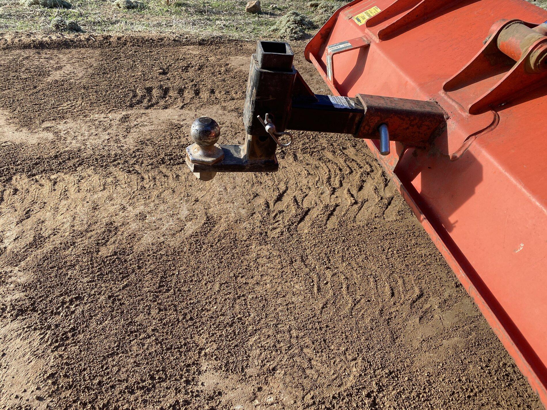

Agree with @ShadowsPapa. It depends on what you are trying to move or hold up there. I use my tractor to move my trailers around (welded receiver stock to the top of the bucket), so wouldn't use my JT for that. Tractor works great for most trailers, but my old toy hauler with ~800 lb tongue weight would tip the tractor if trailer was loaded nose heavy (but great test of trailer tongue weight!). If you start talking about uneven ground (i.e. boat ramp, sloped hill), it gets trickier even with lighter ~2000 lb trailers.

Use a riser/dropper receiver on your tractor? I have the opposite problem where I need to drop the ball when on the bucket because the bottom edge of the bucket is close too the ground for most of my trailers. Bucket does make it way easier to grab the tongue rather than dropping the trailer on the fixed height ball.

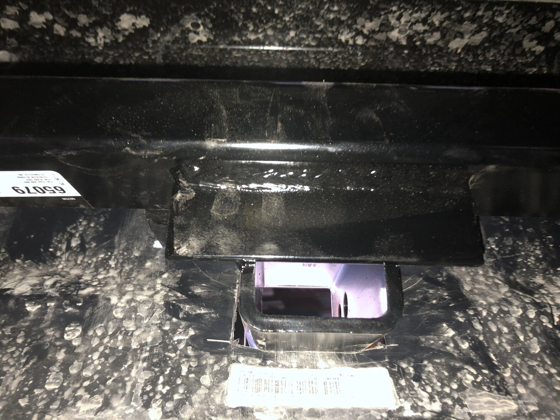

Doesn't help me - the Draw-Tite is the one that won't fit between the frame rails with those nuts in the frame - and even worse with the skid plate brackets.
I have the draw-tite receiver.
In my case, it's a matter of those fancy frame nuts PLUS the thickness of the skid plate brackets. The receiver tube just fits between the frame rails as it is, add those nuts and you'd have to spread the frame a bit - add the brackets, forget it.
The trouble in my case is that the receiver tubes are designed to go between the frame rails of a Jeep with no skid plate - and without those Mopar frame nuts.

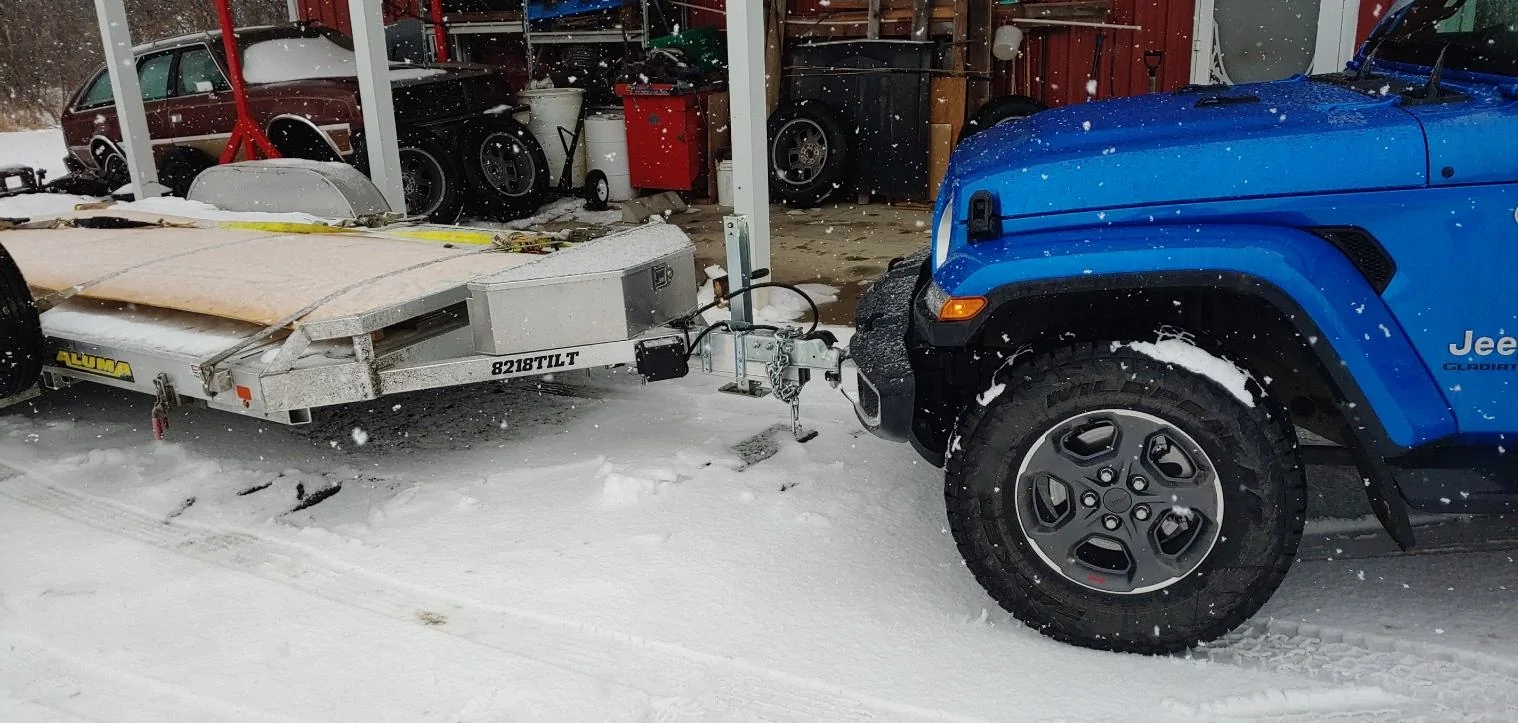

I guess that answered it for me. I had a hard time deciding between the Rockhard bumper or just getting the Curt front receiver (keeping and cutting up the plastic bumper).
Planning to move trailers around and getting a hitch cradle for a winch so I have more flexibility in use.
Curt it is then! And keeping more precious payload capacity for my Overland is certainly a bonus. :clap::clap:
249
40,553
54,194

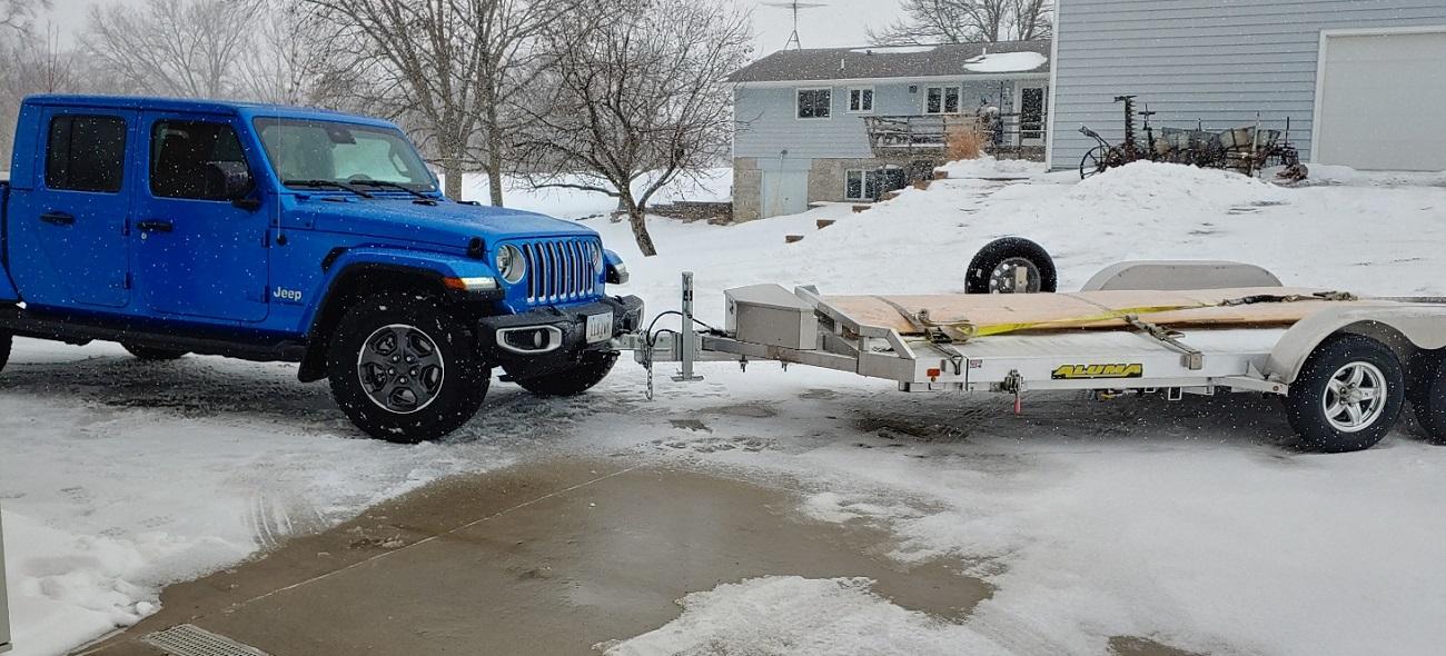

NIce aluminum trailer.
Thanks -
and the reason I have it is rather funny, really. I had a decent car hauler but the angle and channel iron ramps were back killers and my wife knew it. But then, I didn't haul that often so I got by with her help. Then it was time to decide on WHICH Gladiator - she wanted body color fenders and roof, and certain other things. I wanted the max tow and sort of accepted I'd have to settle for not having certain other things. The 8.2 was a must-have, and with my wife, power windows and locks are a must due to her handicap.
So we're talking to the sales guy and he points out all the stuff she can't have if I get the max tow Sport S. She decides we must have the Overland because of certain features and options. The sales guy and I explain the differences in towing capability...... and I explain how my current trailer was something like 2200 pounds - empty...... with a car I was pushing what I considered my "safe zone" for towing (staying a certain amount under the rated max)
So she pipes up - "So just go buy a new lighter trailer"
OK, I told the sales guy - you heard her - I'll be going out and buying a new trailer.
Aluma - tilt bed gets rid of ramps - pull pins, walk down the bed and it tilts, drive car onto trailer until the bed starts to move back down (it moves slowly as it's dampened hydraulically) and that's pretty much were you want to strap the car on. People say it's well situated when the bed lowers back down.
ALL aluminum except axles, jack and the hitch itself. Frame - 100% aluminum, aluminum wheels.
Empty without tool box and spare it's 1500 pounds. I shaved over 500 pounds off the trailer weight alone. The tire carrier is all aluminum, the tool box empty I could pick up with one hand so it's got to be light. I figure with the accessories it's still only about 1600 pounds.
I took it to Omaha to get a couple of AMC dealership signs a friend had and was holding for me -that's what's on the trailer in the pics. They are rare, hard to find signs. Will likely have them restored and put on my shop.
My shop is at the far east side of our property, almost against the property line. I use the neighbor's drive to get to my shop (his shop is back there, too). His drive is narrow, far from straight and on quite a hill. When I get back there, there's limited space to turn around (can't do it with a full-sized truck) and then I have to make a tight turn and get it parked between my shop and the next property. I have to miss his trailer and block walls in the process. So it's not something you do with a big truck and a rear hitch. I have to pull it down to the front of my shop, unhitch, and either use a front hitch or my lawn tractor. It's some stress on the hitch with the sharp turns and inclines in the area.
I'm in trouble if he dies or sells or whatever so I'm going to chat with him about some sort of "easement" and share deal on that driveway so if anyone else buys their place I'll still have driveway access. I'd even pay to maintain it if that's what it took.

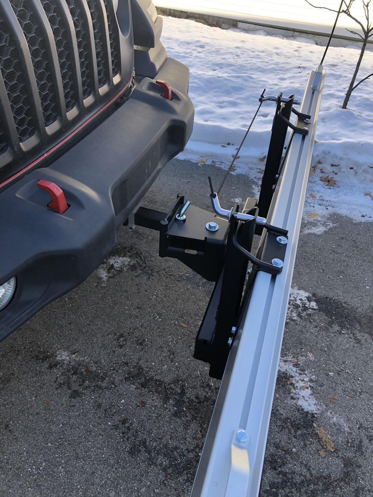

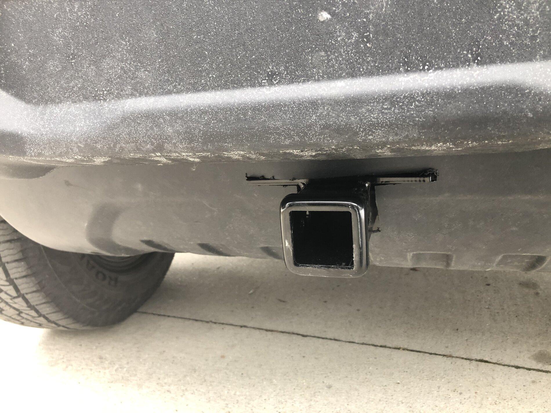

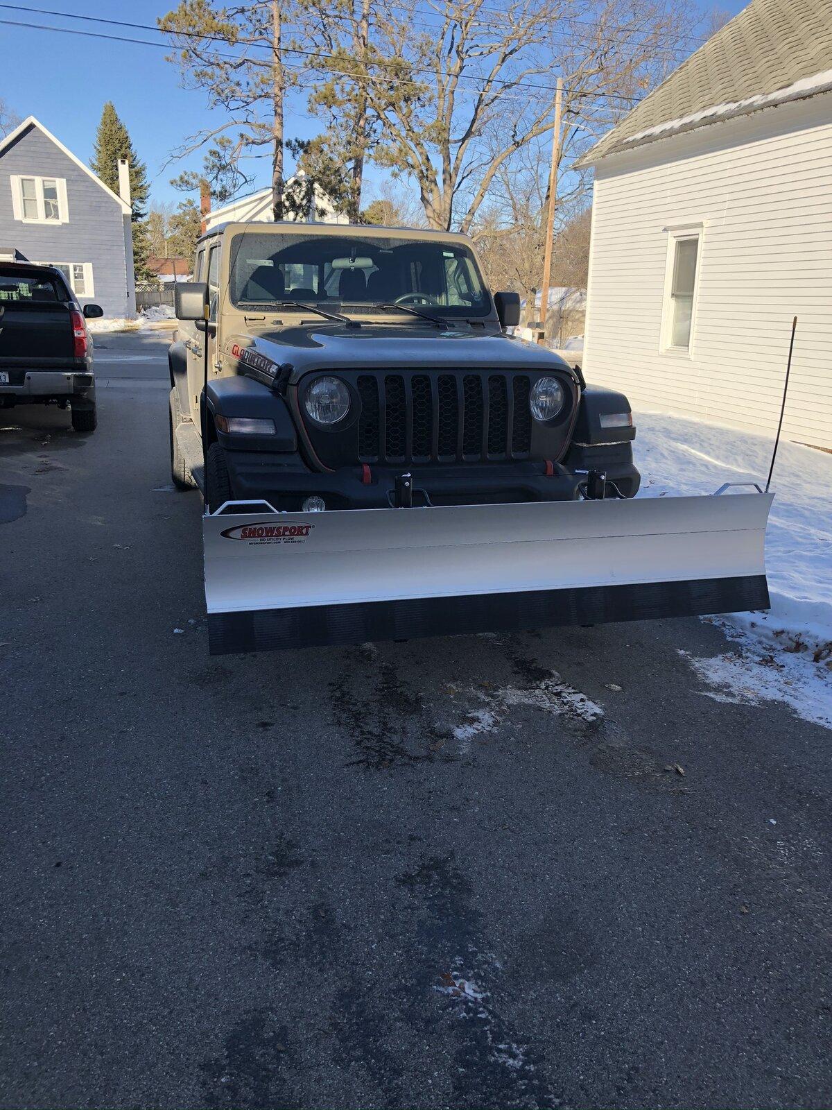

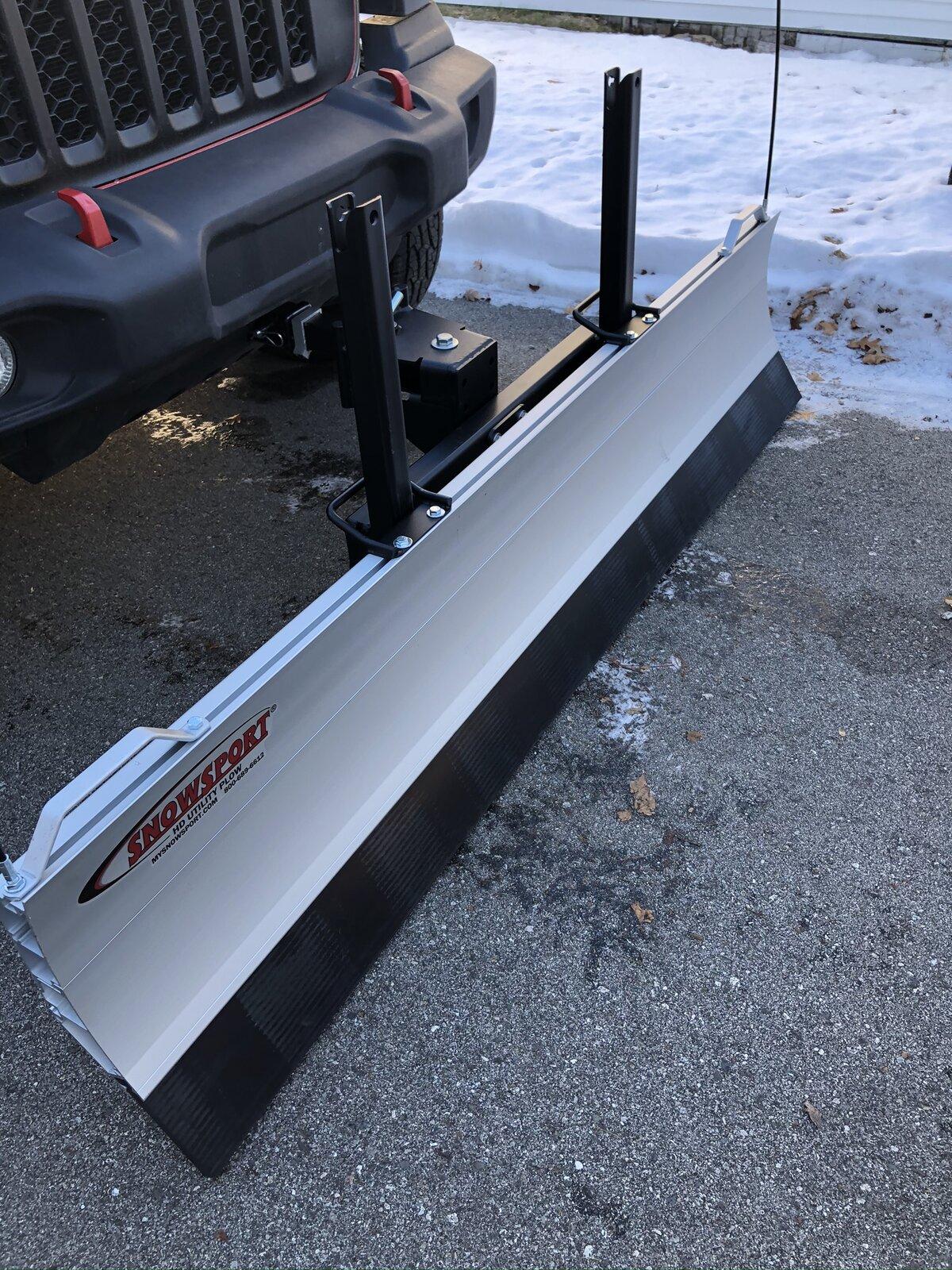

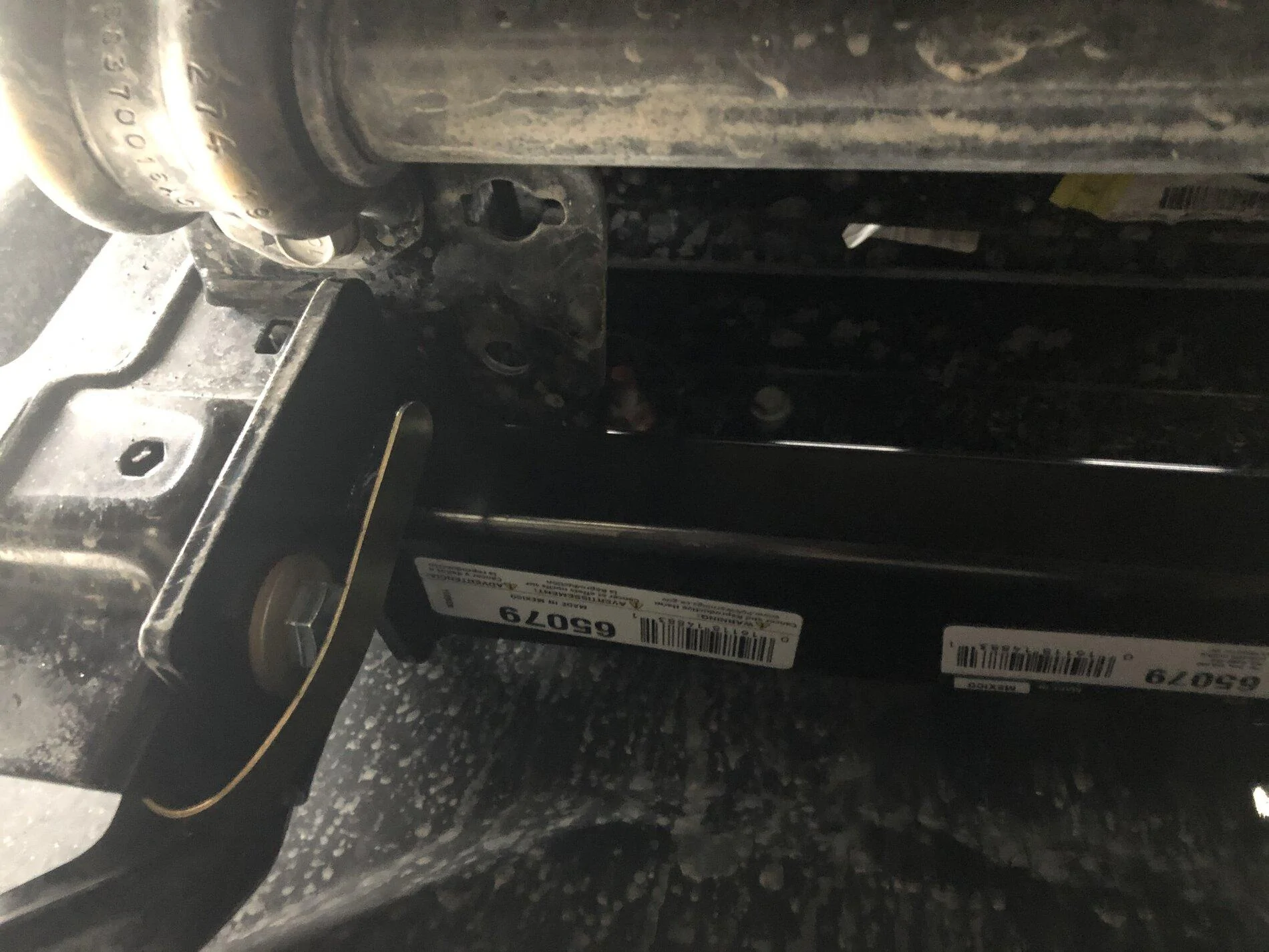

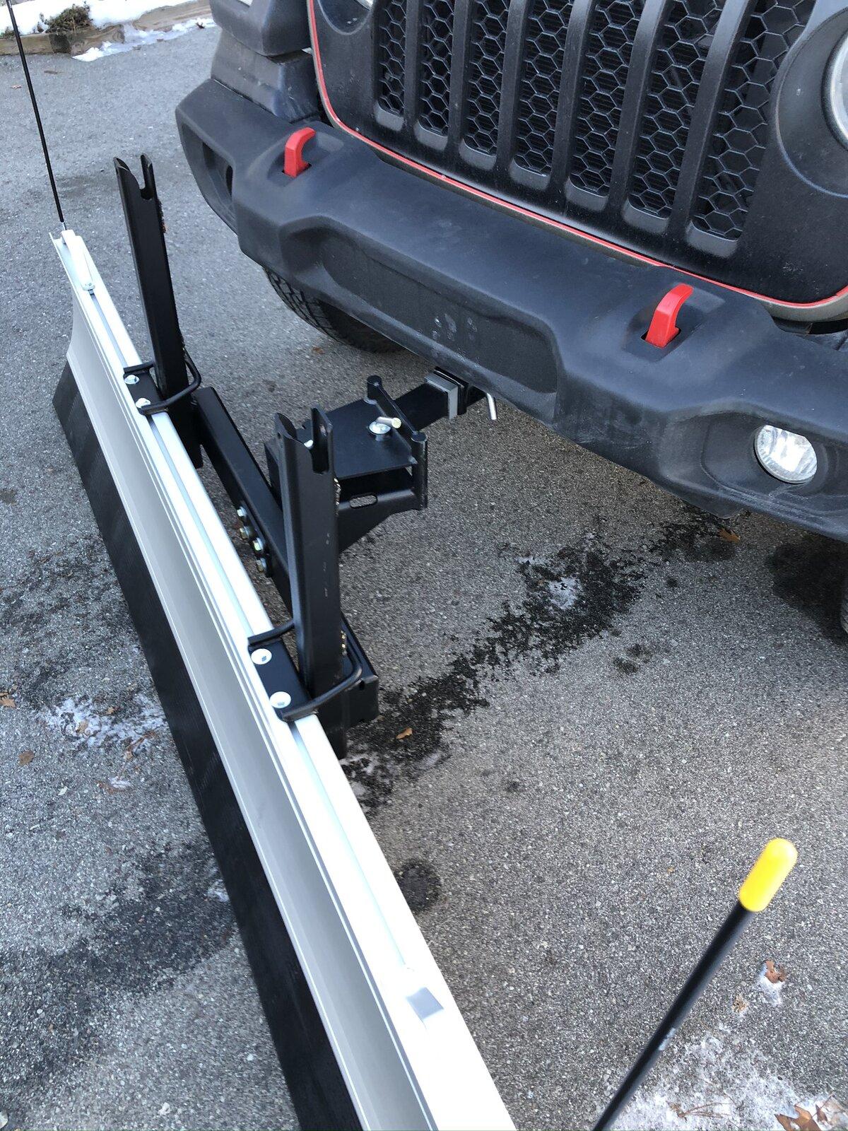

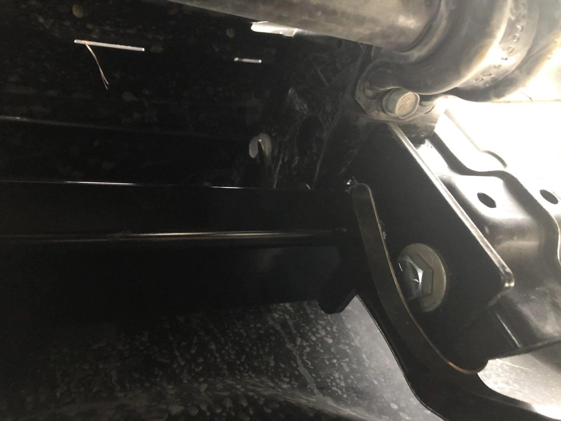

This is the SnowSport Gladiator Kit for my Sport. Came with Draw-Tite 65079 mount and 45 minutes to install To the truck. Minor plastic air dam modification. This is a manual floating plow with no power or hydraulics. It is winch capable but for me it’s so easy to use without it and I’m disabled/retired. $1800 complete with taxes and shipping. Does offer a winch option.
