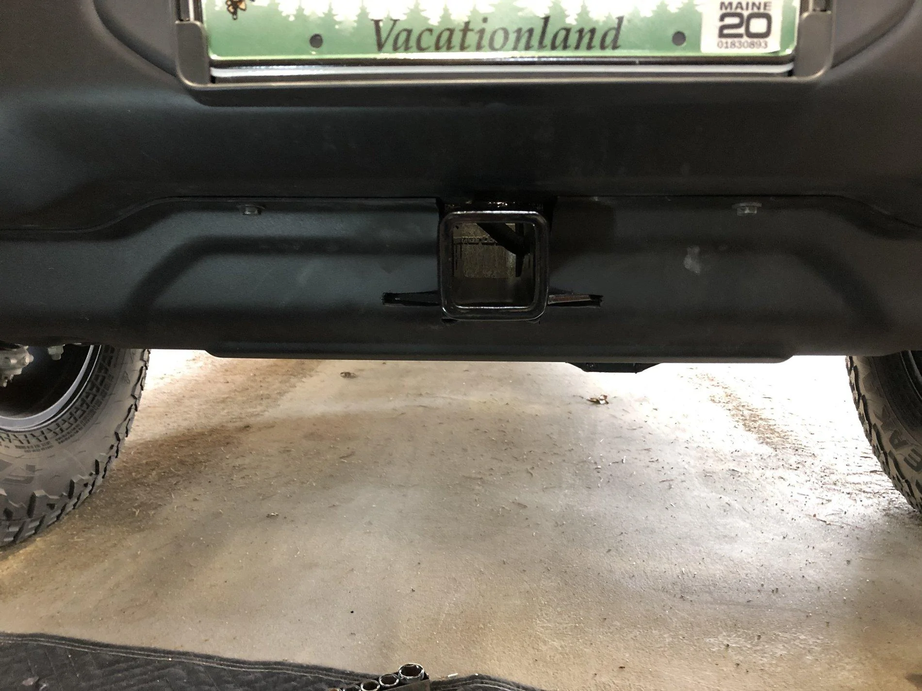

Dredging up an old thread to report that it is certainly possible to fit a Curt 31086 front mount hitch receiver on to a JTR. It is not simple, but not overly difficult either. The plates for the rear skid plate mounting hardware need to be removed, as they consume real estate that the body of the hitch needs. In place of them, I have the funky little brackets Curt supplies installed, but I did not bolt the skid plate to them yet. They are merely supplying a touch point for the skid plate. I did have to cut out a substantial "t" shaped section of the skid plate to accommodate the hitch receiver tube. I cut it very close because the flat plate of the hitch provides an additional perch for the skid plate. As of now, the only hardware holding the skid plate on are four of the five original blots along the front edge. As is, it seems and feels really solid, but I will probably add some hardware to tie the rear of the skid plate to Curt's brackets - seems doable, just ran out of time. Also - I have the FCA steel bumper, and there was a bit of interference between the hitch and a couple of tabs on the bumber - ground them down with a dremel to gain clearance.
And - the hitch sits directly in front of the FAD. If that is really all the skip plate is protecting then the skid plate is not really necessary. I spent the time to get it fitted up because I think it also provides a bit of weather protection for the engine bay, which I like given the ridiculous amount of salt products that get thrown around the roads in maine in the winter.
I know - lousy pic, but it's the only one I took at the time.
Looks like you did an exceptional job! I hope you have some details of your installation you can share. Were you able to cut the skid plate with just a dremel? Was it difficult to locate the cuts for the best fit?

Thanks....I'm fine with the way it has come out so far....just want to get the rear of the skid plate bolted up dead nuts this weekend, assuming the dreaded coronavirus doesn't get me between now and then....:fingerscrossed: When I do so, I'll try to get some better shots, and measure up the cuts in the skid plate. It was definitely not a dremel job for the skid plate - sawzall with a hacksaw blade, as well as a stout drill bit for corner cuts. The skid plate is a hefty gauge steel.

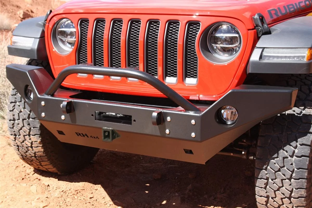

I noticed on their site that Rock Hard 4x4 now has front bumpers with built in front receiver and flat towing capabilities (in full and mid-width bumpers with winch)
Jeep Gladiator Front hitch receiver RH-90212-2T

Love that bumper with the flat tow ability (the reason I switched to Jeeps vs Toyota) plus the front hitch versatility as well. Thanks for the info.

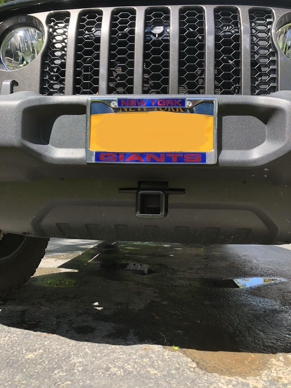

I went with the drawtite
no complaints . Tried to eyeball cut. Used a sawzall .
little off on one side 1/8 “

I've been eyeing the Curt for a while. What's putting me on the fence is whether it will work with a steel bumper if I plan to upgrade in the future. Don't want to cut through metal or lose a skid plate like with the Rubi steel bumper setup.
The RH mid-width could solve that as a 2-in-1 solution. I'm liking the integrated Hi-Lift recovery points and lowered winch plate too. Man this is bad news... : P
