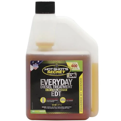

I run 2oz of hotshots edt. In every tank. It’s just north of the premium dose per the bottle. Did the same in my diesel zr2

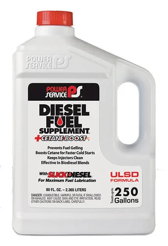

Agreed above 2 Oz Hotshots per fill up for lubrications (easy measure and pour) and I think I will be switching to the Power Service for the winter.
Jeep is not really allowed to make additives mandatory but every fuel pump manufacture recommends it so that was my selling point. Not even $1 / tank so it is really small cost for some piece of mind.
Jeep Gladiator Fuel Additives HotShotEDT_1800x1800CMYK
Jeep Gladiator Fuel Additives 261-6593
