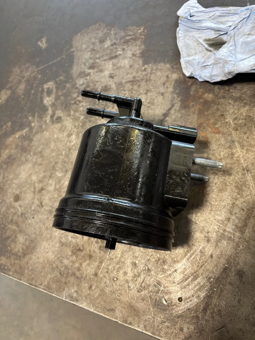

Pulled the whole thing out and couldn’t see anything but I figured it was something to do with the electrical connector.
Jeep Gladiator Fuel filter housing leaking IMG_0149

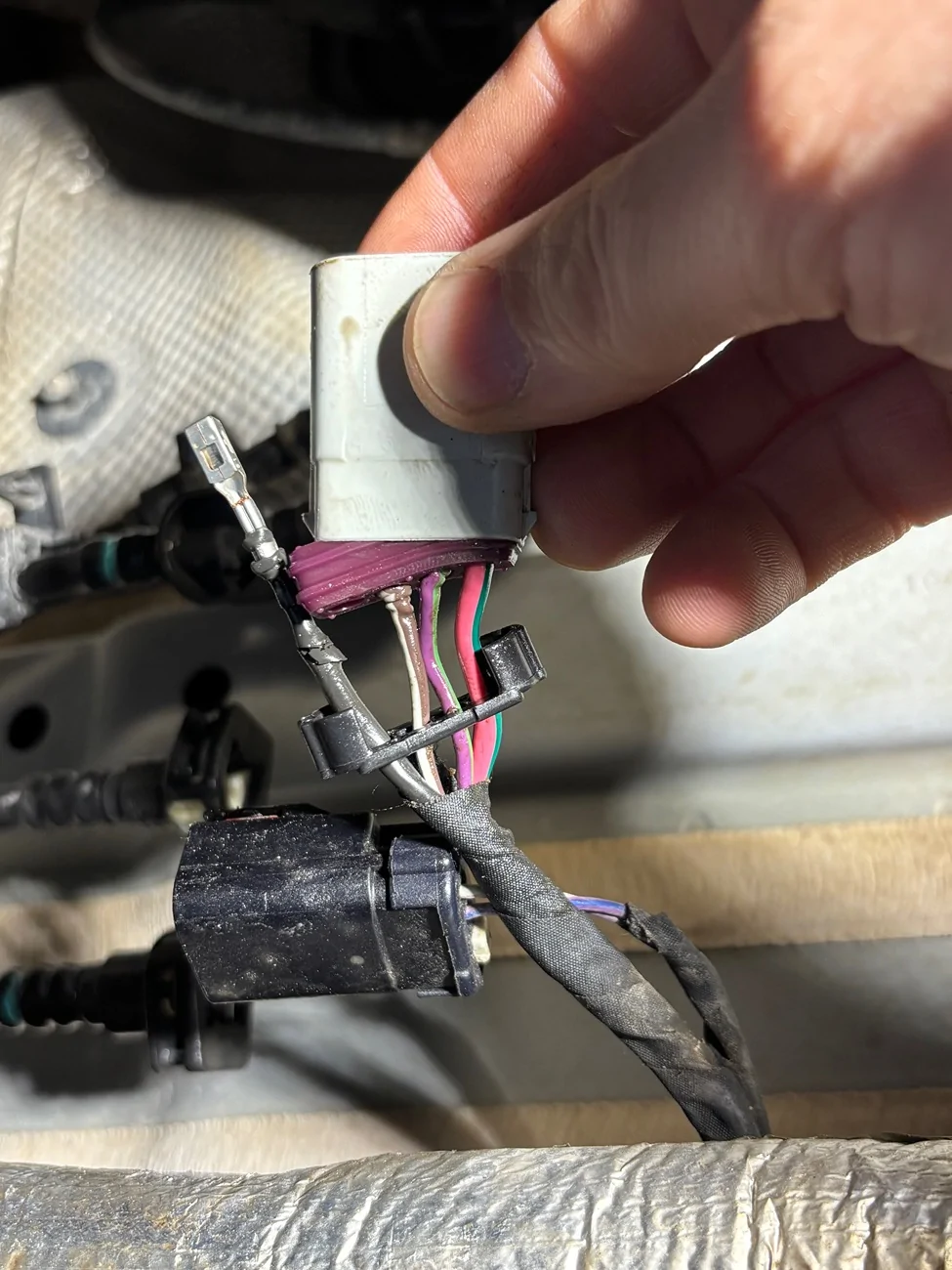

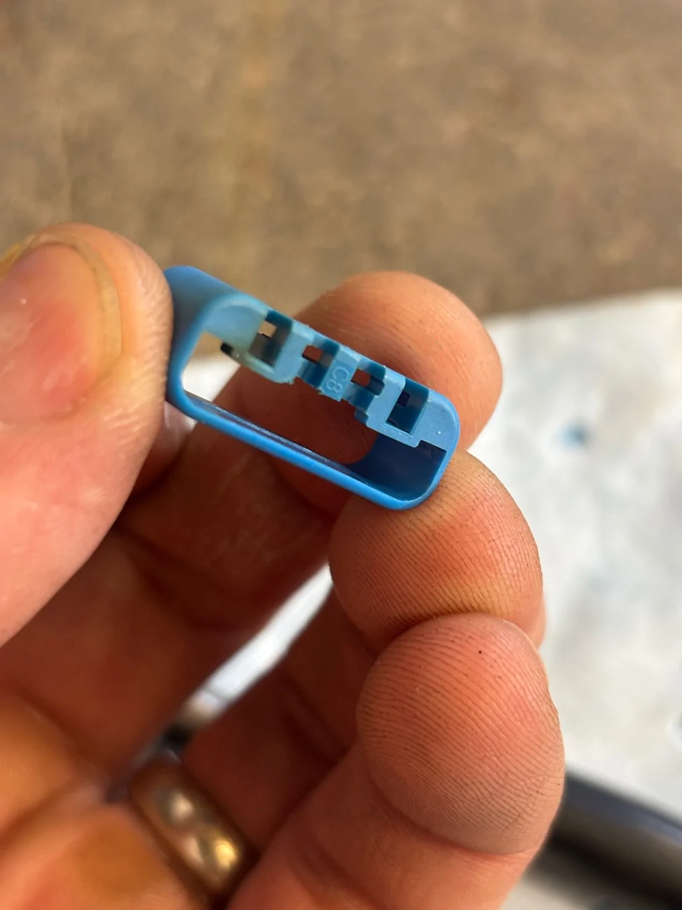

You can see the insulation on the wires is pooched. So diesel has been leaking through the connector. The more I looked at it it’s the bigger ground wire for the heater. It looks like it got hot for some reason and has actually made the housing brittle. I looked a little closer inside…..

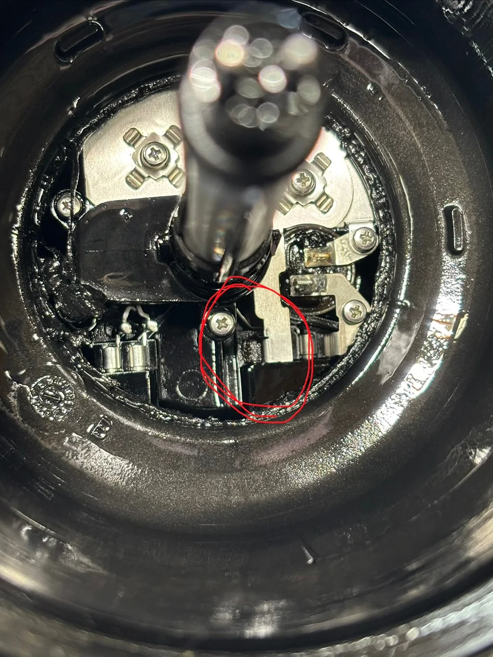

Jeep Gladiator Fuel filter housing leaking IMG_0147
Circled in red is where that pin comes through and the plastic is broken away and it’s very brittle! I poked it and shouldn’t have!!

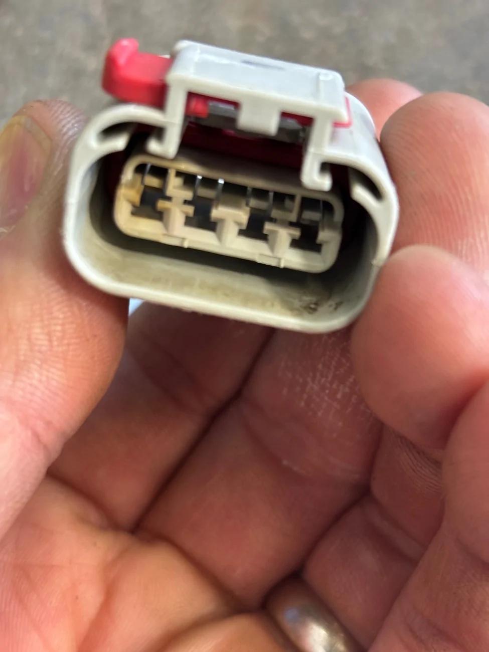

Here’s the plug. You can see the brown on it. I looked at each pin and to me it looked like the ground pin was not crimping down very well on the male pin coming out of the housing. Which would explain why it got hot with the current going through it.
Jeep Gladiator Fuel filter housing leaking IMG_0152
Jeep Gladiator Fuel filter housing leaking IMG_0153
So after all that I had to get it running again. I jammed a pile of rtv in the plug, crimped the ground wire better and put it all back together temporarily till my new housing comes in.

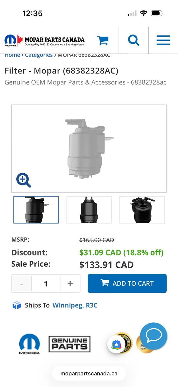

New filter housing part number is…
Jeep Gladiator Fuel filter housing leaking IMG_0148
Should be here in a few days.
