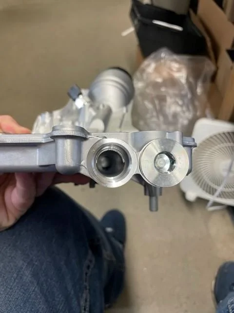

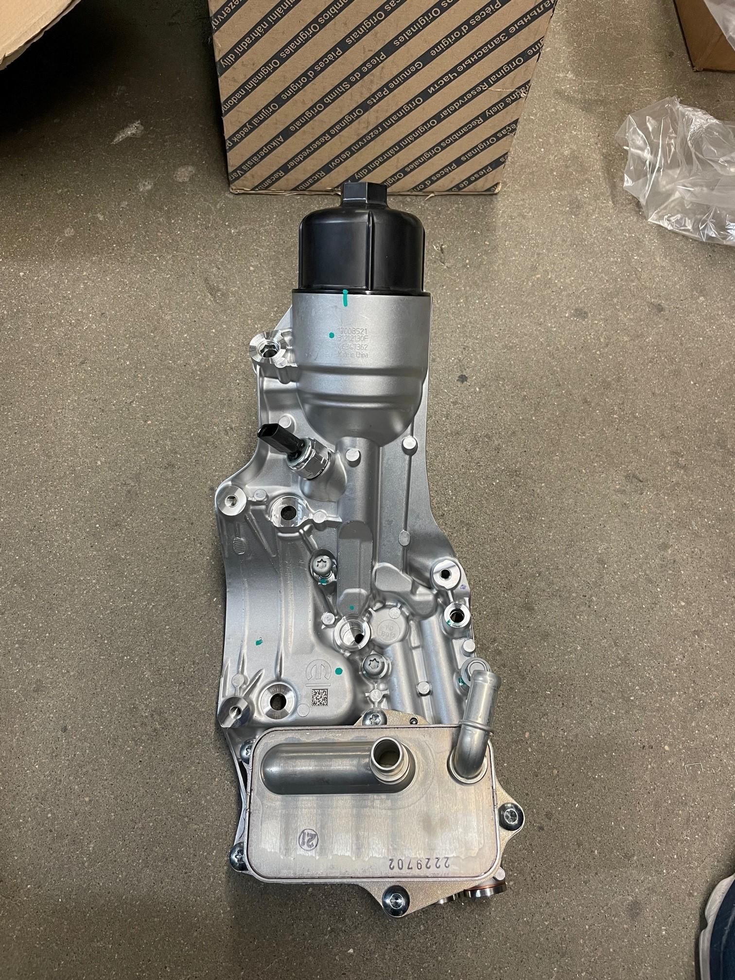

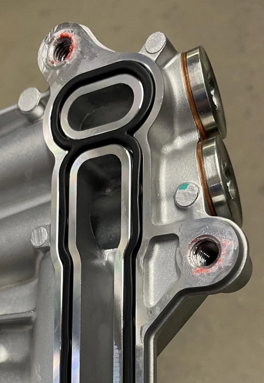

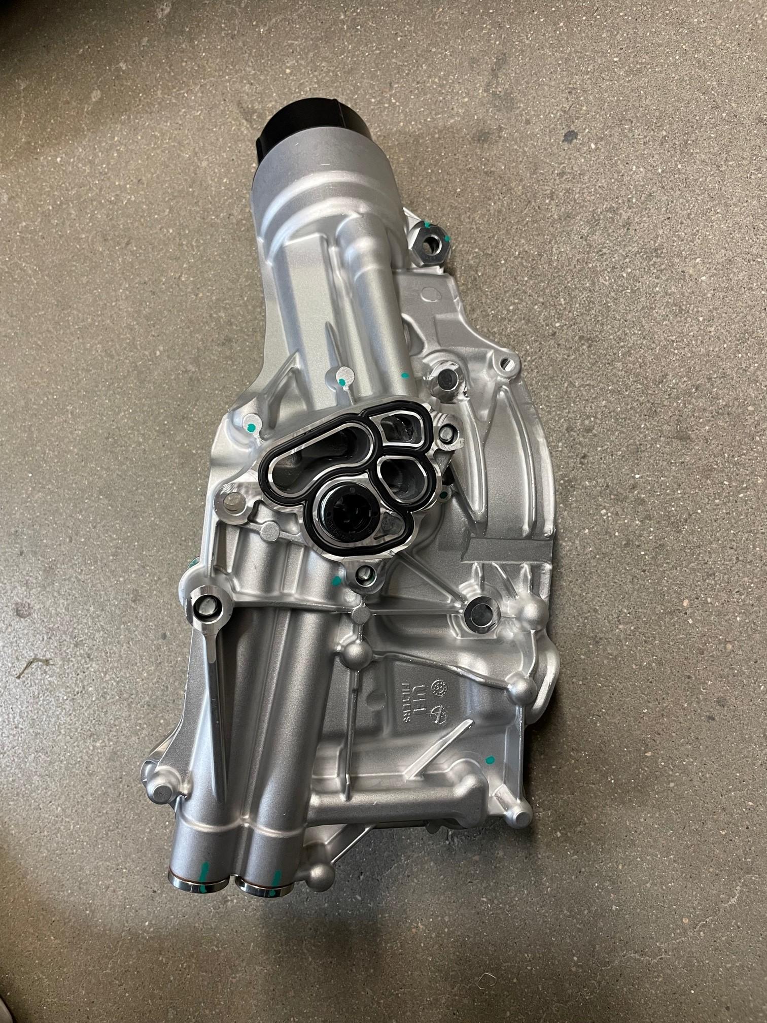

I'm curious on why the diesel utilized bypass valve at the filter. If it's safe to do so, can you push some zip ties through all those ports and take some pics inside the filter area and where it exits? This will help determining it function.

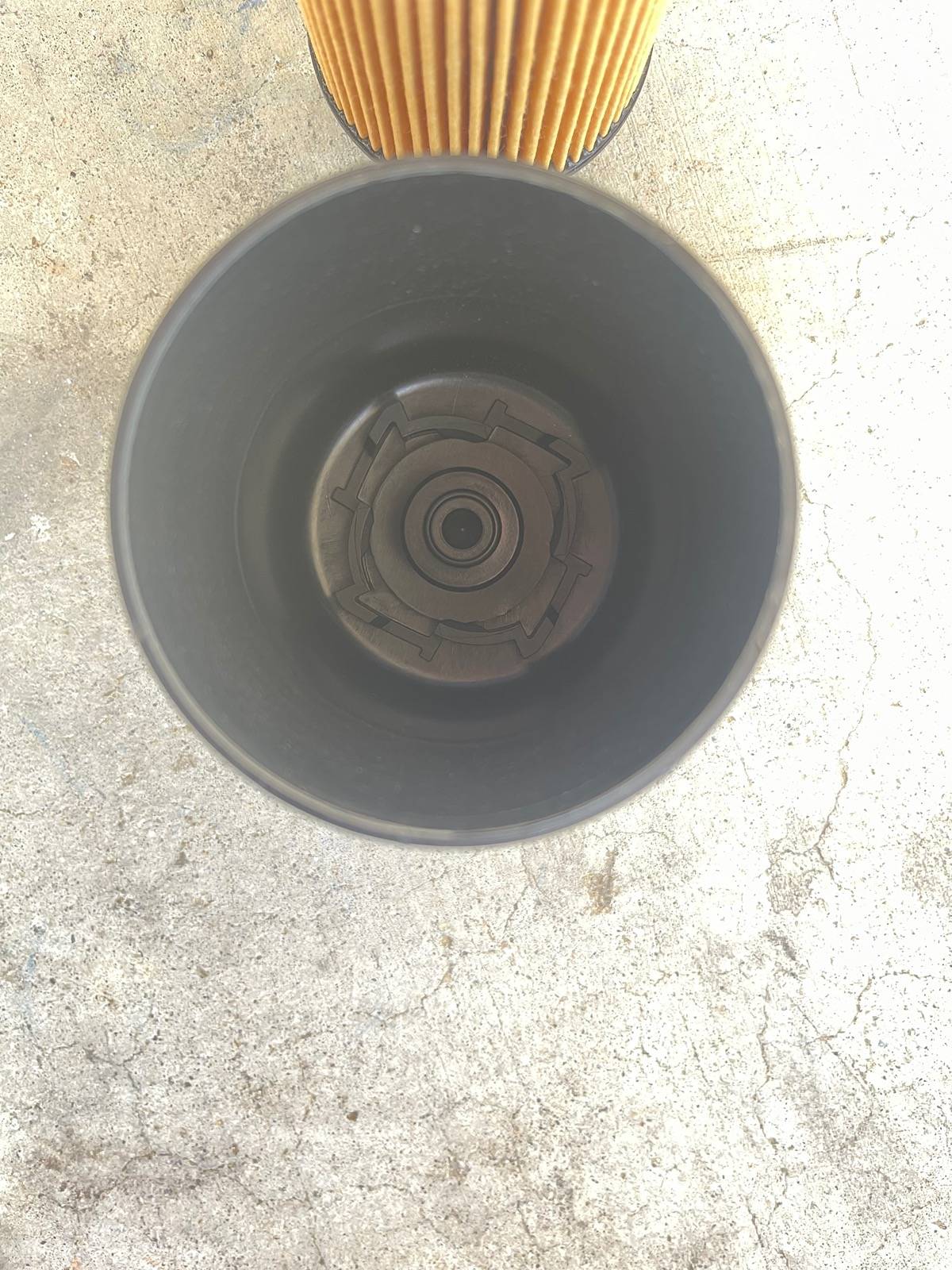

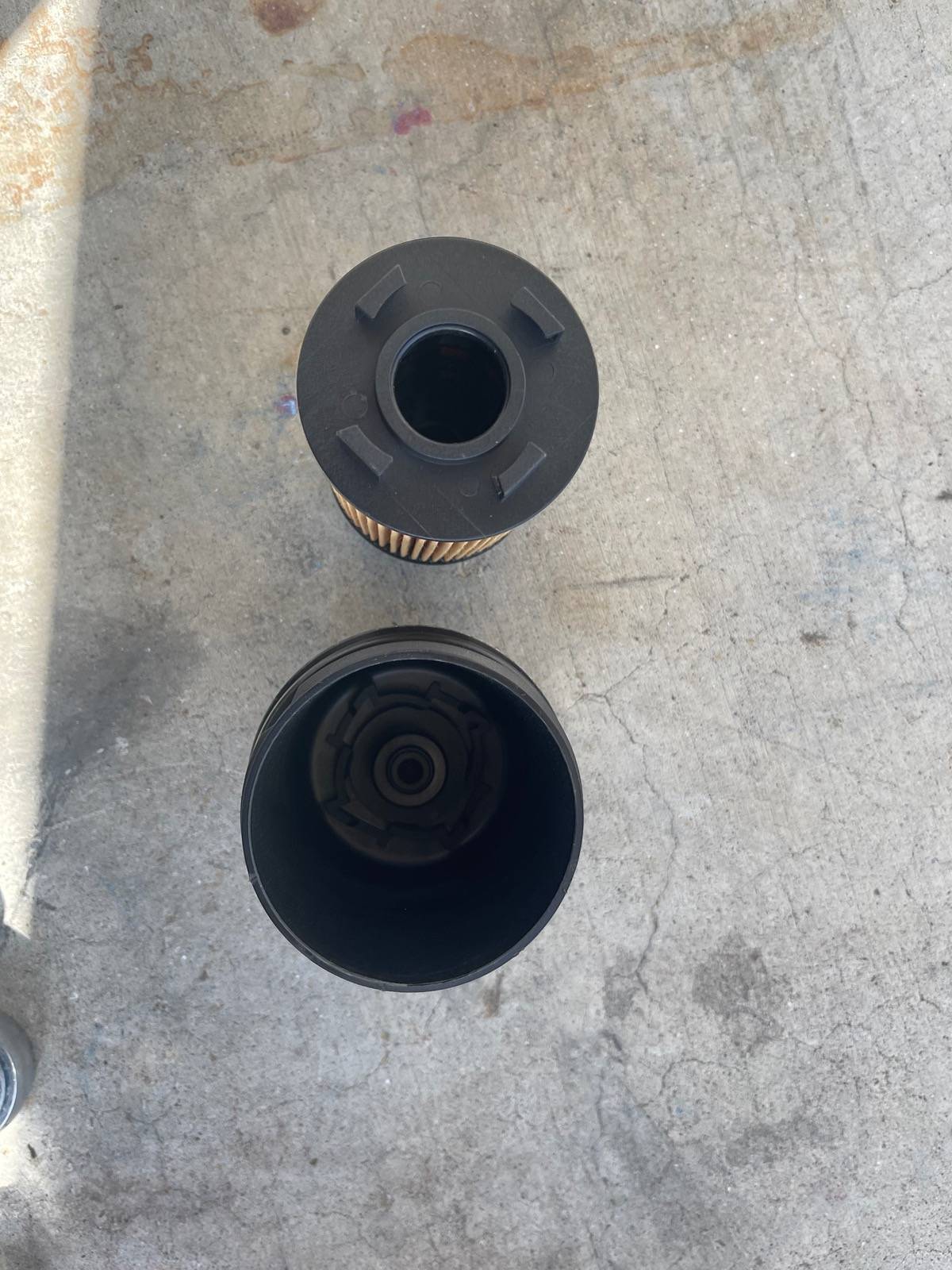

I am currently tracking down a leak- somewhere around the oil cooler/filter housing area…. The photos here are very helpful, and I just so happen to take a filter apart today…. So resurrection with a contribution…. ??
Unlike the Ecoguard, this one appears like a very good copy of the oem filter. Both cap and valve ??
Uh, yeah... dealer charged $108 for this OEM copy….???

Thanks, I was kind of in a pinch visiting family. Jeep decided to have issues here… it was just in the shop not too long ago for a timing cover gasket leak, valve cover gasket leak, and cam sensor leak :|…. Assuming the tech over tightened the filter and it finished cracking now?? Made a huge mess. So several cans of parts cleaner later…. I am not sure if it’s done leaking, something else still might be leaking?? Or it’s just residual I am finding traces of still… ??‍♂ sucks- but the dealer had one in stock and Autozone had oil! After seeing this tread looking for images of the cooler assembly- I had always thought the relief spring was built into the cap…. (Until finding the photos here) So I popped it off to see why they sell this as a unit and not as a cartridge like VW/audis and more….
Cartridge filters were designed to be low cost replacement and good for the planet, but Jeep managed to made it most unaffordable and waist. Box of 10 oem Lexus cartridge filters cost $50.

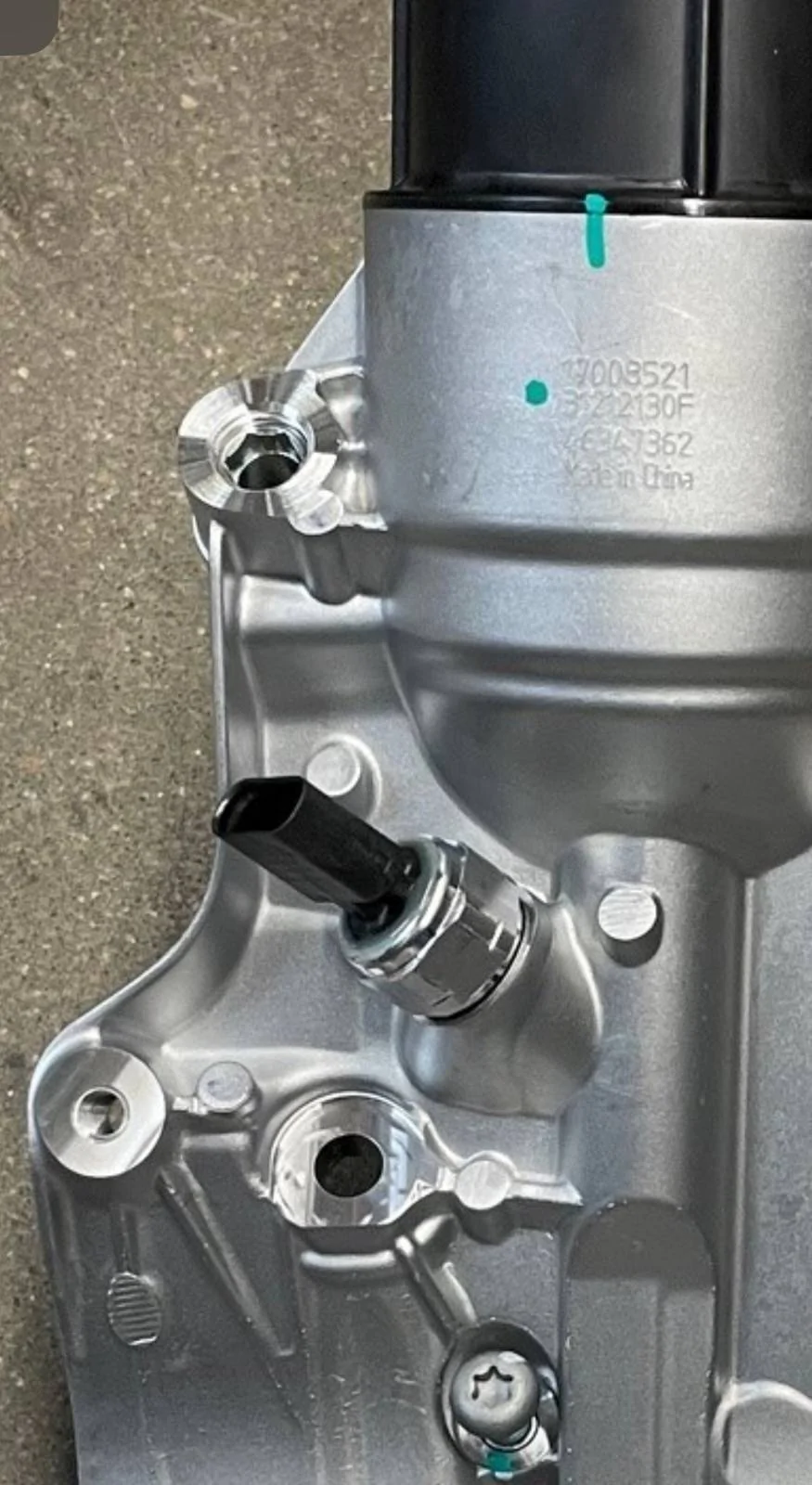

The oil pressure switch- has anyone taken this off and or know the wrench size? Assuming there is a crush washer on this sensor? When removing this- assuming, oil in the filter housing will drain out?
Thanks in advance for any info anyone has ???
No crush washer. Normally a taper thread. Yes, oil will come out. How much........don't know. When you install the sensor. Use a thread sealant. Tape or paste.

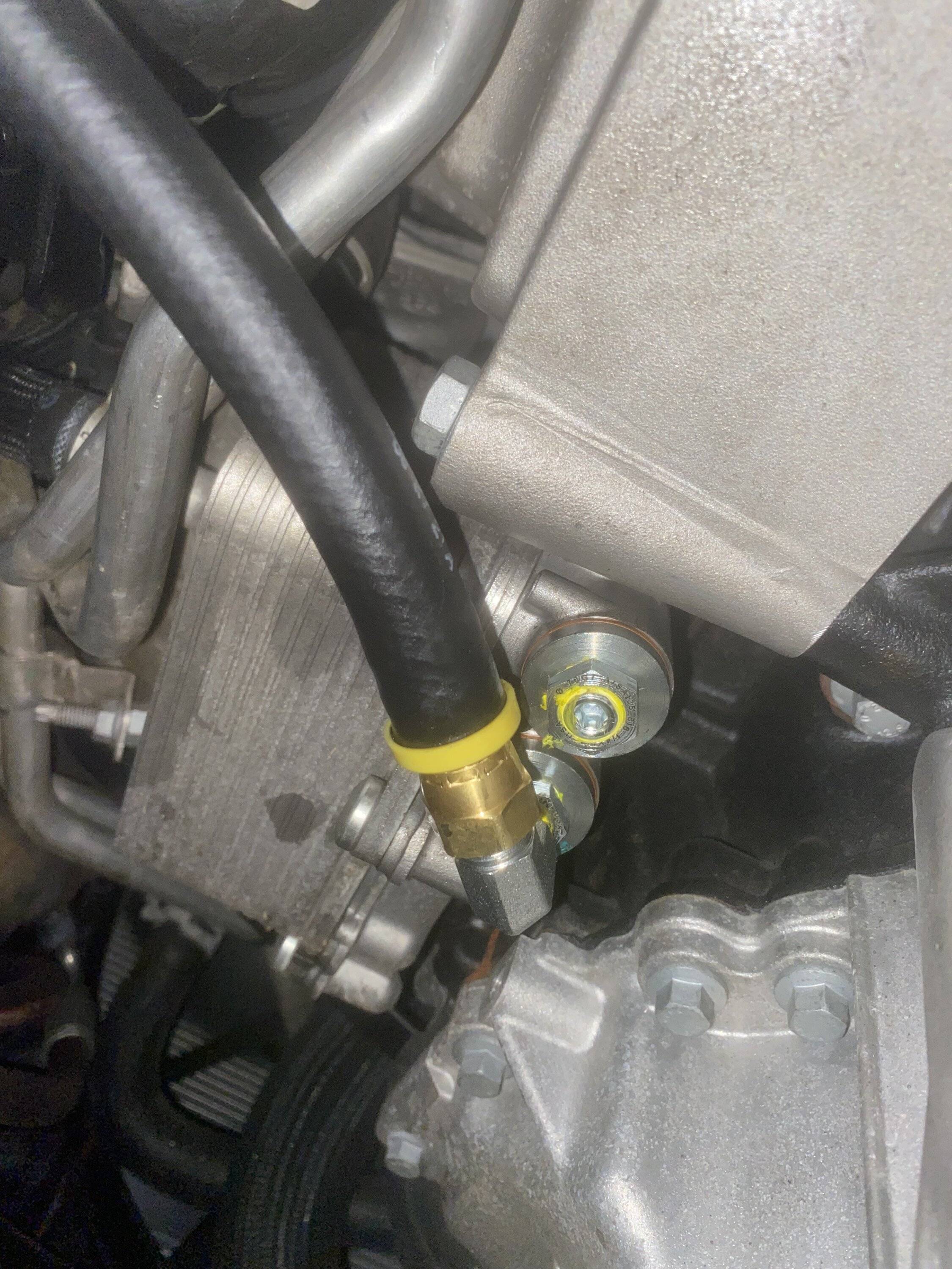

Started with ISD filter housing. I verified PSI before tapping into the plugs on bottom of filter housing. I currently use the taps on the bottom. The ISD filter works the same and had the same results. I changed oil after about 3K miles. I only had factory filters. I also think the tap in bottom of housing is cleaner. Easier to change factory filter than ISD. ISD does use a standard oil filter that fits the Gen 1 and 2 EcoD. $15 for a wix filter.
The current set up.
You can see the bottom of the ISD bypass filter in this pic. 2-90* fittings. One from tap, one to cooler.
@NCJL
This pic is where you pull off for your bypass filter? But the passage where you are pulling from was/is heading to the OEM Filter? I guess I'm just curious if this is pre-filter or post filter? Do you know what the other port is for?

Yes everything is still working great. Thinking all the post I did in regards to coolant/oil temps might be spread out amongst a few threads.
Recap of what worked without any problems to date.
Amsoil 2 micron oil bypass filter.
Tapped into the 2 ports bottom of factory oil filter housing. Plugged one of them. Use the other to the Amsoil bypass. From bypass to Derale cooler with fan, controlled by aux switch. Cooler return line to factory oil pan (welded in bung).
I used the front port on oil filter housing. Not sure of the position in the oil loop.
I’ve pushed the JTRD up some long 6% plus grades (85/90mph) testing. The highest oil temps I’ve seen with the current set up is *252. Coolant was close to that. Temp recovery to normal levels is less than a minute.

Thank you for the info. Looking to do something similar with my JTRD. Looking to moun the cooler in teh lower bash pan under the bumper or in teh grill area.
Question about the tapping of the plugs (Oil Filter housing) 1/4 necked down to 1/8, why neck them down and use 3/8 line for the cooler and by pass filter?

I originally installed the Insane Diesel bypass system. That system used 1/8 ports with 3/8 hose. I was also told not to have more than 3’ of hose between the bypass filter and the tap port. The 1/8 port with less than 3’ hose, no loss of oil psi/flow will be noticed.
