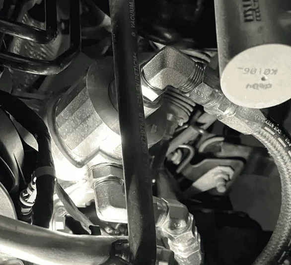

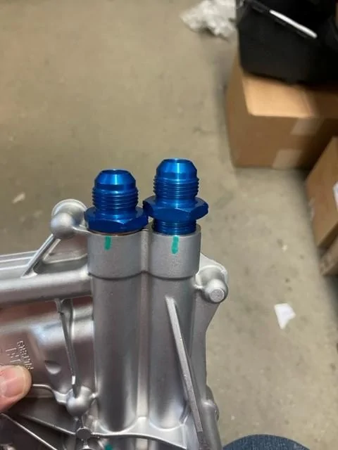

M22 1.5 to 10AN fittings... May try to install one, clearance it and install the other but they won't go directly in.
Jeep Gladiator Anatomy of the oil cooler and filter housing. an1
@californiajeeping
Apr 1, 2020
958
1,013
California
2022 Jeep Gladiator diesel, 1977 cj5 LS swapped
Unfortunately it is just bypass or in paralell to the oem oil flow, correct?

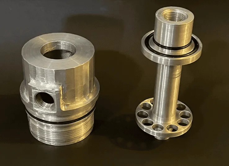

Has anyone completed either the blockoff plate or the bung adapter for an oil cooler......
There was a guy on the ram forums that built an adapter to go into the oil filter housing that completely eliminated/bypassed the filter ASSY and he installed the AMSOIL remote universal filter/bypass unit
..although he didn't install a cooler in line it would be easy to do if completed like that.
there are multiple ways to success here. I am hoping that someone comes up with one more brilliant than my hodgepodge knowledge lol. Last time I owned a diesel it was a GMC 2500 and there were really no emissions for heavy trucks then.
if this doesnt work out I plan on getting a oil pan and putting in a separate system for towing only would use a pump like https://rbracing-rsr.com/oilsystems.htm. this would pump oil from pan, thru a filter, a cooler and back to a return fitting at a higher level in the pan. This could be rigged to a temp switch or just hard wired in for use when towing.
My build finally has a D1 status so hopefully someone will have a path forward that I can adapt/use when my JTURD gets here later this year.
Jeep Gladiator Anatomy of the oil cooler and filter housing. bypass adapter ED 1
Jeep Gladiator Anatomy of the oil cooler and filter housing. bypass adapter ED 2

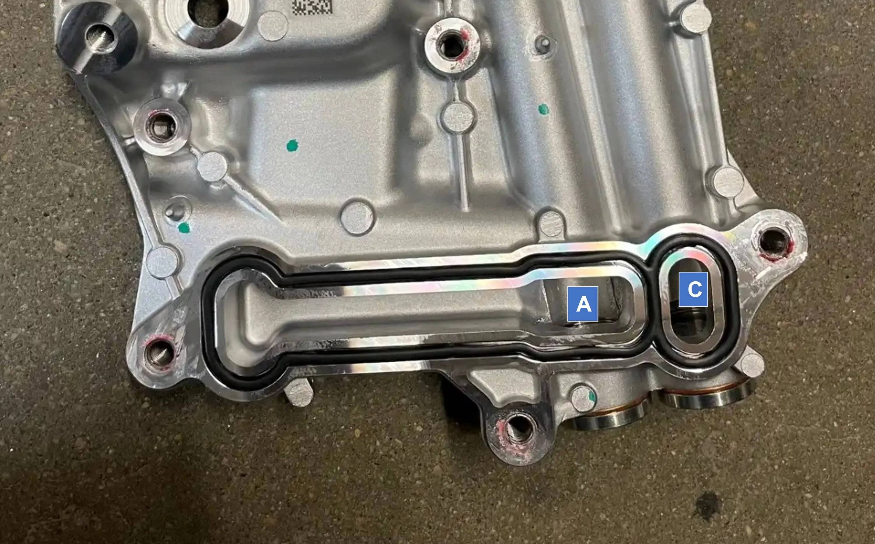

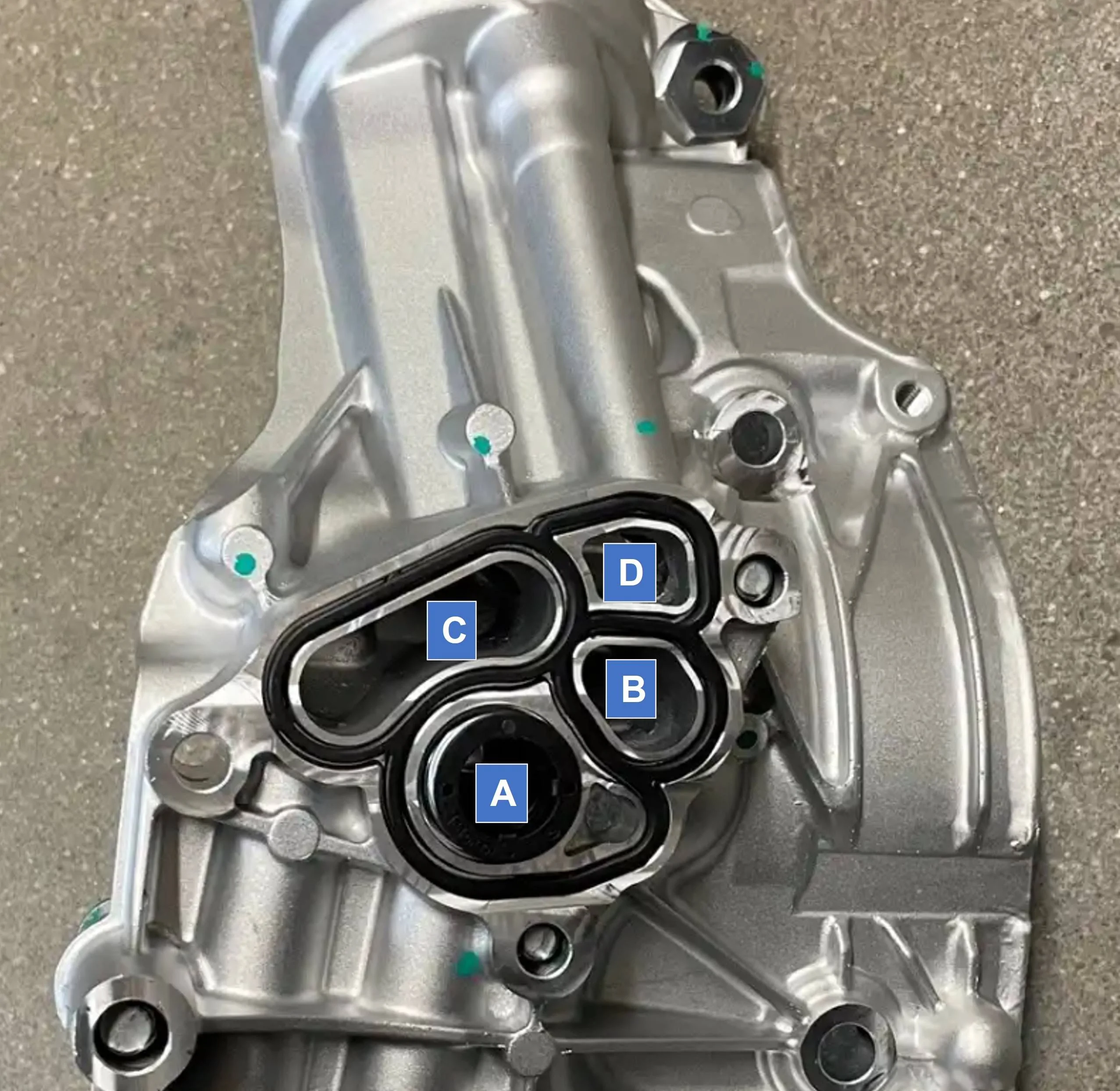

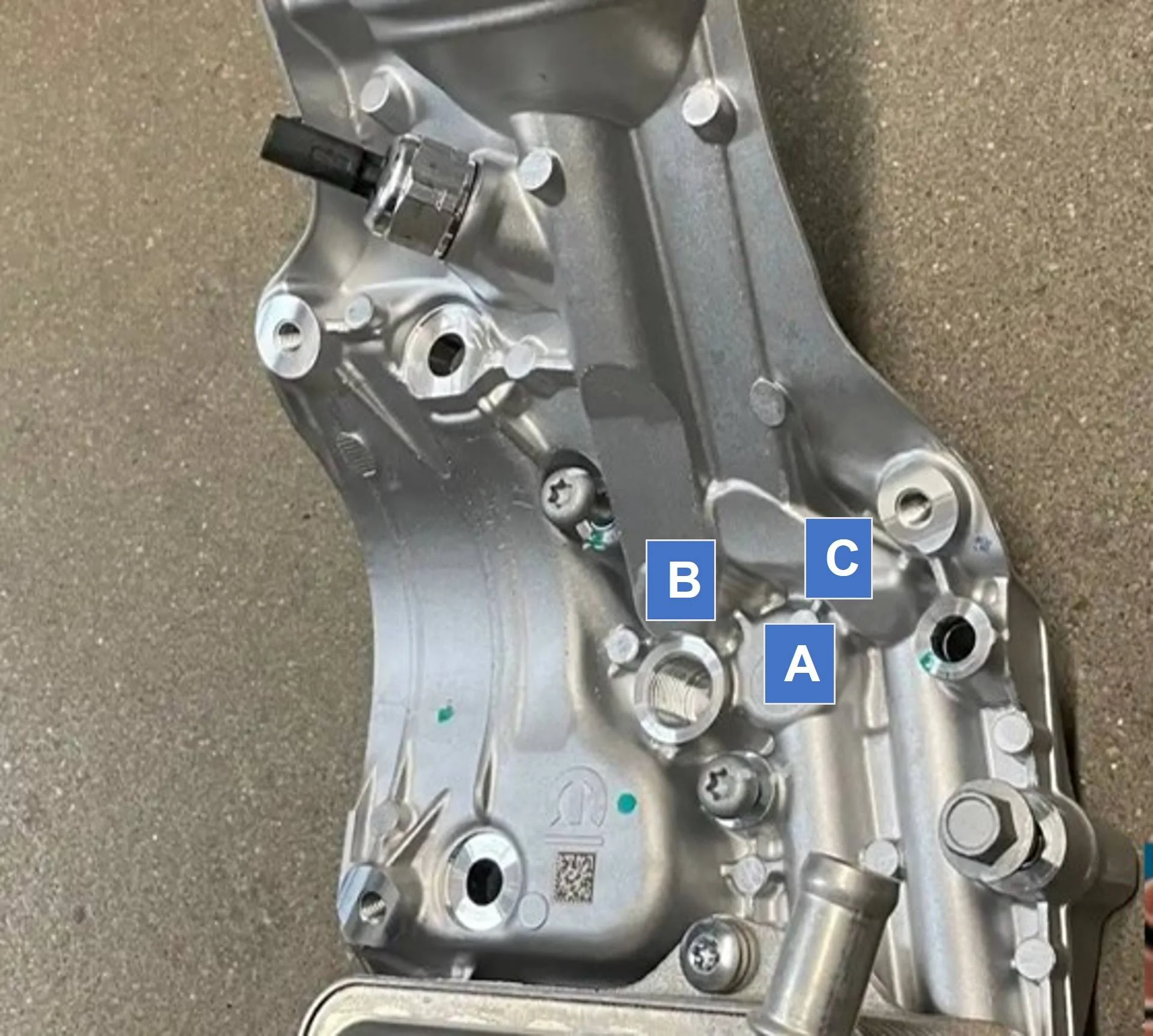

Ok so the Filter assy I ordered showed up. trying to understand the flow of oil thru the filter and cooler assy. Please correct me if my understanding is incorrect or i have mislabeled the oil flow/direction. Trying to understand how it works before i even contemplate making mods for improved cooling.
I have identified the oil passages by a letter and have explained how I think it works is in the below paragraph.
A Pressurized oil from pump flows thru one way valve to keep oil filter/cooler from emptying when off. This flows to oil cooler connection and then flows thru cooler and back up to C and into filter assy. Oil comes back thru the filter and down thru B entering the oil passageways in the engine. D is a drain-back from the filter.
Jeep Gladiator Anatomy of the oil cooler and filter housing. oil filter assy  entrance to oil cooler 1
Jeep Gladiator Anatomy of the oil cooler and filter housing. Oil Cooler to filter assy connection
Jeep Gladiator Anatomy of the oil cooler and filter housing. front side side view oil filter Assy
I'm a picture kind of guy. Explain it to me with pictures and it all comes together. The black valve identified as A oiling circuit in the first picture looks and feels a lot like a bypass pressure switch (meaning it only allows oil to flow one way) I do not see any form of a thermostat for this piece.
Any Aux Oil cooler added to the plugs under the cooler mount would just be a larger loop for the oil to cool in. I would probably add a oil thermostat just off of these before the lines to a oil cooler so that it wouldn't open up until the oil is warm.
Not sure if the Ram uses the same oil cooler mount but it looks like it was designed to use a external oil cooler.....OEM just never went that far.

I'm curious about "A". The check valve/temp valve. Because someone has called it a temperature control valve. In that it doesn't open until a preset temp is reached. Can you take a couple more pictures of it from different angles?
