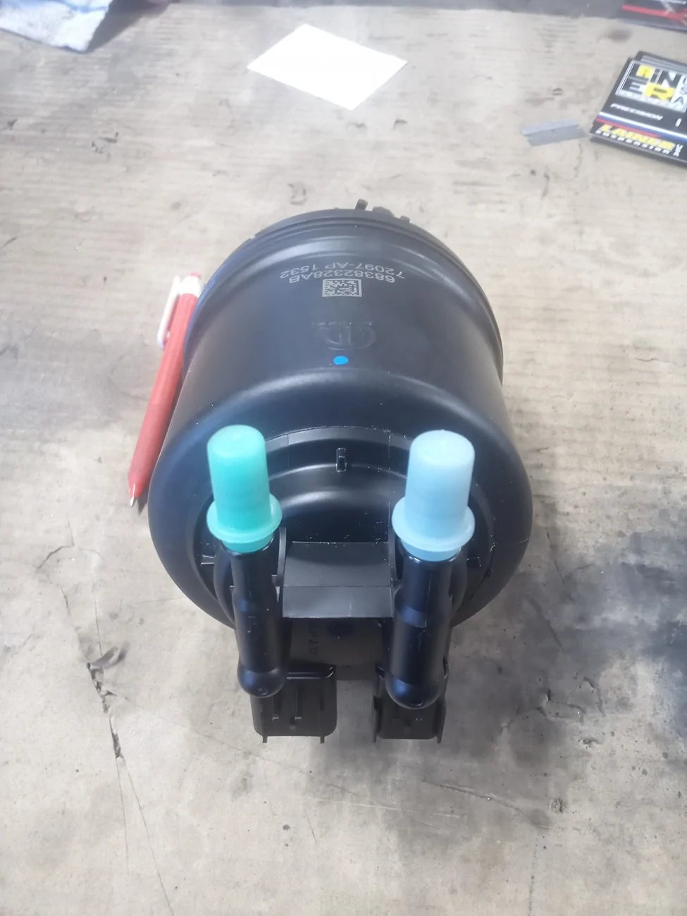

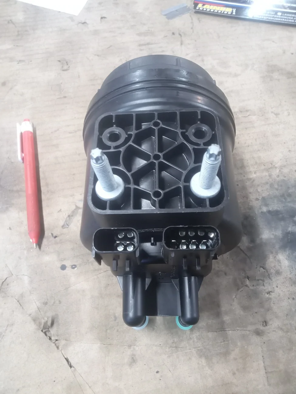

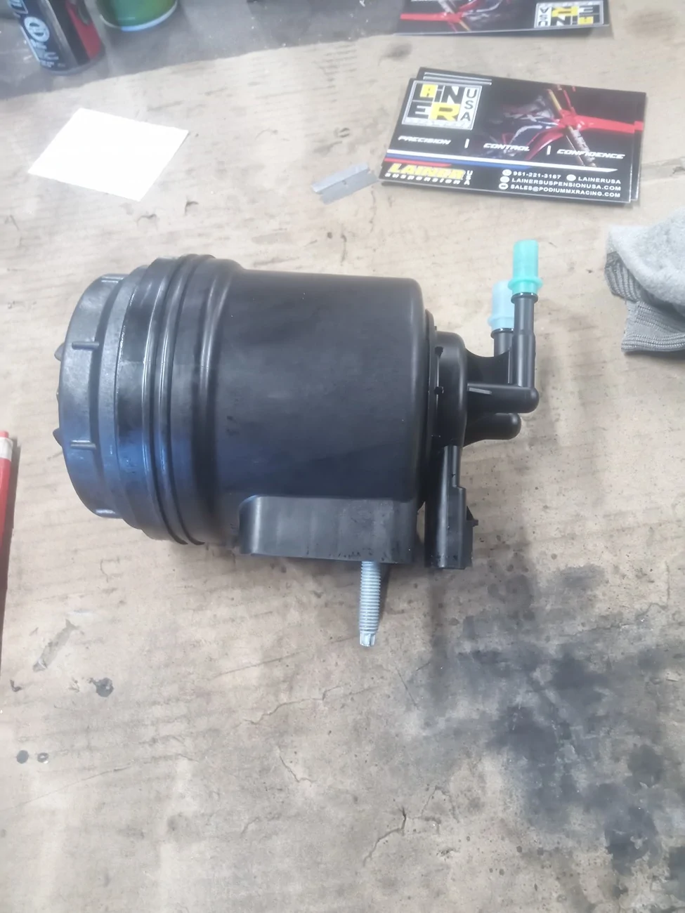

Once I get some time gonna drop my metal cloak skid plate and measure lines. As long as they measure fine I’ll order it, if not I’ll contact them to get the proper line sizes
rharr
May 6, 2021
29
2,044
2,800
Tucson, AZ
I have a spare filter housing i carry in my tool box, if you need me to measure certain things let me know and I can dig it out.
