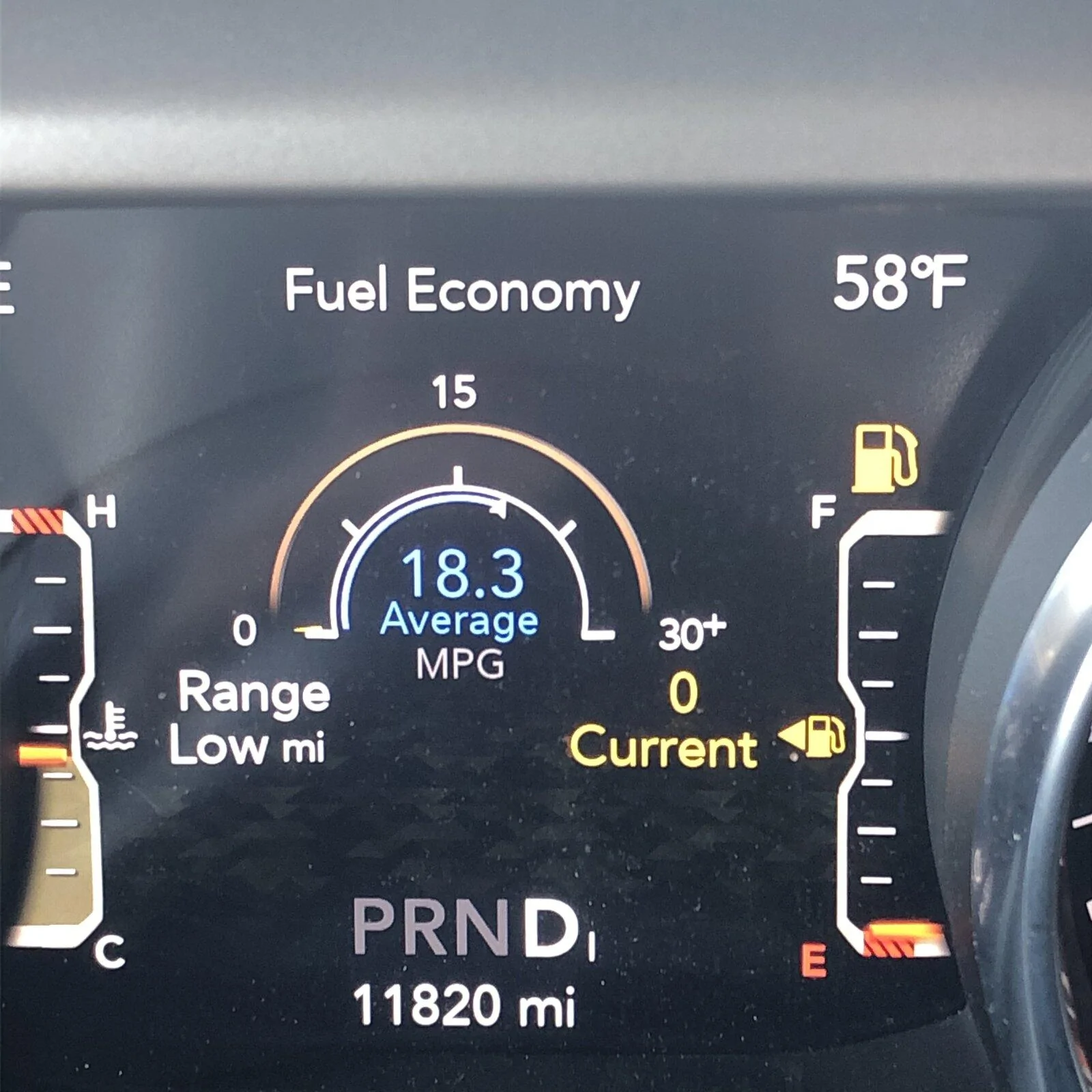

Yesterday I unintentionally got low on fuel. Was more of an observation rather than trying to get really low: gas at the Costco was 30c per gal cheaper than the station near me and I needed to go to that area anyway.
Anyway, fuel estimator showed 12mi remaining and the "Low" status still didnt come on. Finally did after a mile or two, I was 5mi from the gas station. At that point I should have had 1gal left as 15mi estimated remaining fuel on an average of 17mpg is 1gal.
