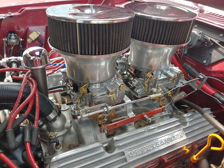

I also restore starters, alternators, wiper motors, blower motors and other components with aluminum parts, as well as the clutch master and slave cylinders in my Eagles - aluminum bolted to steel with brass fittings.
I notice damage on the steel parts and usually the aluminum parts outlast the steel.
Check all the aluminum parts here (carburetors are zinc allow castings)
