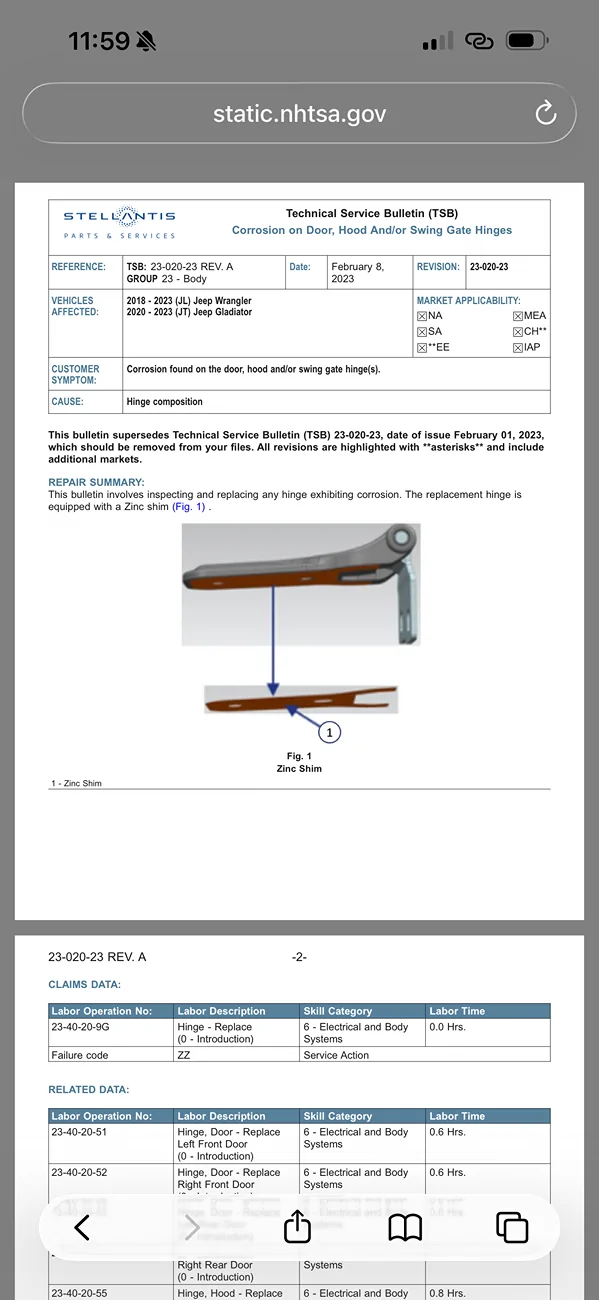

Make sure they do new panels and do the TSB with the zinch shim. My dealer painted the whole panel, cleared it then installed shim and hinge. No way for them to make contact now. Jeep f’d up by bolting hinges on then painting over the whole assembly. Probably to save money, who knows.
If Jeep installs the zinc shim between unpainted surfaces, they are still f'ing us over. It is a sacrificial anode and will eventually corrode away, but it will be after the corrosion warranty expires.
My doors are okay so far, I think. They have the zinc shim. The edge of my hood has a small spot of corrosion that I have to deal with, though. Not happy.

TSB. Hopefully the shim doesn’t corrode as they painted and cleared the hood so it no longer touches any bare aluminum.
