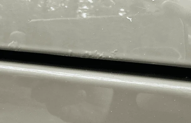

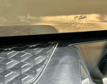

My 2020 has been approved for repairs, and will go into the shop in June. The dealer here has no body shop, but works with this issue with a body shop in the area.
Mine is not on the doors... it is along the bottom edge of the hood, and on the bottom edge of the tailgate. Make sure to take the Jeep into the dealer/body shop clean, and walk the vehicle with them... I did not see the hood, but the paint guy at the body shop saw it, and made certain to document it.
These pictures tripped me out until i read where it was. LOL my brain could figure out what i was looking at. BAHAHAHAHA
