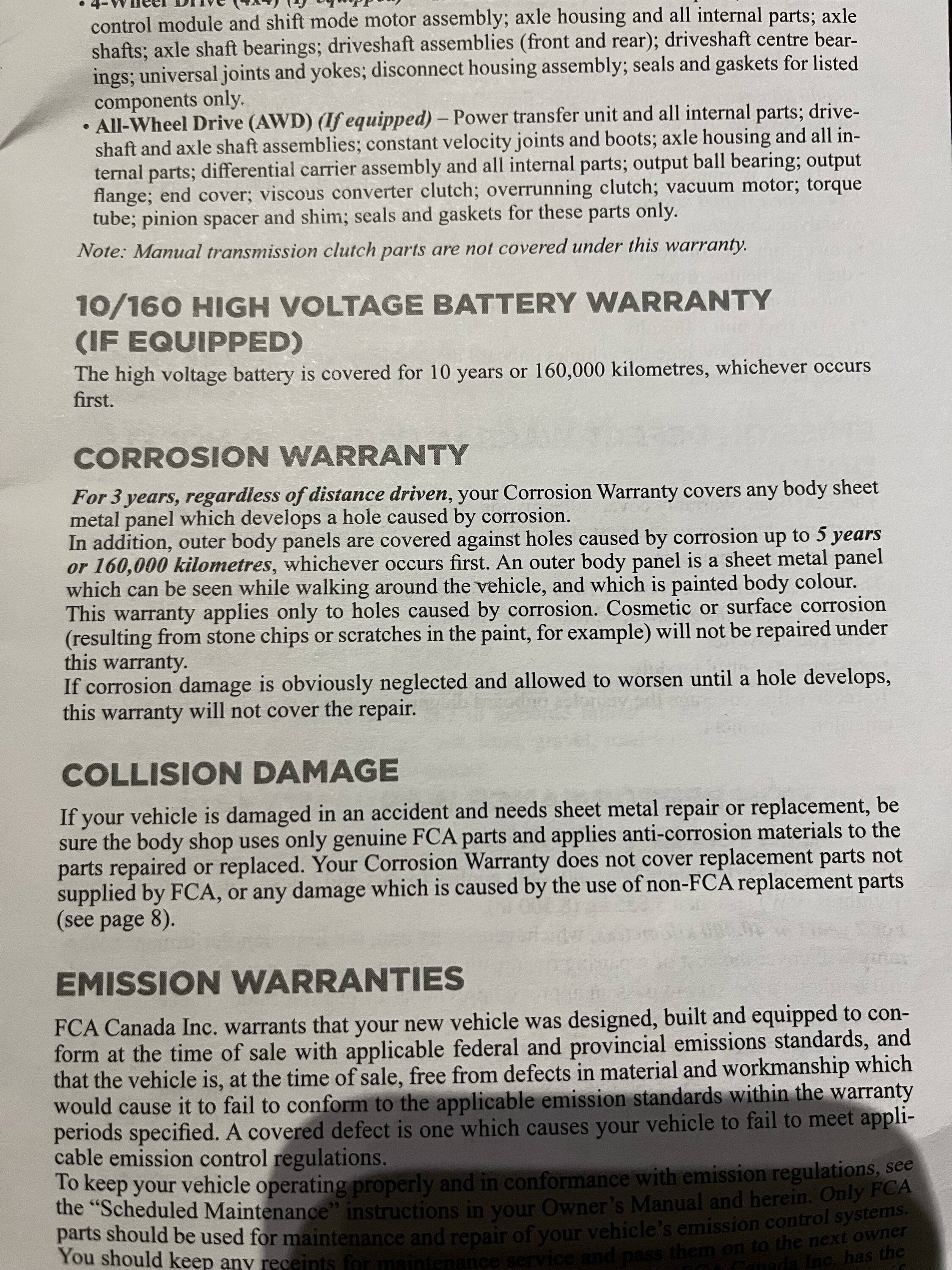

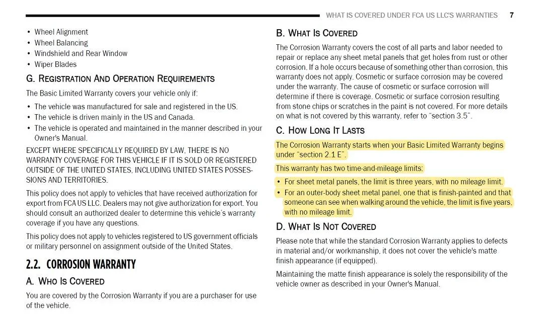

Corrosion warranty is supposed to be 5yrs/50k miles. Editing bc @Hootbro 's word is gold. 5yrs/unlimited miles.

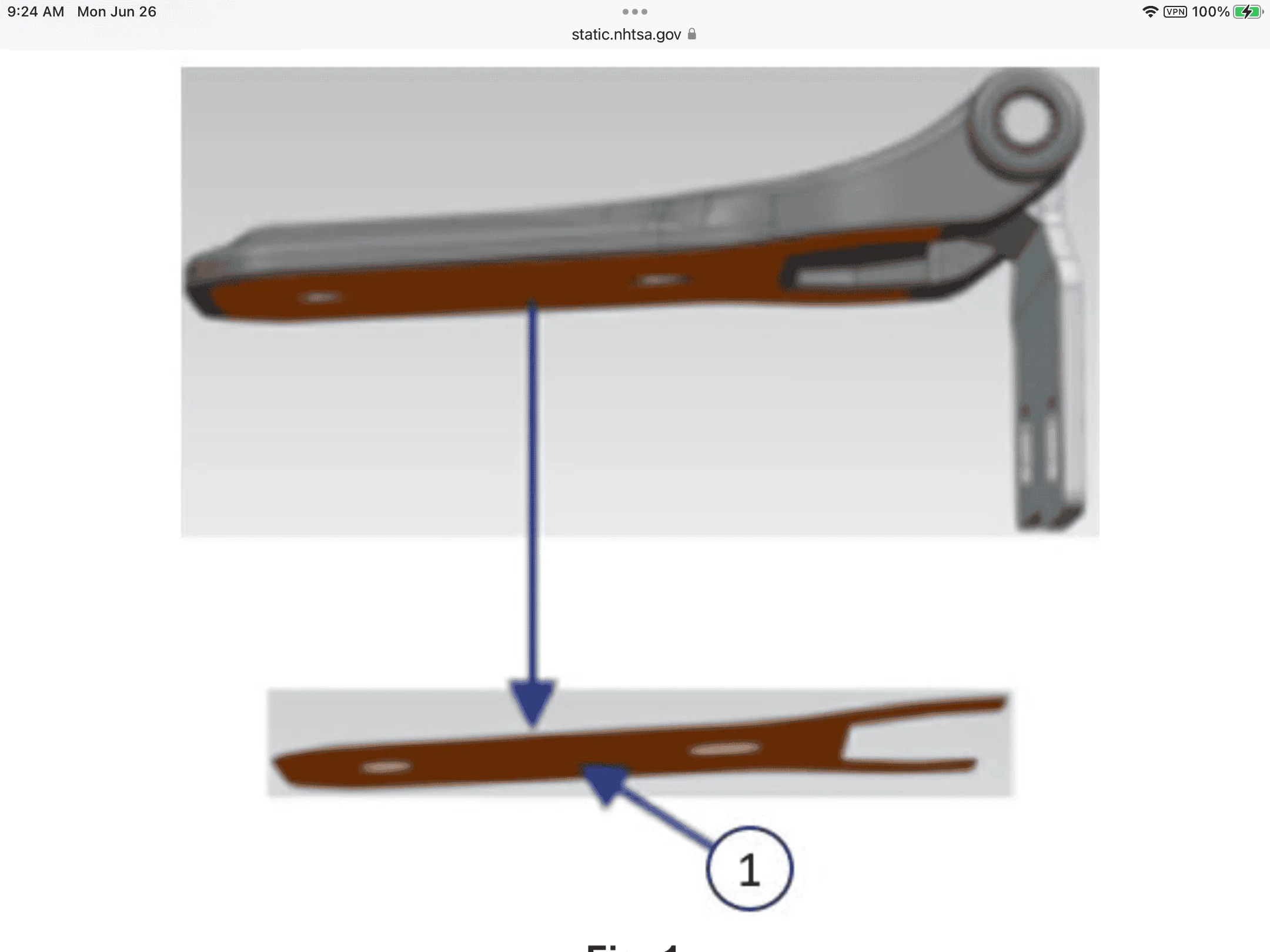

The latest hinge corrosion TSB includes the use of zinc shims behind the hinges which indicates that FCA sees this as a galvanic corrosion issue (or at least an issue with a galvanic corrosion fix).

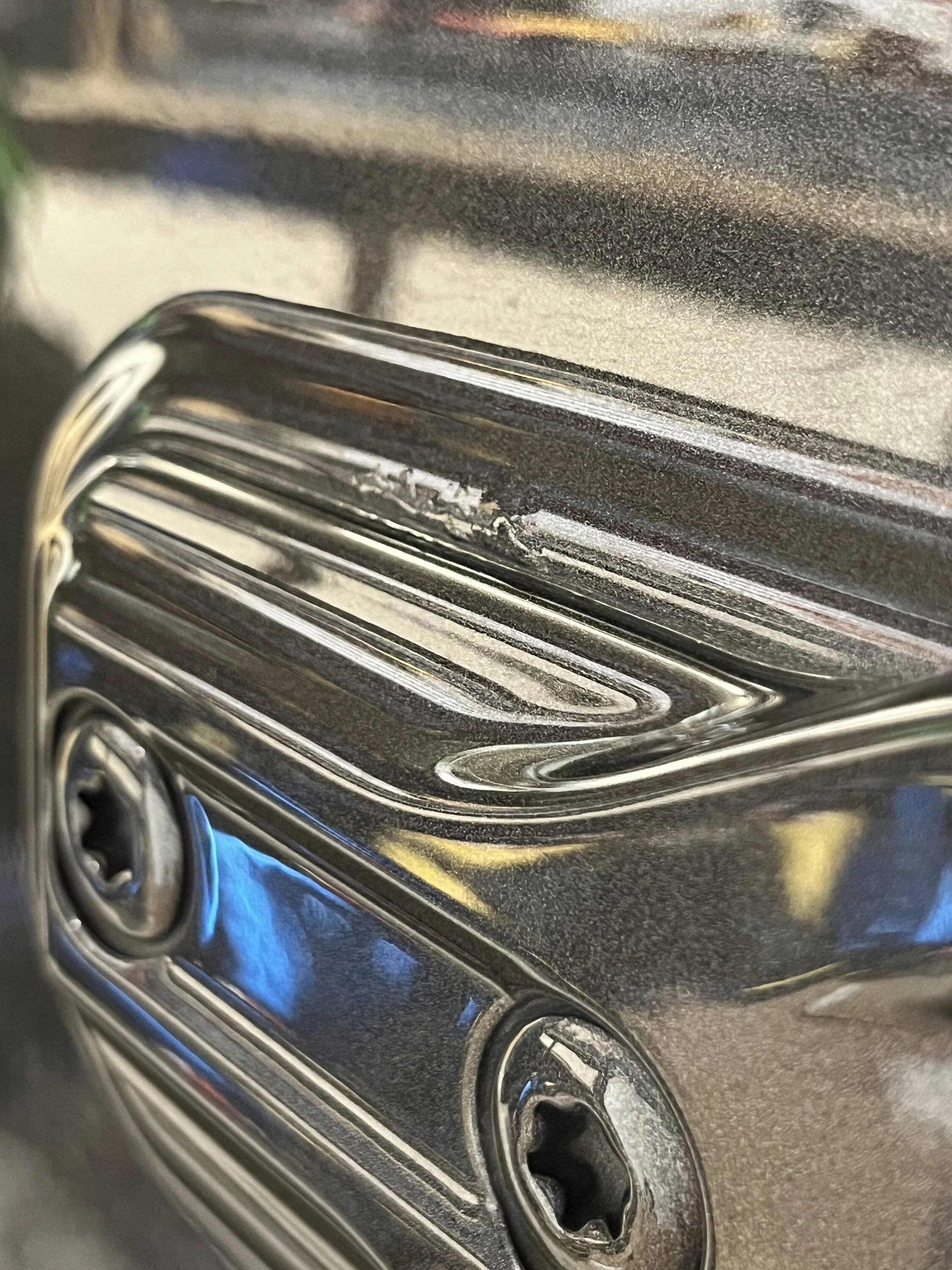

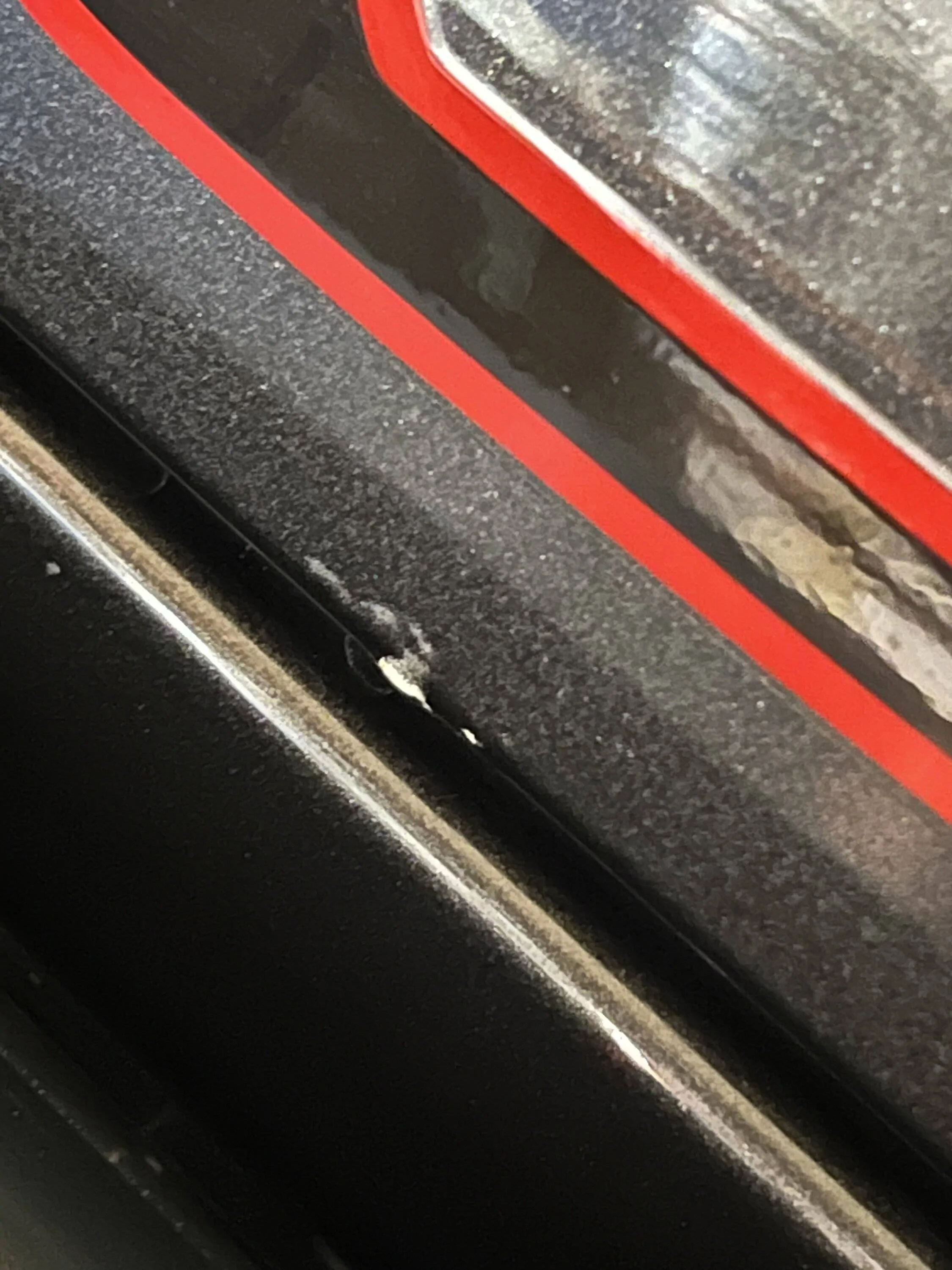

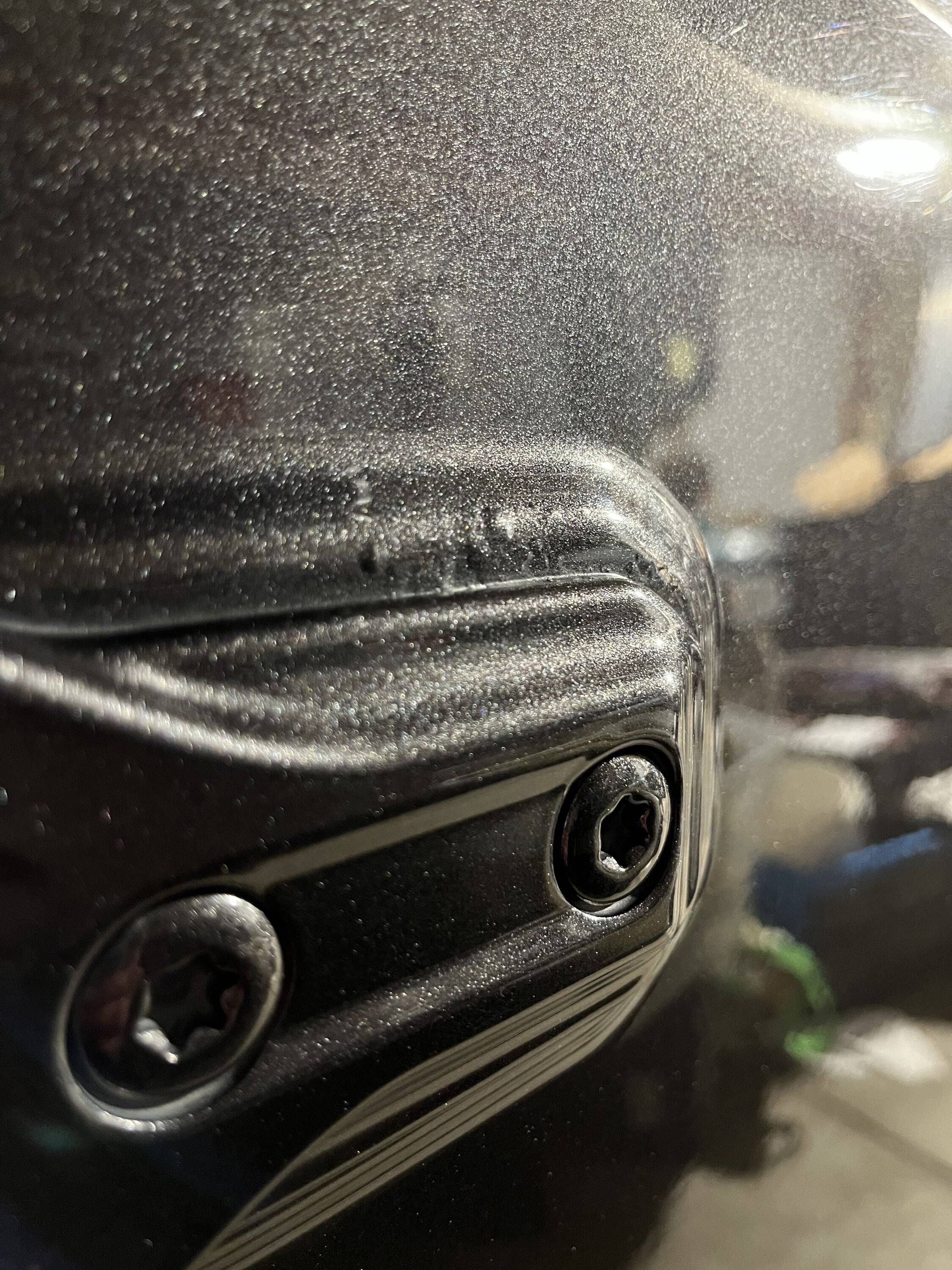

(21 JTR, 82k kms) I guess I’ll revive this thread to say I too have been kissed by corrosion. Didn’t hyper focus on the surface bubbling until I noticed it in just the right lighting conditions a couple days ago. Mine is around the aluminum hood edge and on the aluminum door panels at the metal hinges where they meet.
I quickly checked my warranty booklet and I’m still within it by a month. I took it in and everyone needing to address it came running. Photos were taken, and sent upstairs, a claim was started and the service manager came over and spent 30 min talking with me about the truck and how the year was ending and stuff and then about the corrosion. There’s been a lot of it happening.
My hinges are magnetic but the door panels are not. The corrosion around the hood edge is also on aluminum.
The warranty department then booked me right away to head over to their body shop while the service manager and I were chilling out. The body shop needed to take photos and do their cost analysis for the warranty.
Later in the day I went over to the body shop and the appraiser took photos and said when this was in assembly, they matted the aluminum panel and metal hinges together then painted it. Metal and aluminum don’t like each other so corrosion takes place. He wasn’t sure why the hood edge was corroded being aluminum. That was a mystery to him.
I’m waiting for final warranty approval and then it’ll get booked mid February for repairs.
