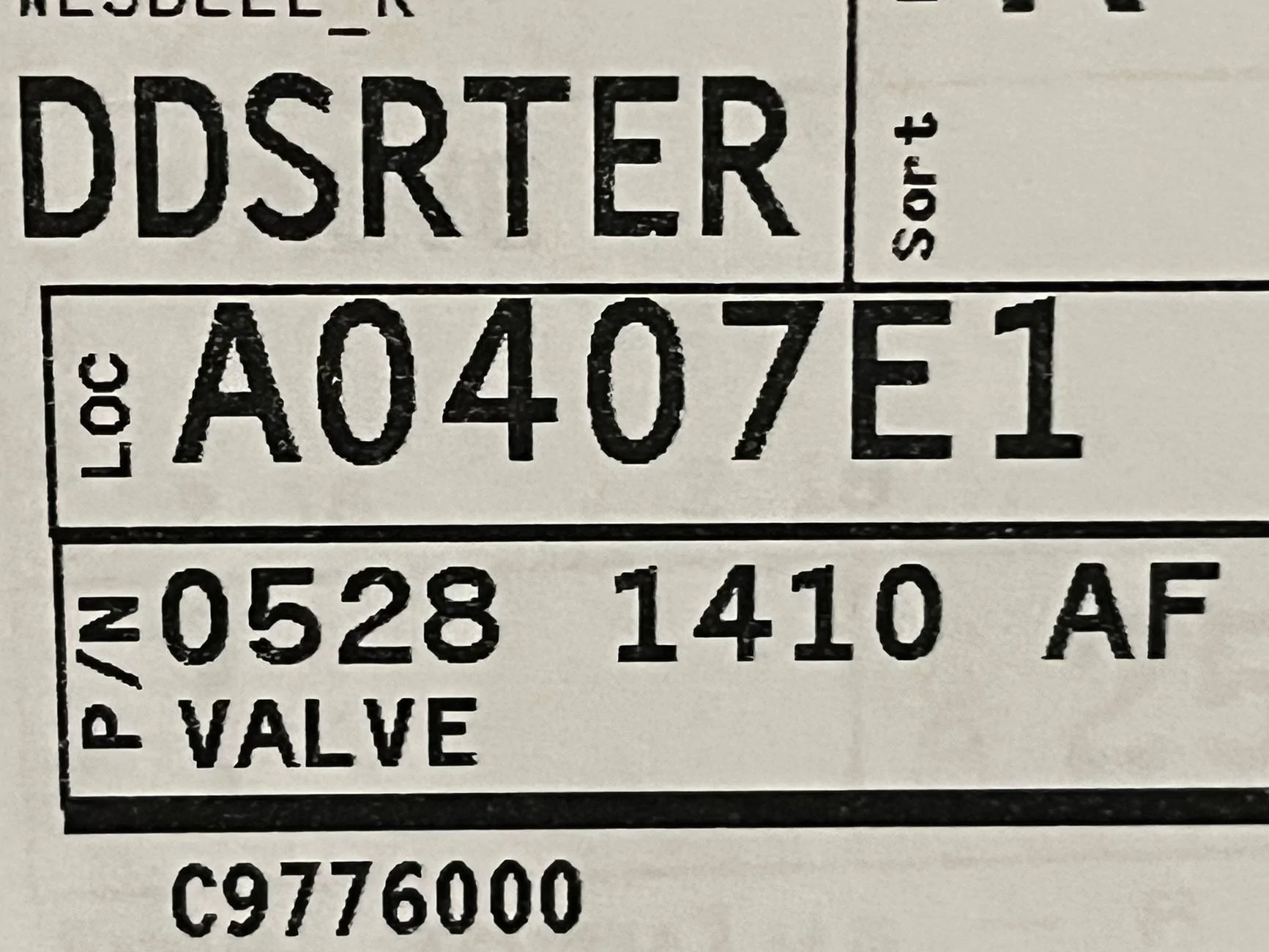

How much was it? What's the part number?

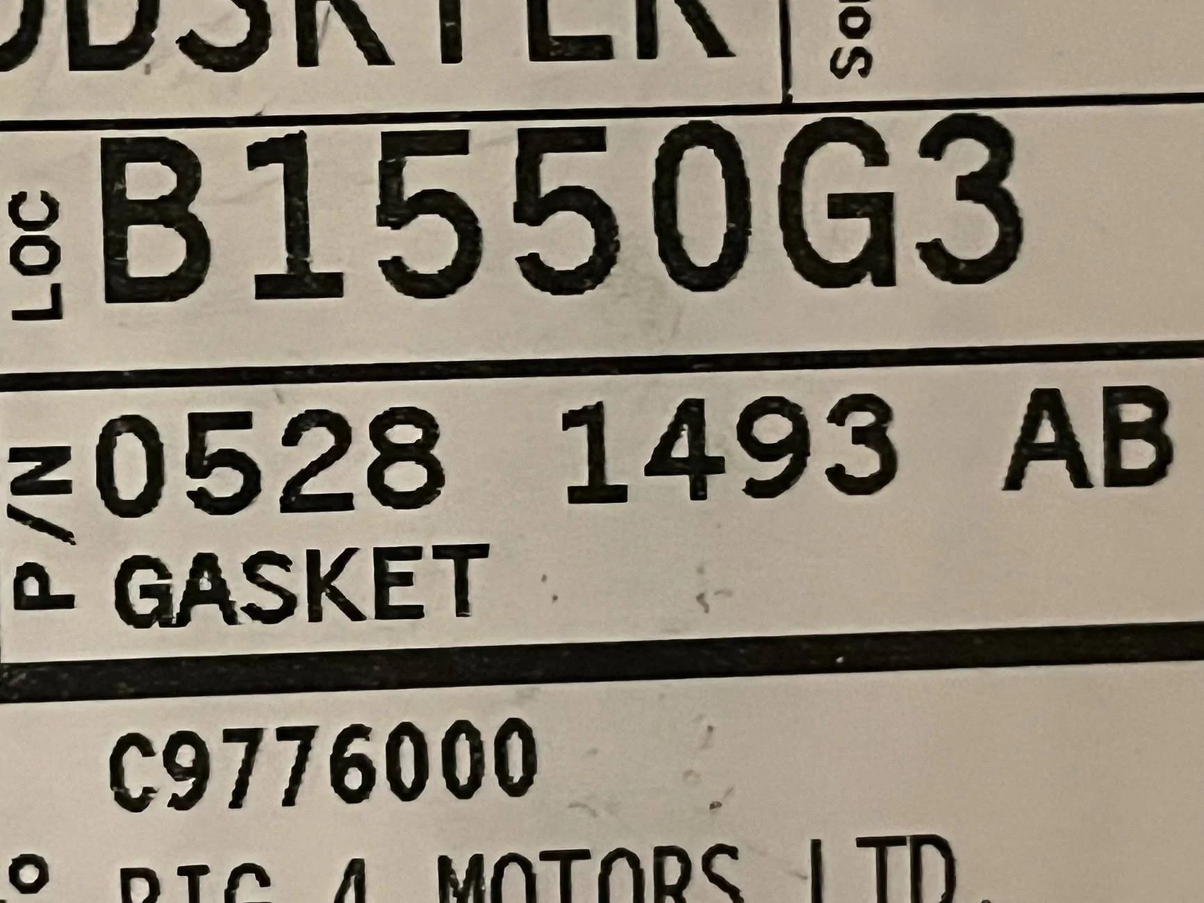

I paid $420 + GST for the valve and $9.20 for the gasket., cuz they like me. The list price for the valve is $664 and the gasket is $19. This of course is in Canadian pesos.
