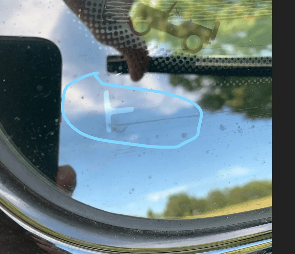

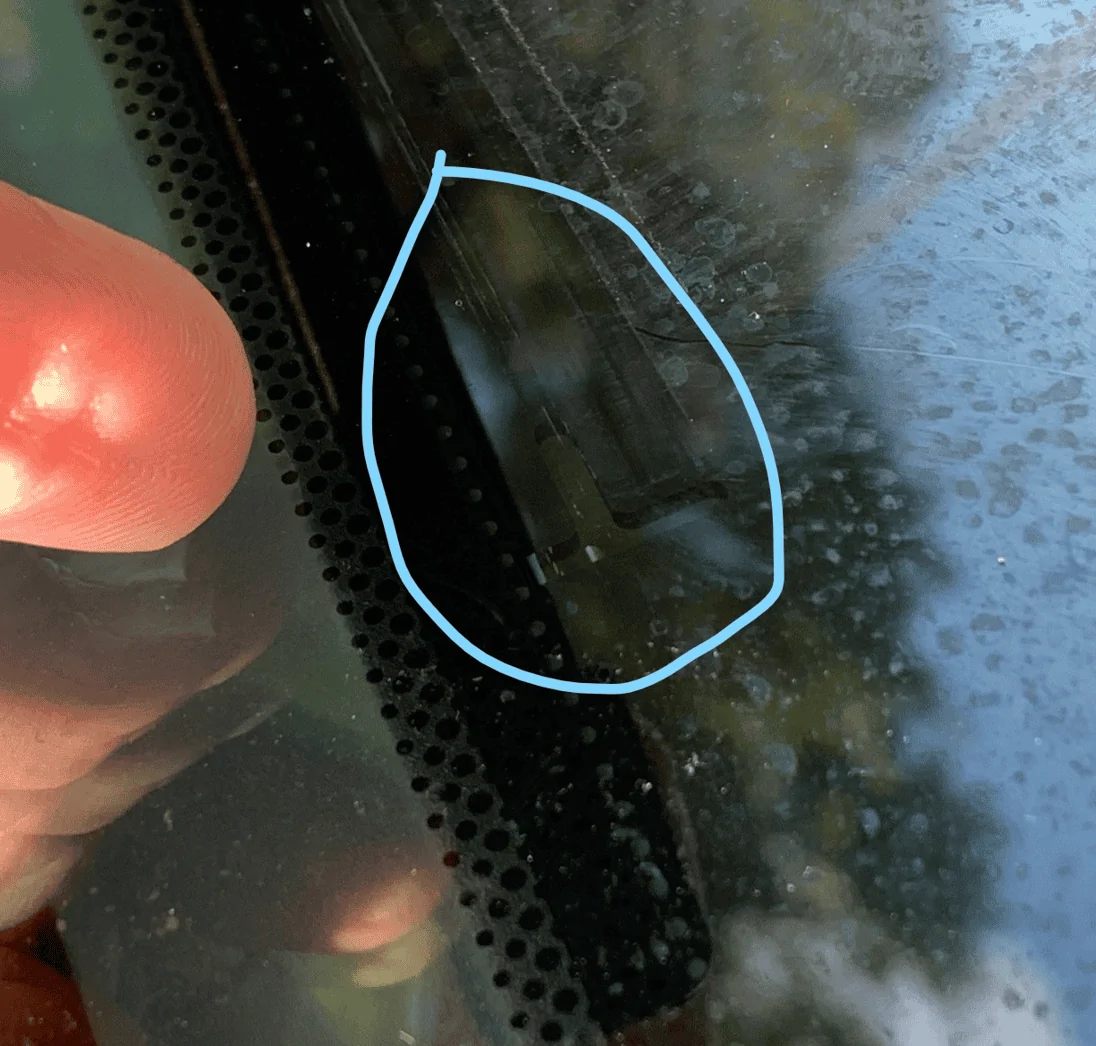

So I was concerned about this too. I noticed the air only really comes from the center position of the front defroster and the side vents for the front windows, but very little in front of the driver and passenger. This morning - woke up and it as 40 degrees and I had frost on 100% the windshield. Went outside started it up put it on full blast HI front defrost. In about 5-6 minutes 95% of the windshield was clear. I also noticed that I have heating elements near where the wiper blades rest on the windshield and they were completely cleared as well (hard to see in the pics but they have copper colored elements). So I guess the real test is when I have ice/snow, but so far it worked as expected.

That T shape on your windshield is a marker for the end of the blade so that they are installed correctly, not a heating element.
Well - the complete area under the blades were completely defrosted.
Looking from the inside you may have something. They appear to be in the middle of the wiper as well. Oh Well. It did look like there was an element in there from the outside. Either way - i was surprised to see the area around the entire blade defrosted.

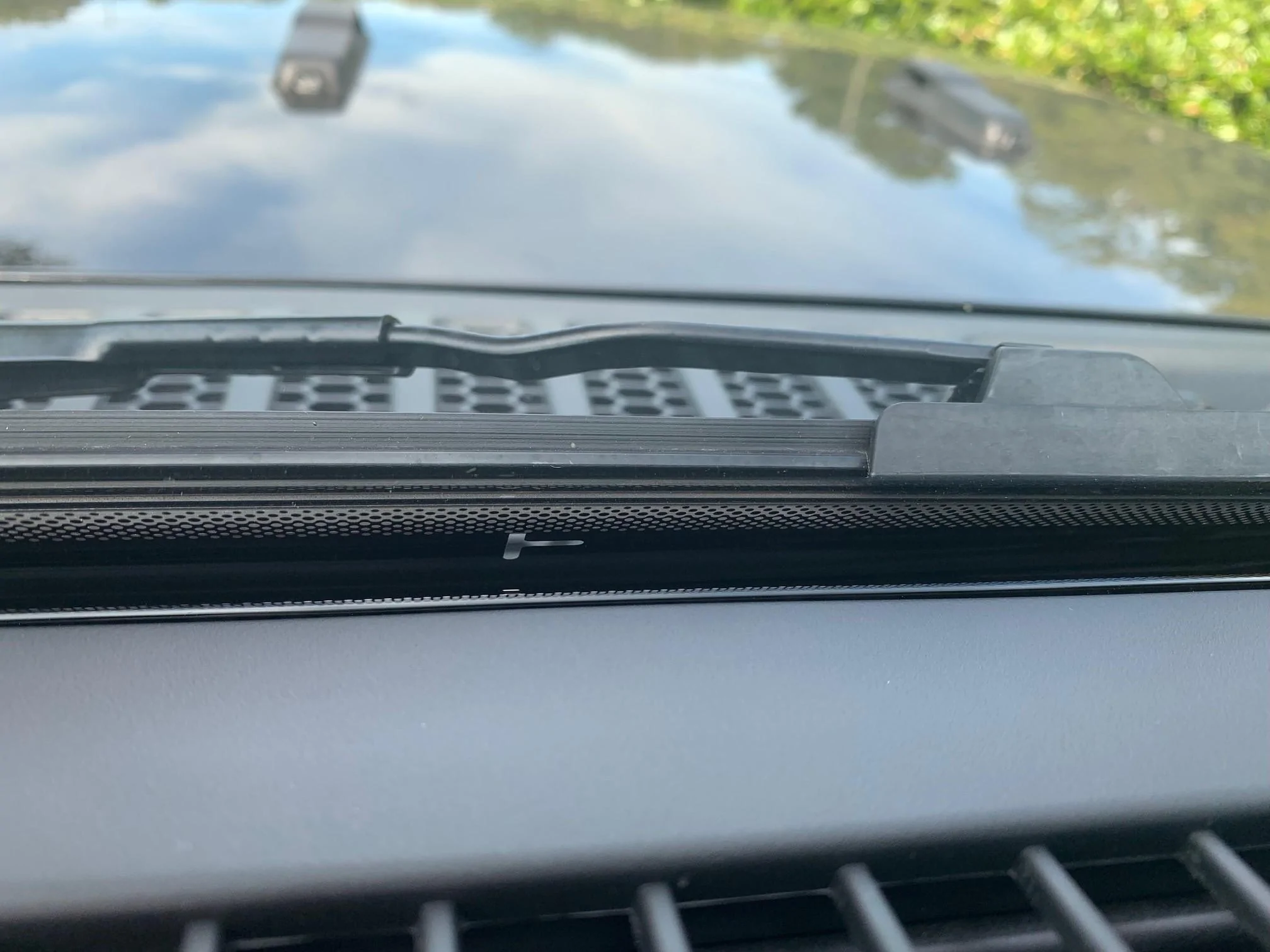

Those T marks are also there to determine where the wipers are mounted for right hand drive Jeeps.
So, half are there for left hand drive, half for right hand drive.
Nothing to do with any type of heating elements
