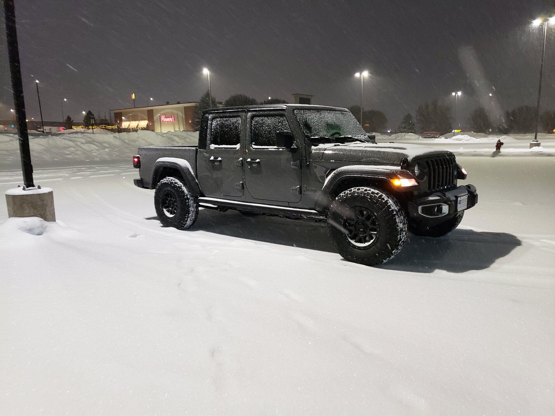

Just drove around a bunch today in MN. No defrost issues that I noticed. I'm in a 2021, built in Nov 2020 - if that matters?
