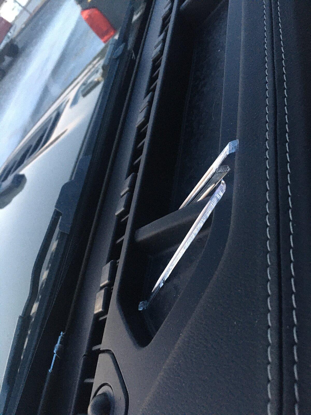

Well, the unofficial fix arrived. I’ll report back after installation and a cold day...
I ended up removing these. They didn’t fit very well in my dash and would rattle. Had one go through and that was fun fishing out.

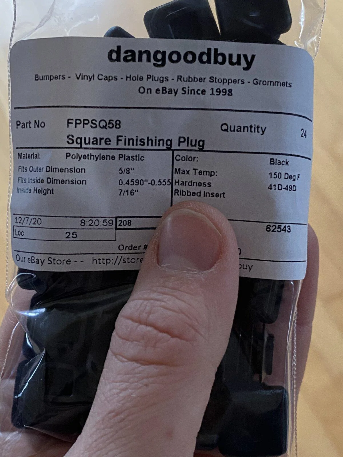

Has anyone found the right combination of caps in the center to get it perfect? I've had my Gladiator 3 weeks now and in both of our snow storms so far here in east coast Canada I've noticed the snow build up on the sides under the wipers to be incredibly quick so I've ordered the plug solution mentioned here on Amazon.
Try this to start then add or subtract or rearrange as necessary.
