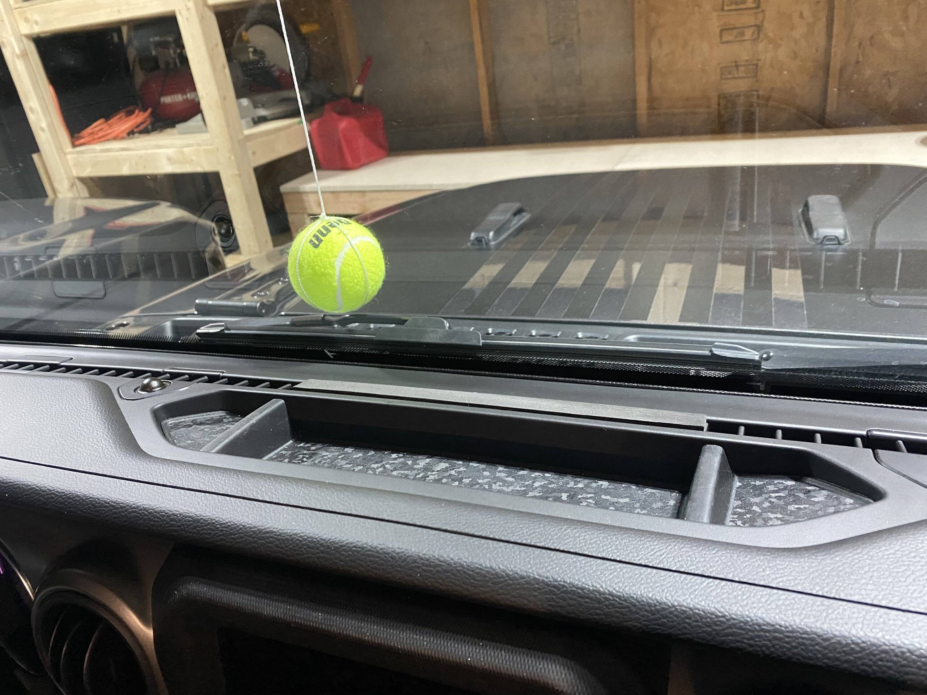

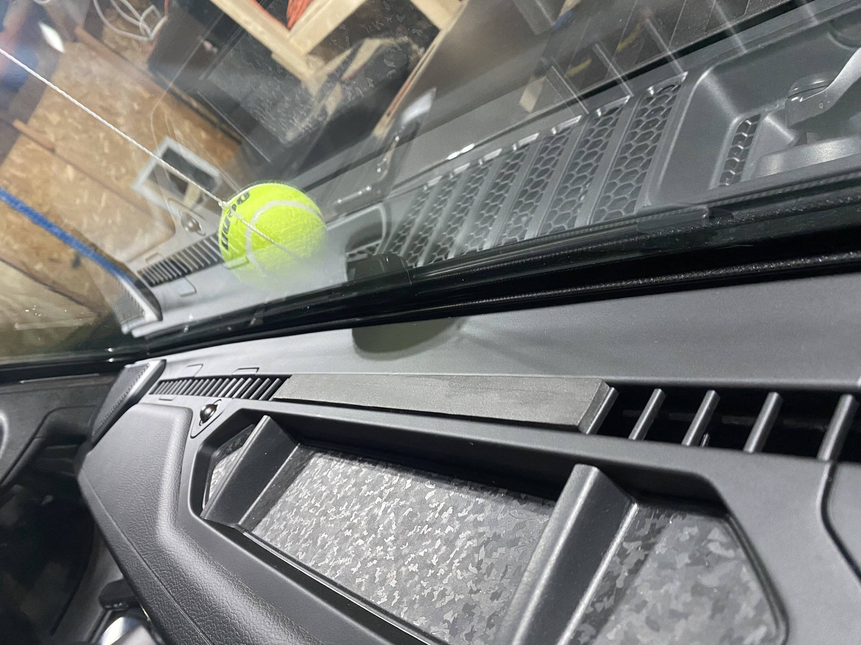

I'm unclear on where these go, so if you can post a picture?
Going back to the early days off the thread, the video posted by the father and son, it was 9 degrees and snowing.
When it's that cold and snowing I don't run the wipers at all and I only defog the windshield. The snow floats right off.
Hope these pictures help!

Back on topic: If I recall from reading this thread a while back, or maybe it was another thread, someone said that the squares they bought smelled bad when the defroster was on. The plugs may be made of vinyl or polyethylene. I assume vinyl ones would be smelly when hot. That may be the difference if no one else is complaining about it.

Also, please feel your Defrost vents when it is running. You get air out the left and right side or just the middle. Every gladiator I have Tested are all the same...just out the middle
I live in Northeast Ohio and my Gladiator defrosters only blow in the middle. My windshield wipers are always caked with ice and the outsides do not get any defrost action. I'm thinking of making a deflector or something to put up there but I'm not sure how that'll work. It's a safety issue on the way back between Youngstown, Ohio and Philadelphia. I went through 2 gallons of washer fluid and had to stop several times to clean off my blades

I had noticed this issue too with mine and though something was wrong.
The heat only blows through the middle third of the vent, even though theres alot of vent on both sides of the top of the dash that dont have air coming out. Seems like an issue Jeep should have addressed so it defrosts the entire windshield either by having some fins in the vents to direct the air to the sides, of blocking some of the vent in the middle (like the caps proposed earlier)
I don't think it is an issue that will lead to deaths, but it can be an issue limiting your already limited vision through the smaller windshield of the jeep. I do also think its something that shouldn't be an issue on a $50k+ vehicle.....

Actually, thanks for bumping this thread. I noticed the freezing up along the outside edges the other day, and kinda wondered why my new JT does this when my '21 didn't. This thread reminded me I put those plugs when it was brand new.
So I guess before I go out and clean last night's snow off to look, do the vents in the '24+ JL/JTs still use the same 5/8" plugs, or has the vent design changed at all with the rest of the dash?
