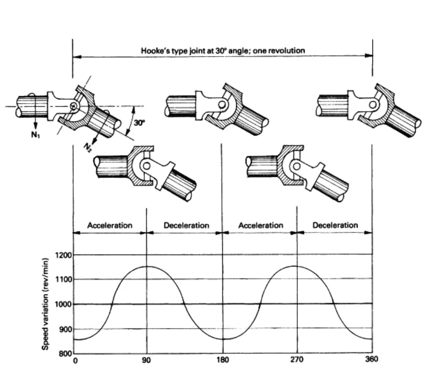

From one of my college books on drive trains, drive shafts, locating vibrations and so on - look at the RPM variations on the output end. That shaft is switching from 850-1150 each revolution - and back. Do that on both front wheels and it feels like it's trying to walk, surging.
Doesn't 30 degrees sort of match the turning angle when you go into a parking lot, parking space or driveway?
The front axles aren't turning nearly that fast but look at the ratio and drop that down to 10 rpm at the inner shaft - it's still wanting to go from 10 down to 8.5 rpm then back up to 11.5 rpm.

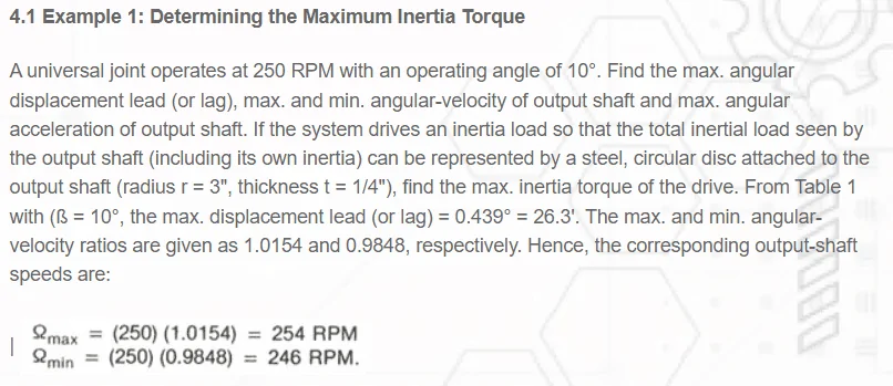

At an angle of only 10 degrees (which isn't all that much) here's the change in rotational velocity minimum and maximum - at only 10 degrees angle and a rotational speed of 250 rpm on the input side, the output (or wheel side) varies 4 rpm each way - enough to cause a wheel to want to "jump":

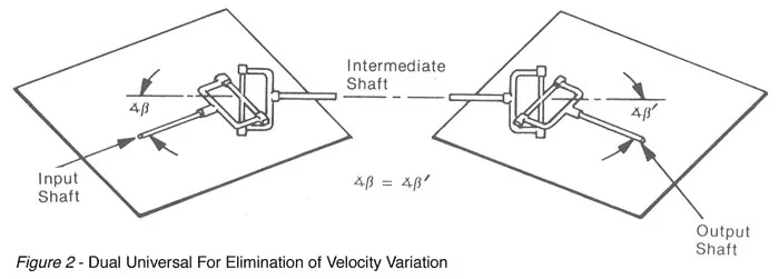

This is why drive shafts have two joints phased a certain way - to eleminate that change in angular velocity at the far end - the speed the shaft up at the front joint and the rear joint slows it back down, when the front joint slows the driveshaft down, the rear joint speeds it back up so the input speed or velocity matches the output at the far end even though the driveshaft itself is speeding and slowing the whole time.
