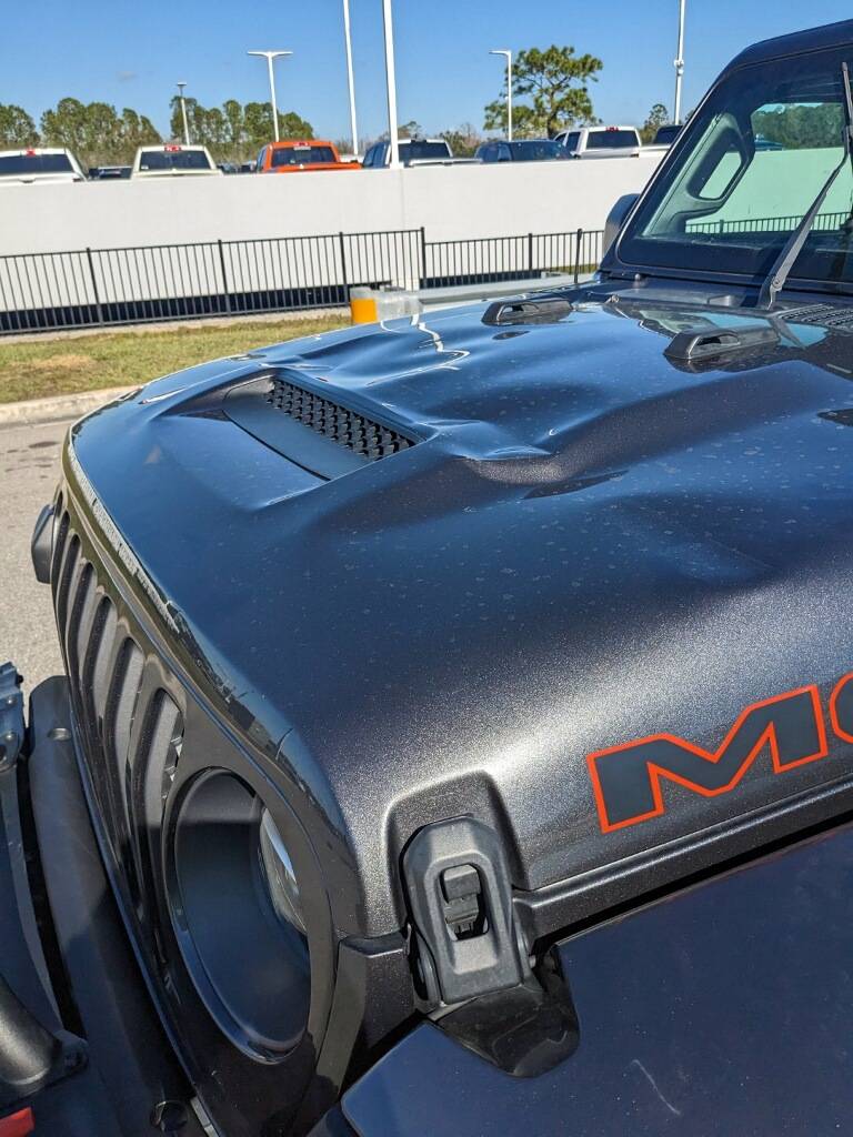

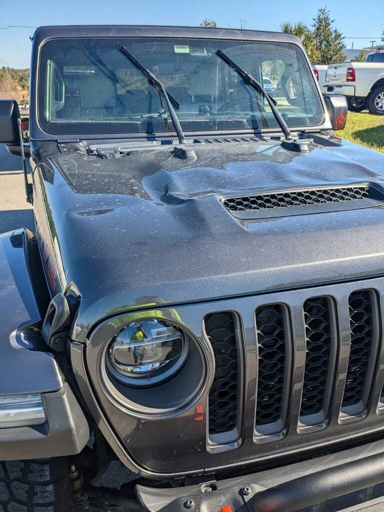

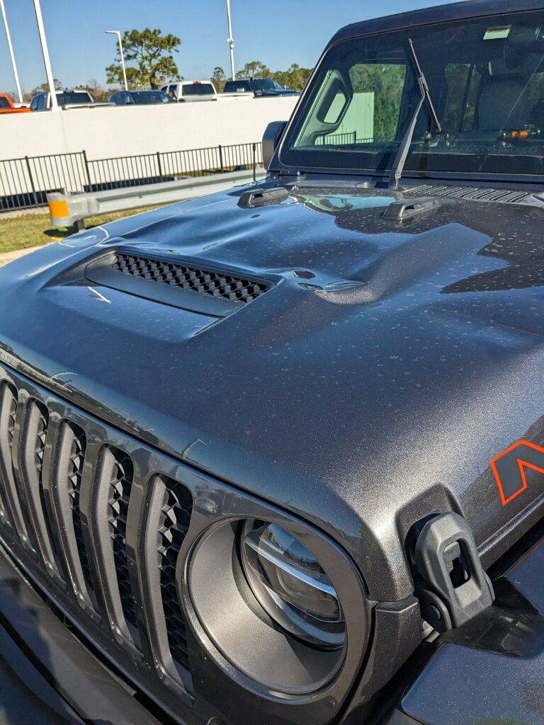

My wife and I went to check it out last night, and we figured out why the windshield survived. Because the aux battery was dying/dead, the wipers started moving on their own when we hooked the jump pack up to the truck. They stopped moving in basically a fully upright position (you can see in the pics in the first post). They basically acted like really serendipitous bumpstops when the hood flew open.
I'll be curious if the wipers themselves still work fine, but either way, the windshield thanks them for their sacrifice... :CWL:
