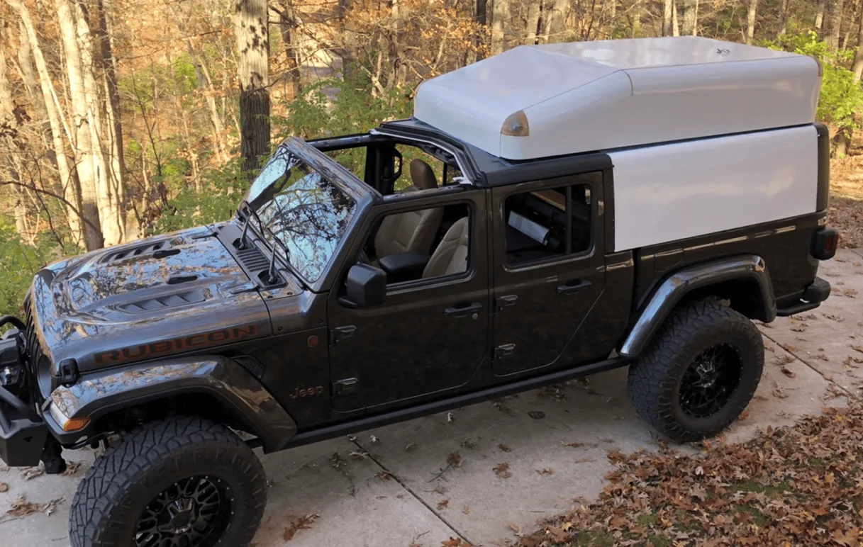

Mike I’ve had the gladiator for about 2 months and have installed an Alu Cab and now I’m starting the build out

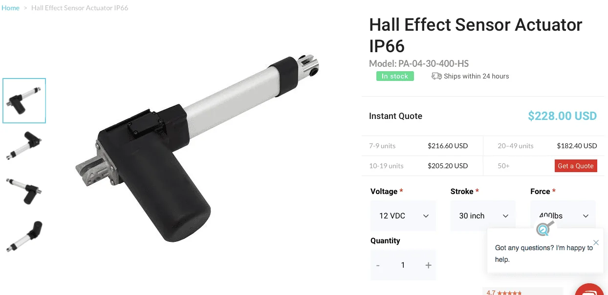

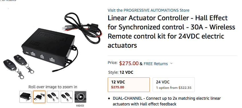

Here's a Hall effects synchronized linear actuator and control. These are overkill at 400 lbs each. I'm wondering if I can do the straight lift with just (2) actuators, since it's a pretty small top?? I could cheap out and get simple actuators, but they may not lift straight.
Jeep Gladiator Gladiator Expedition Rigs Screen Shot 2021-12-14 at 7.23.14 AM
Jeep Gladiator Gladiator Expedition Rigs Screen Shot 2021-12-13 at 6.01.45 PM

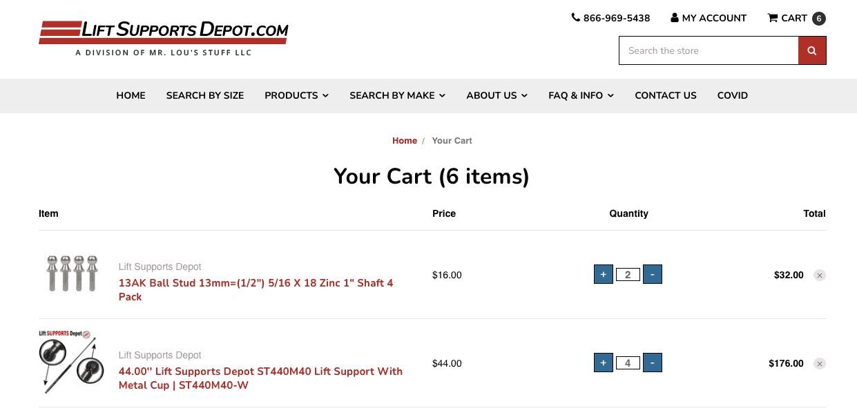

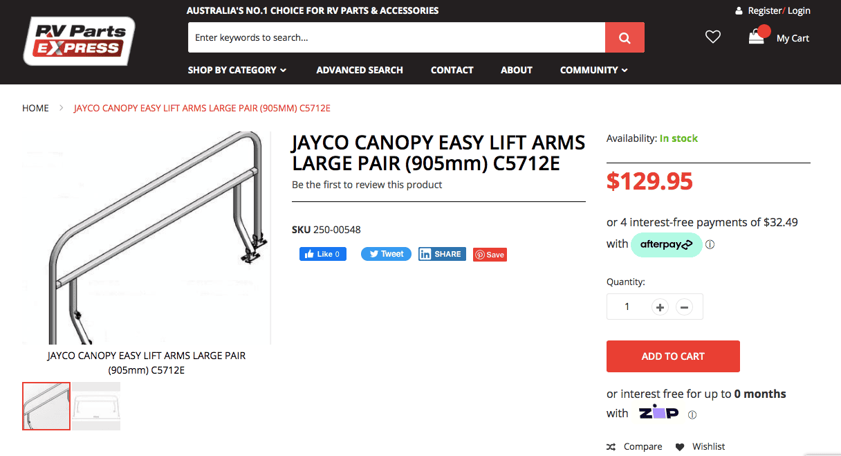

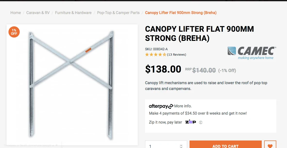

A couple more Australian lift systems. I haven't found a supplier for these in the US. Looks like England and Australia are ahead of North America when it comes to Pop Top Systems.
Jeep Gladiator Gladiator Expedition Rigs Screen Shot 2021-12-15 at 6.27.50 PM
Jeep Gladiator Gladiator Expedition Rigs Screen Shot 2021-12-15 at 6.02.28 PM

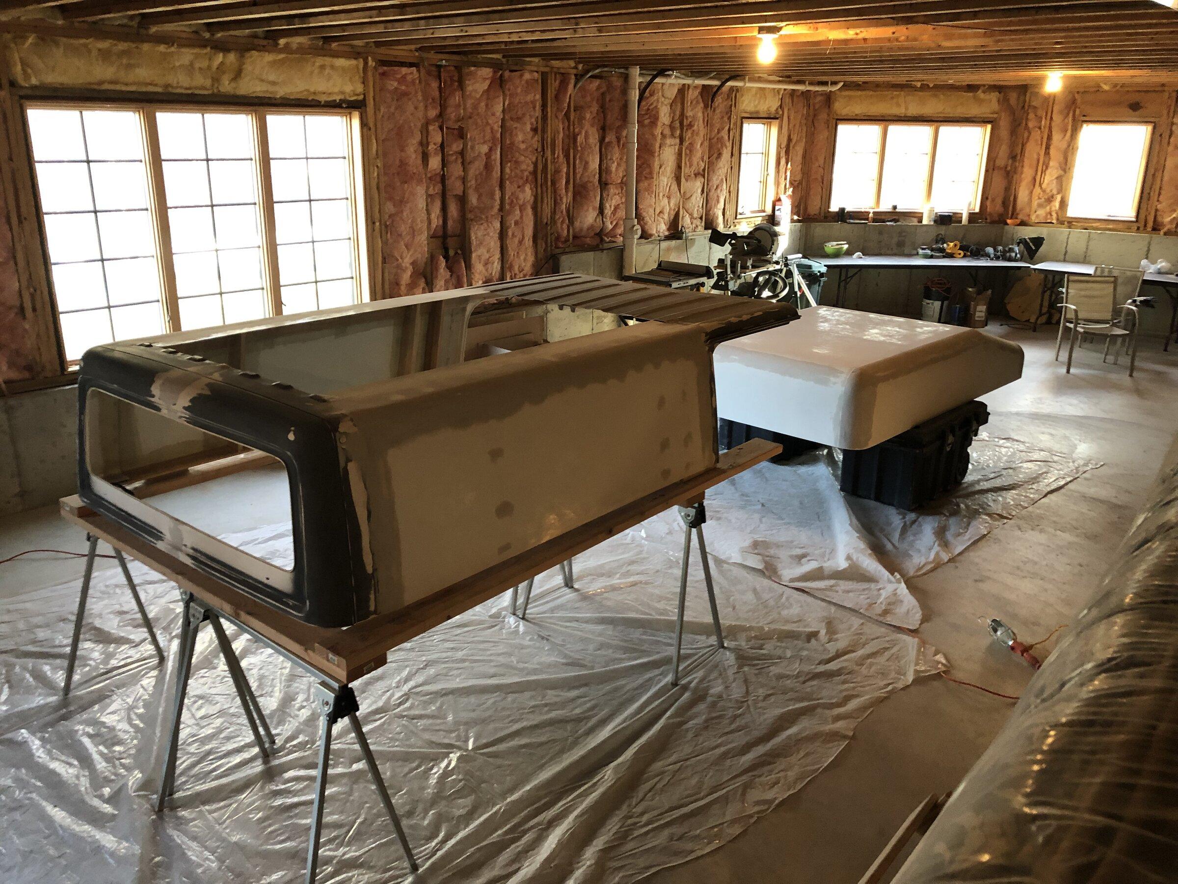

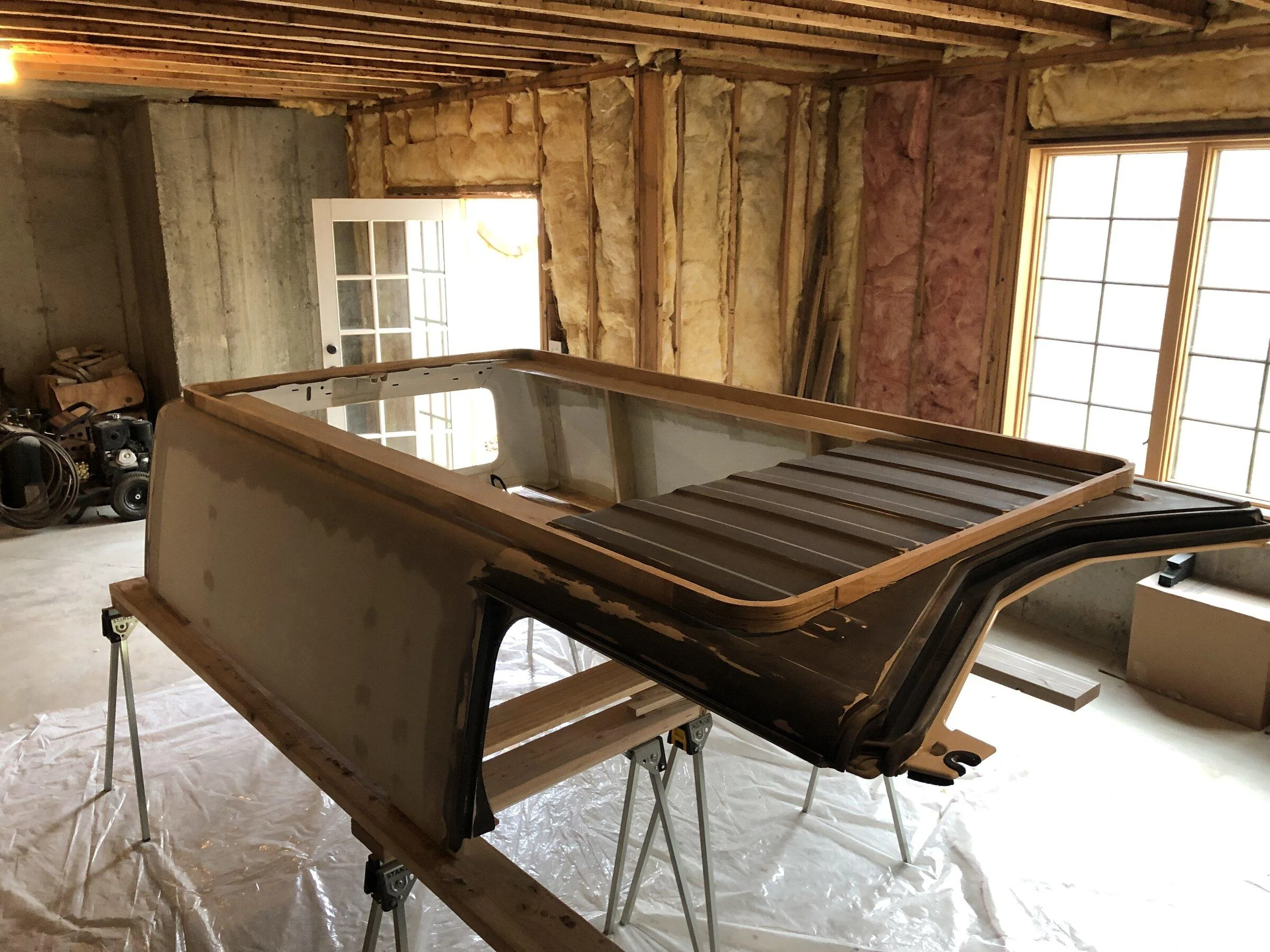

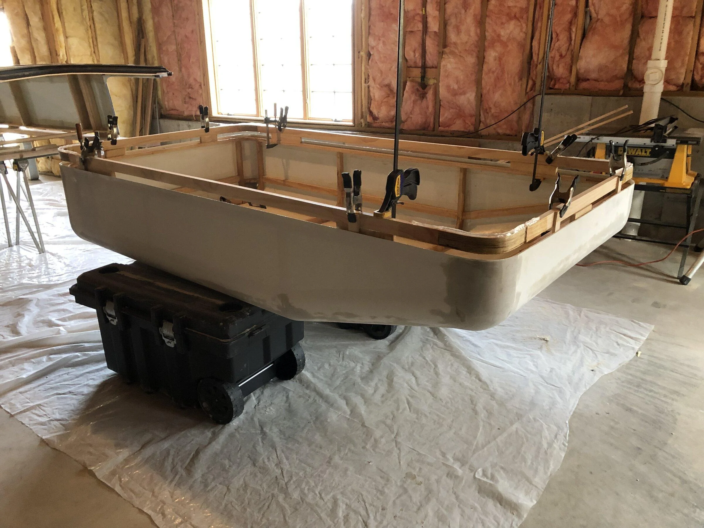

The bodywork is 90% done. Time to work on the top lift and then the back hatch.
Jeep Gladiator Gladiator Expedition Rigs 99F81F09-9B01-4324-B53F-80940B762A3C

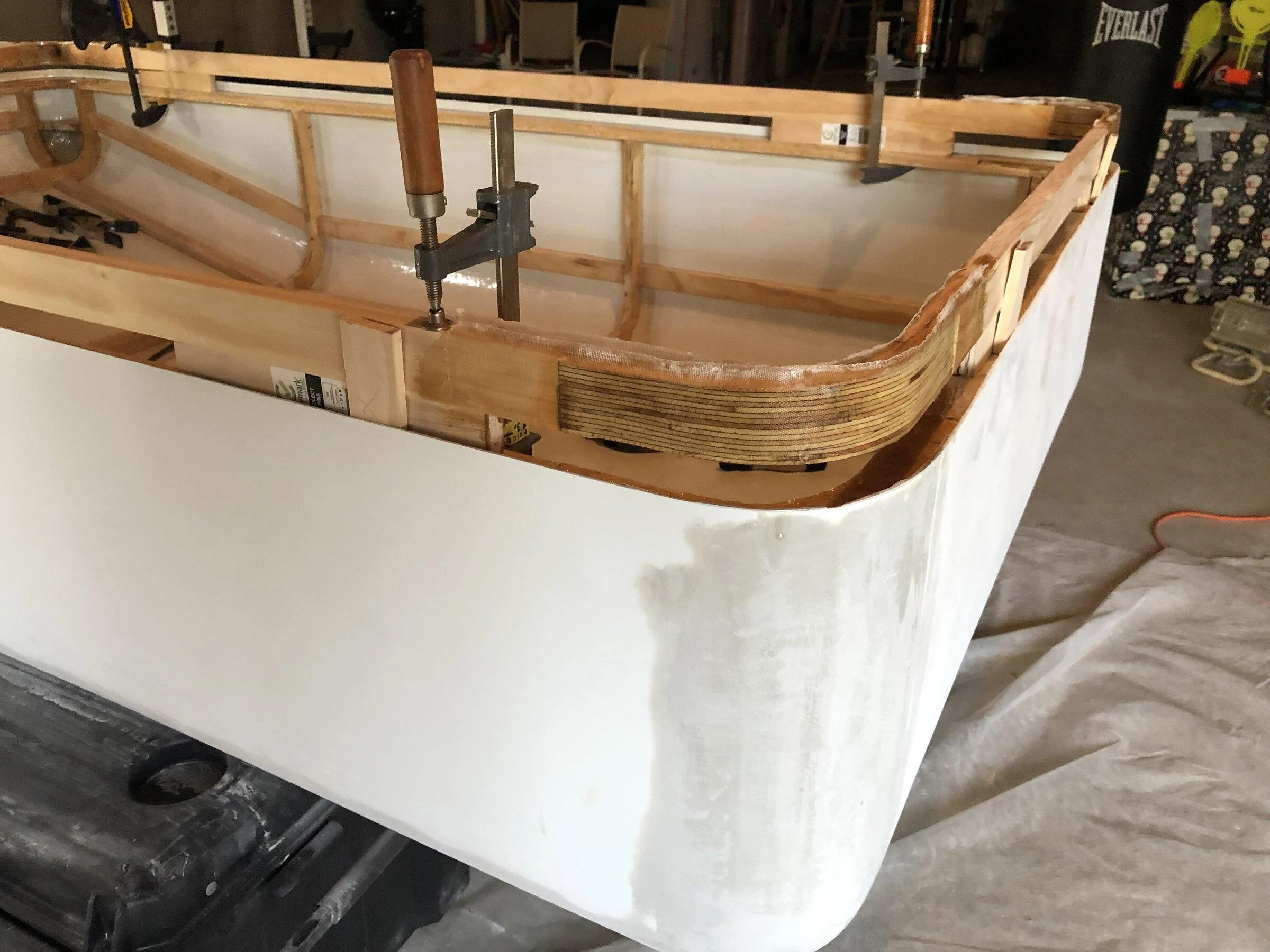

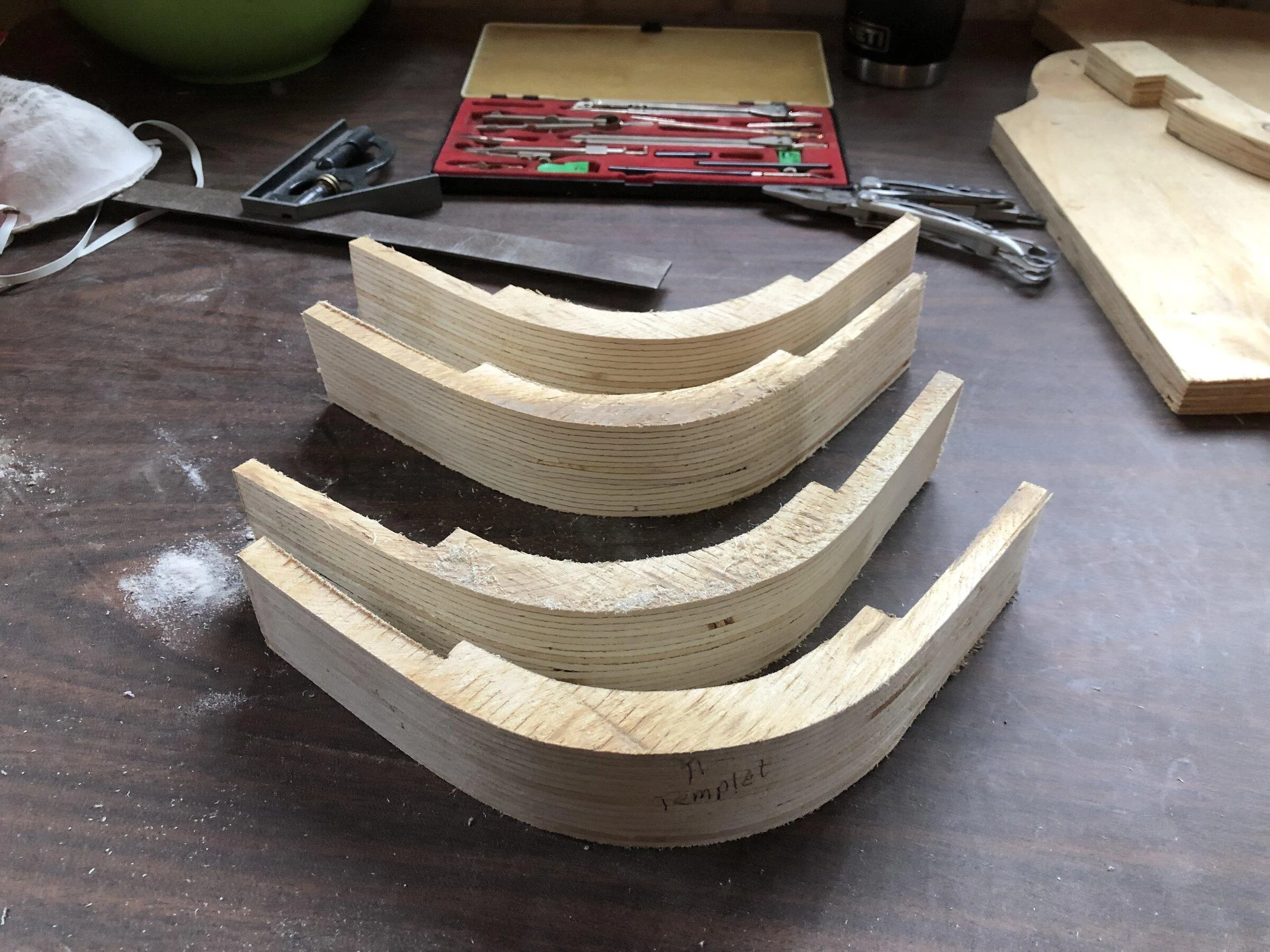

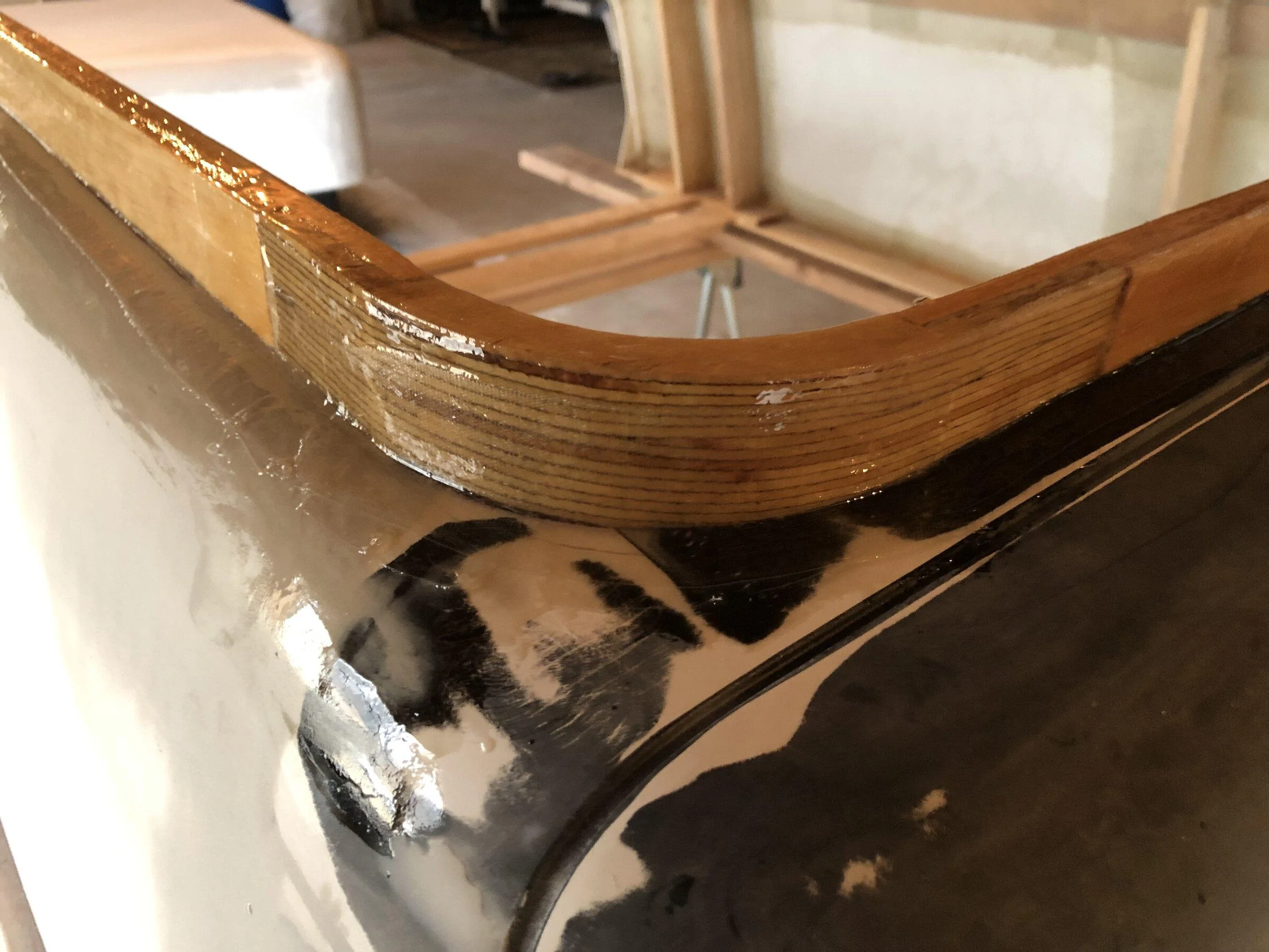

Making some curved corners for the transition between the two shells.
Jeep Gladiator Gladiator Expedition Rigs A10105BB-D2C1-4763-B835-772826389F39

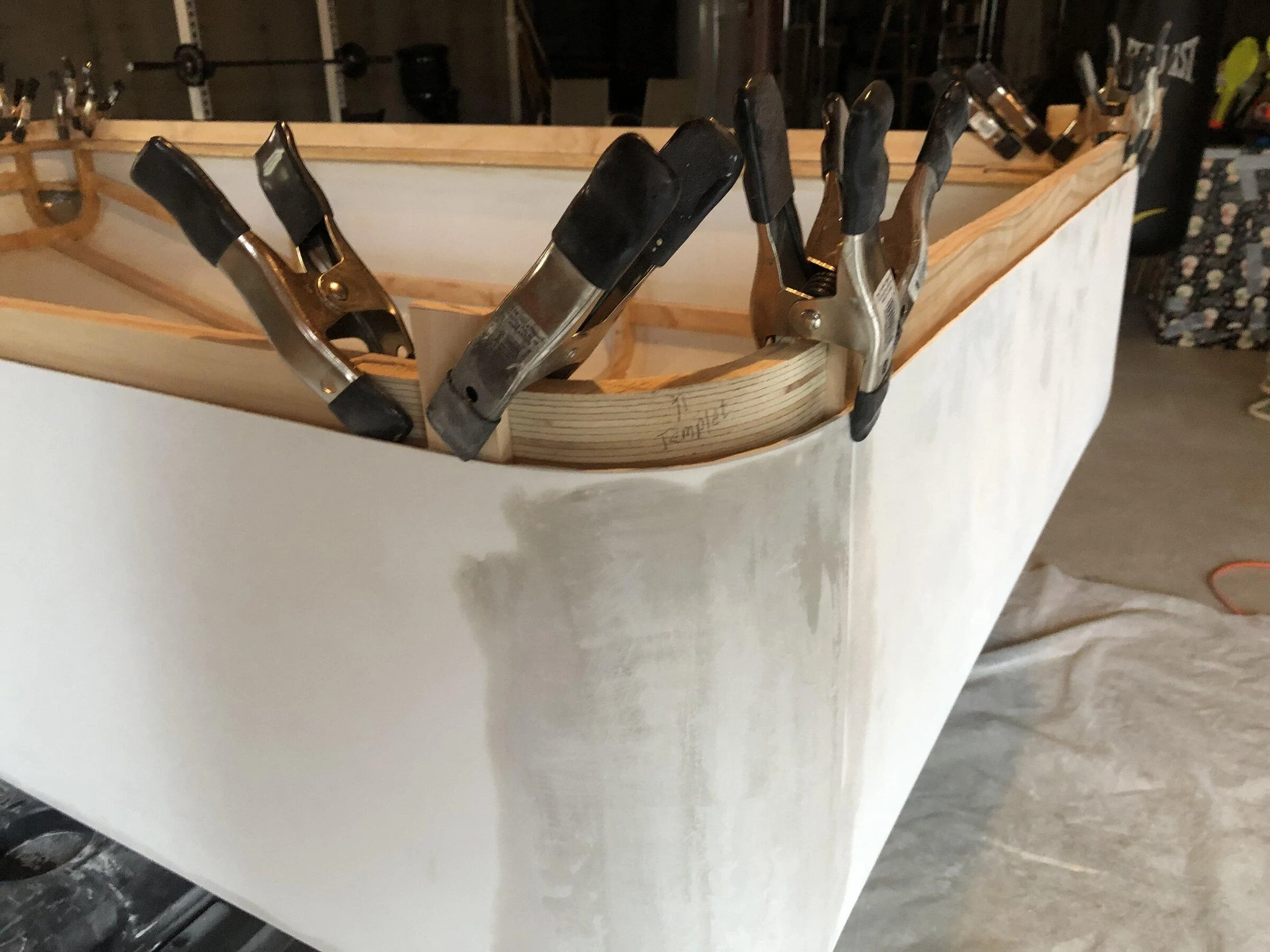

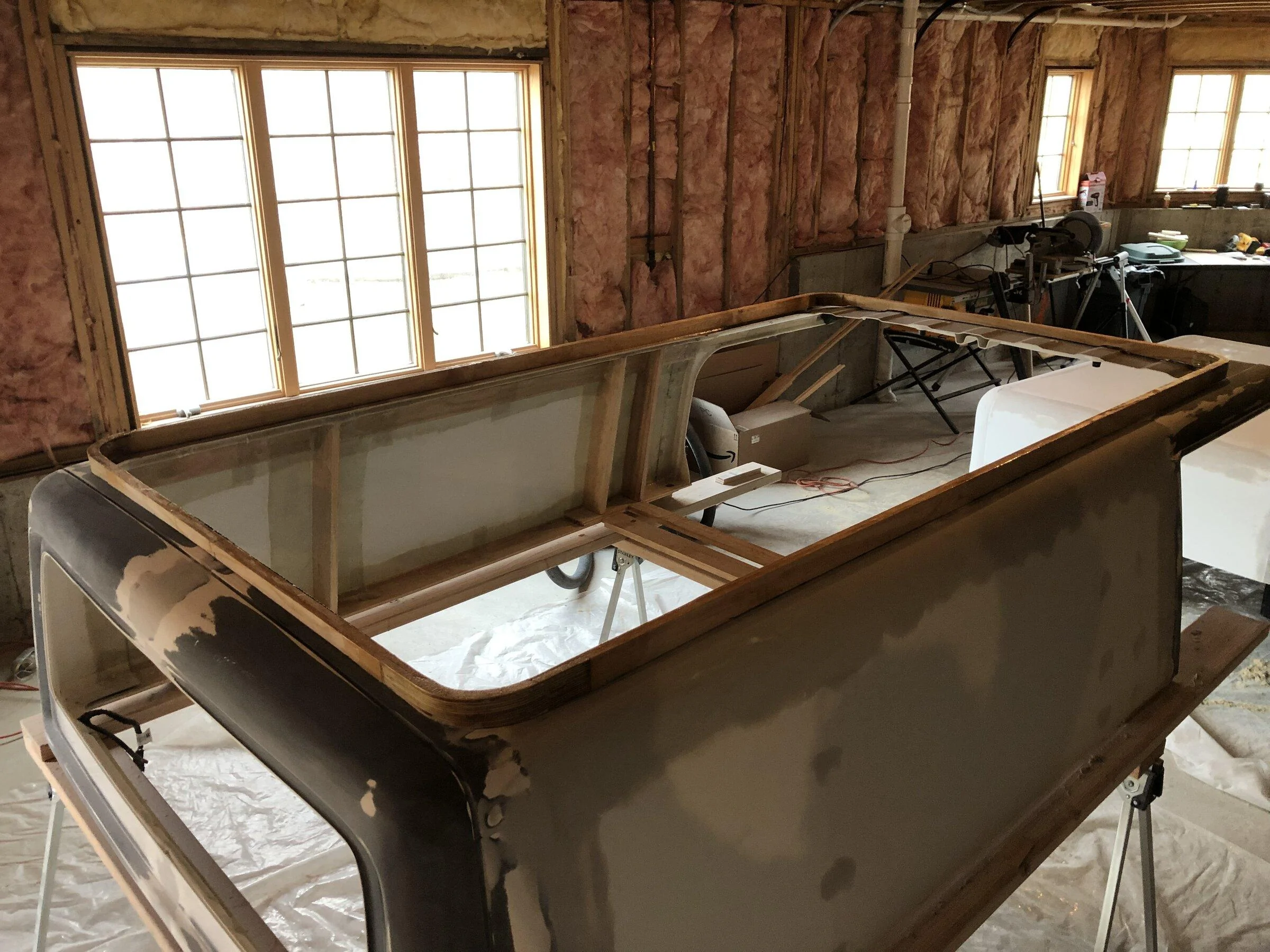

Now since the transition in on I can trim the inside opening. I left 6 inches in the front for additional strength since there isn’t much material there. I ran out of fiberglass tape so I'll have to wait to finish glassing the transition to the shell.
Jeep Gladiator Gladiator Expedition Rigs D9AF3E0B-488B-41E4-9B6A-192AD458B3E1

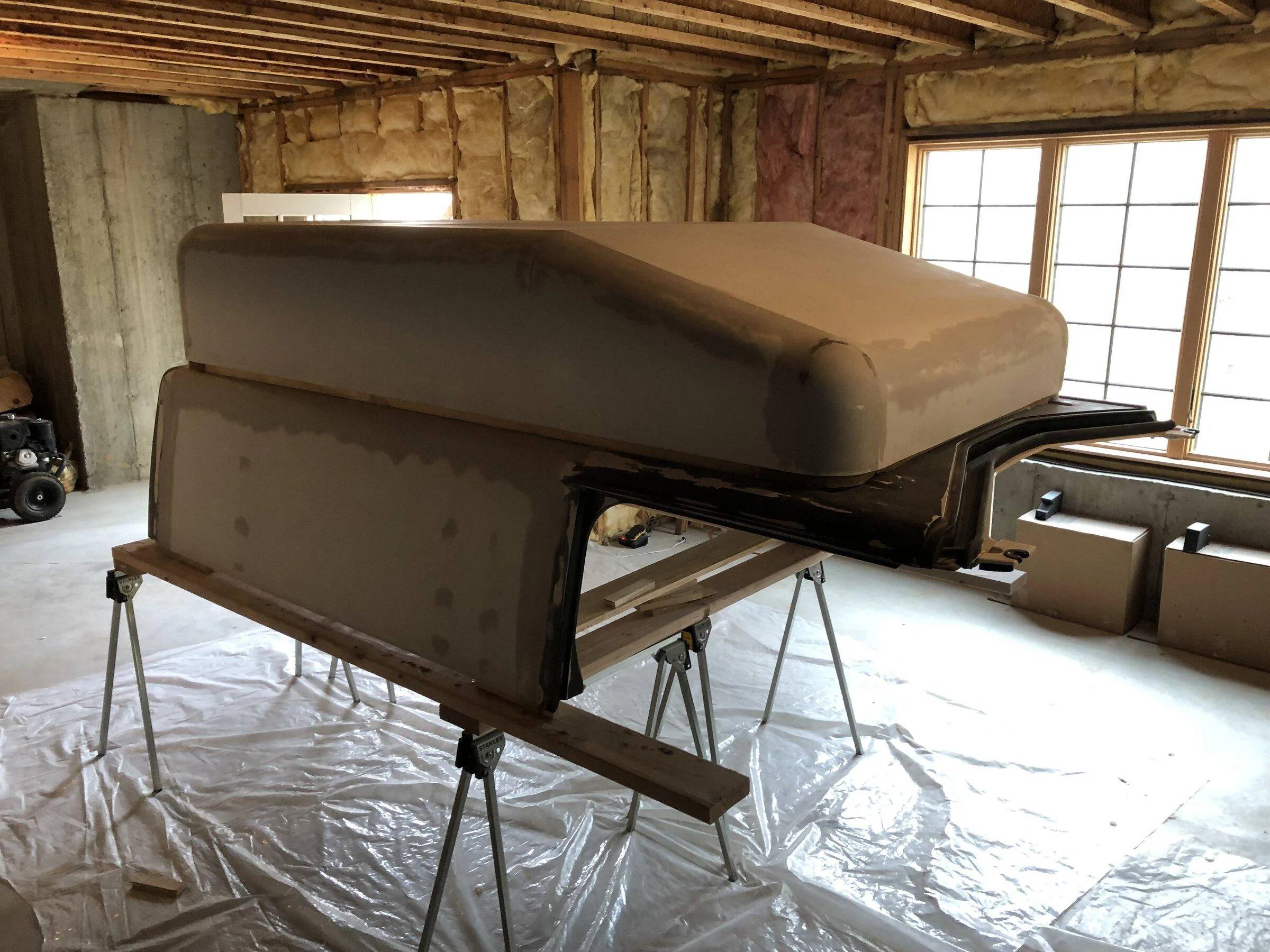

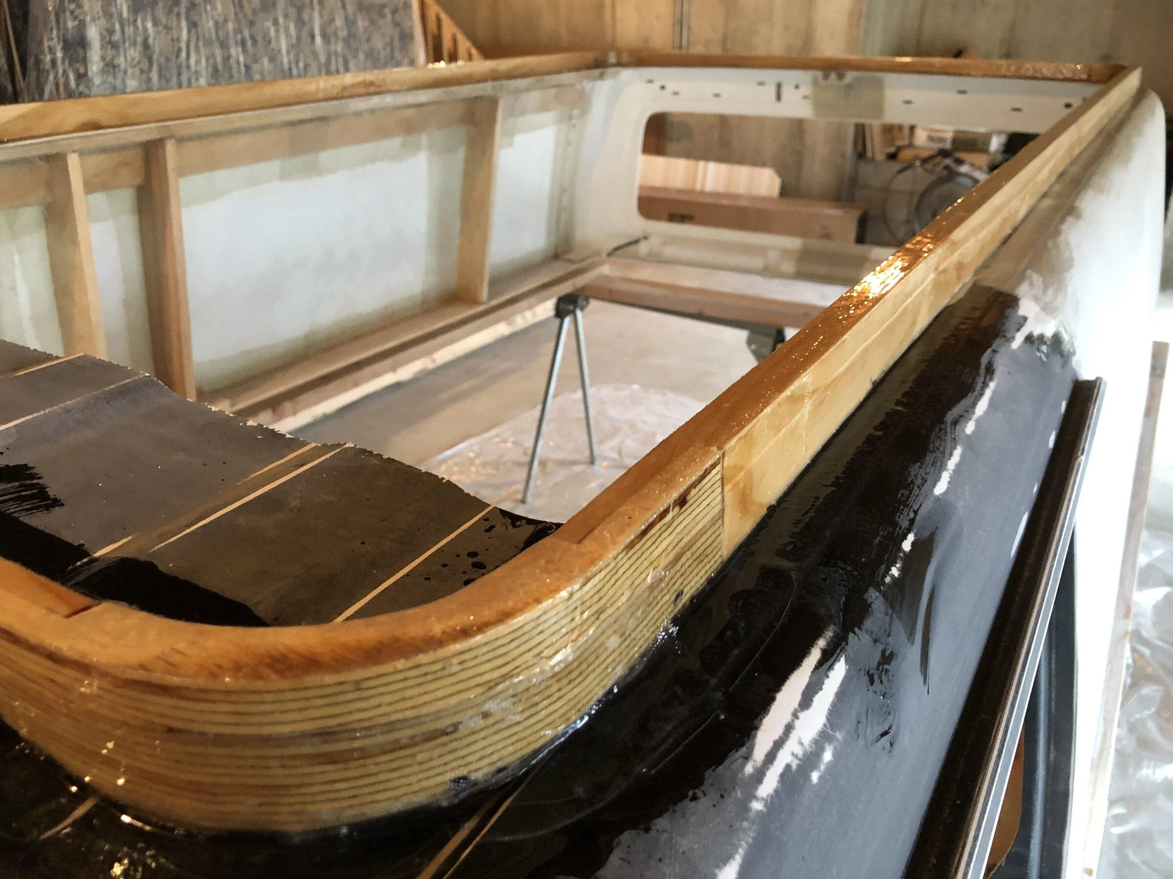

I’m fiberglassing the transition to the shell. It looks rough now but will be seemless before paint.
Jeep Gladiator Gladiator Expedition Rigs AC3E91E1-DE7C-4E44-853B-758F001B3631
Jeep Gladiator Gladiator Expedition Rigs 08452737-AAE7-49BB-876A-C86DE3B6FE79
