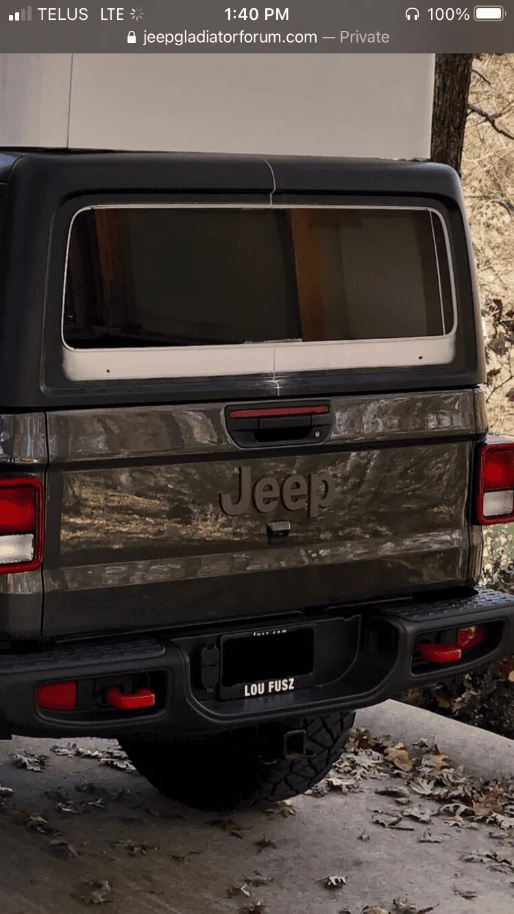

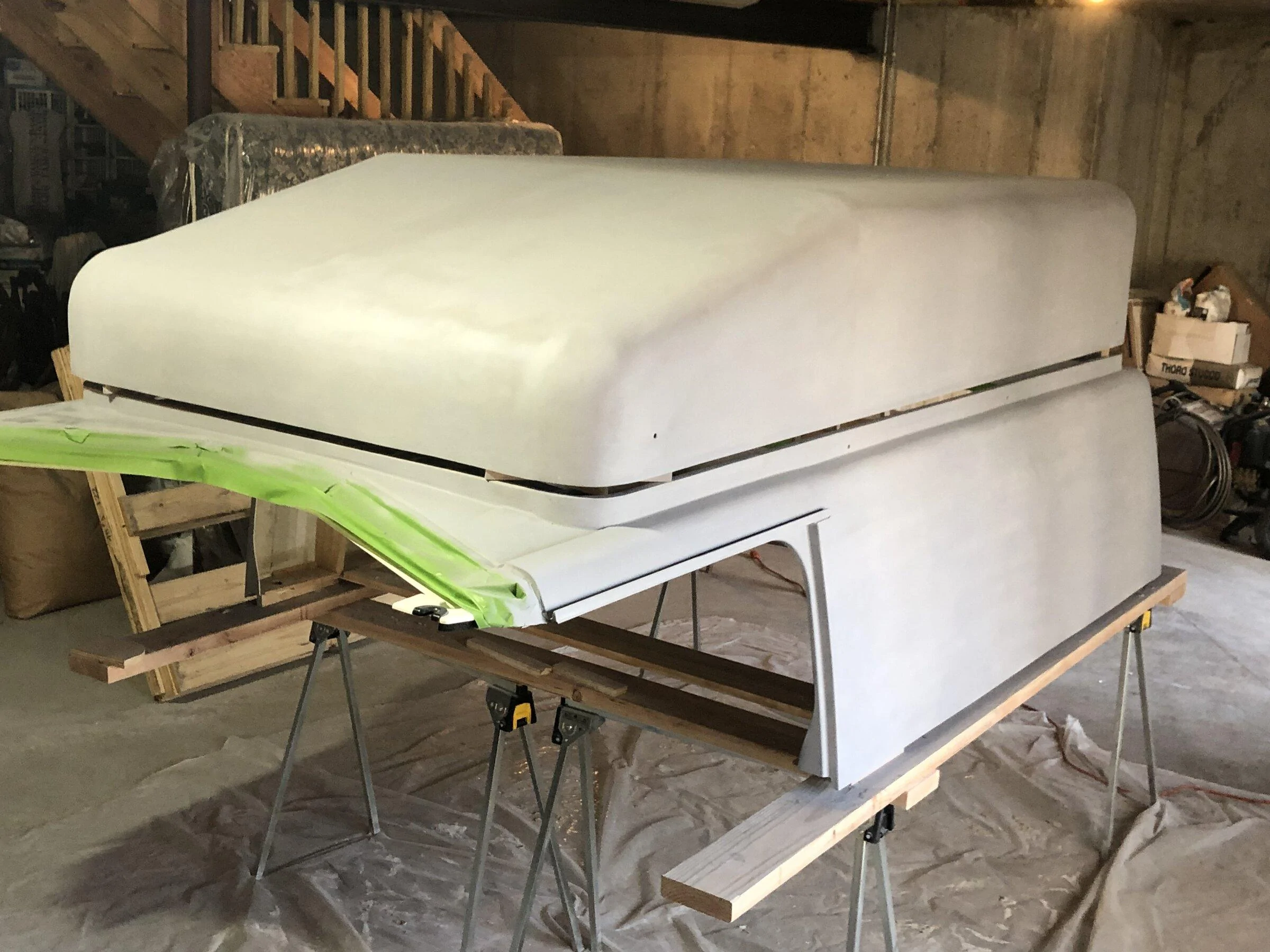

Looking good! For a second I thought you had a woodland camo wrap on your tailgate.....that is some crazy polished paint right there ?Here's a view of the back. Building the hatchback will be a bit tricky. I made the back of the shell narrower to fit the bed and can't use a stock Gladiator rear window. My plan is to use 3/16" or 1/4" Acrylic (plexiglass). Polycarbonate (Lexan) is stronger and easier to cut and drill but will yellow with time. The tricky part will be making a slight bend in the window, since it is not flat, and making it thick enough and not flimsy. It will have hinges, pneumatic struts, and probably a latch on each side.
