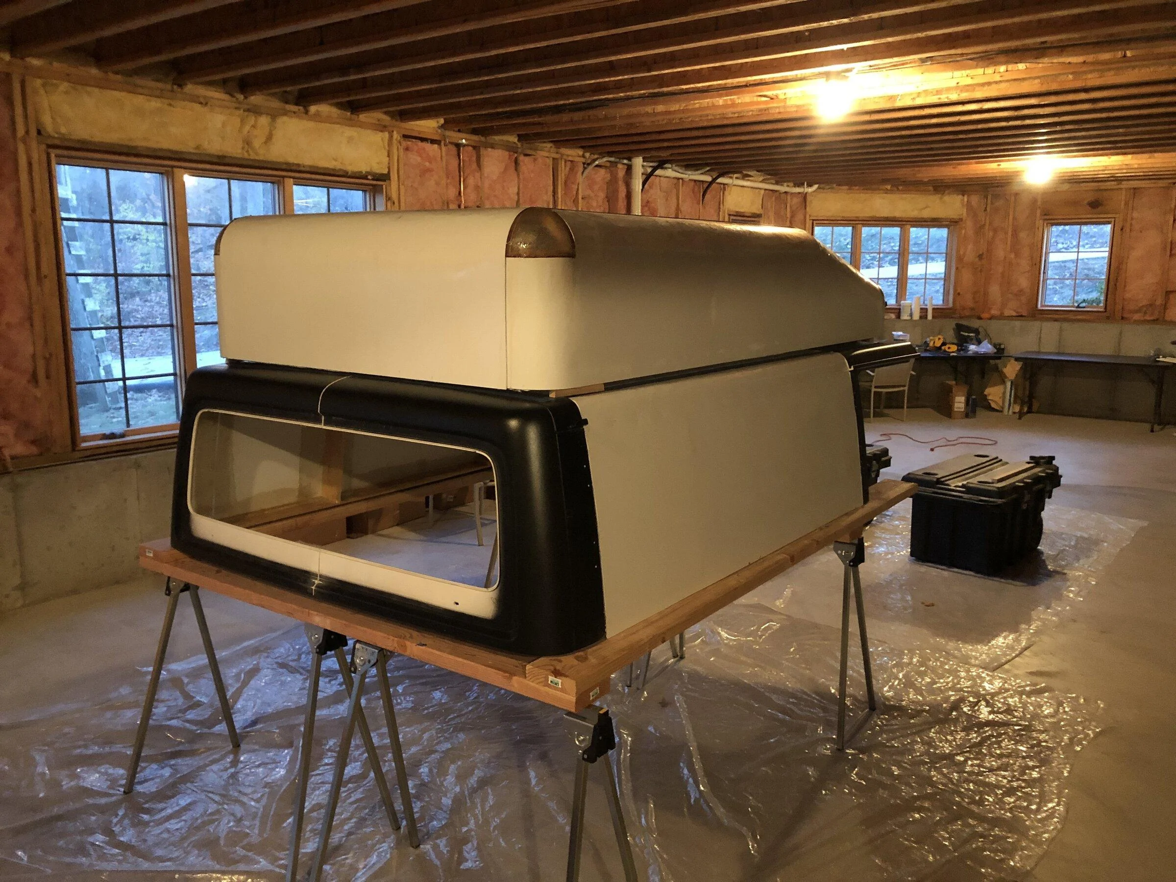

One nice things about this camper is that its small and light enough to fit through a 3' door. My son and I can separate it and move it to the basement. Pretty nice feature since my garage is full. Now I have a warm place to work and store it.

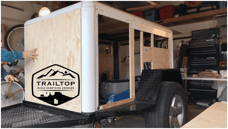

Another forum gave me a good pointer for those of you wanting to build your own camper. These fiberglass edges and corners might have saved me a lot of time building the upper shell. It looks well thought out.

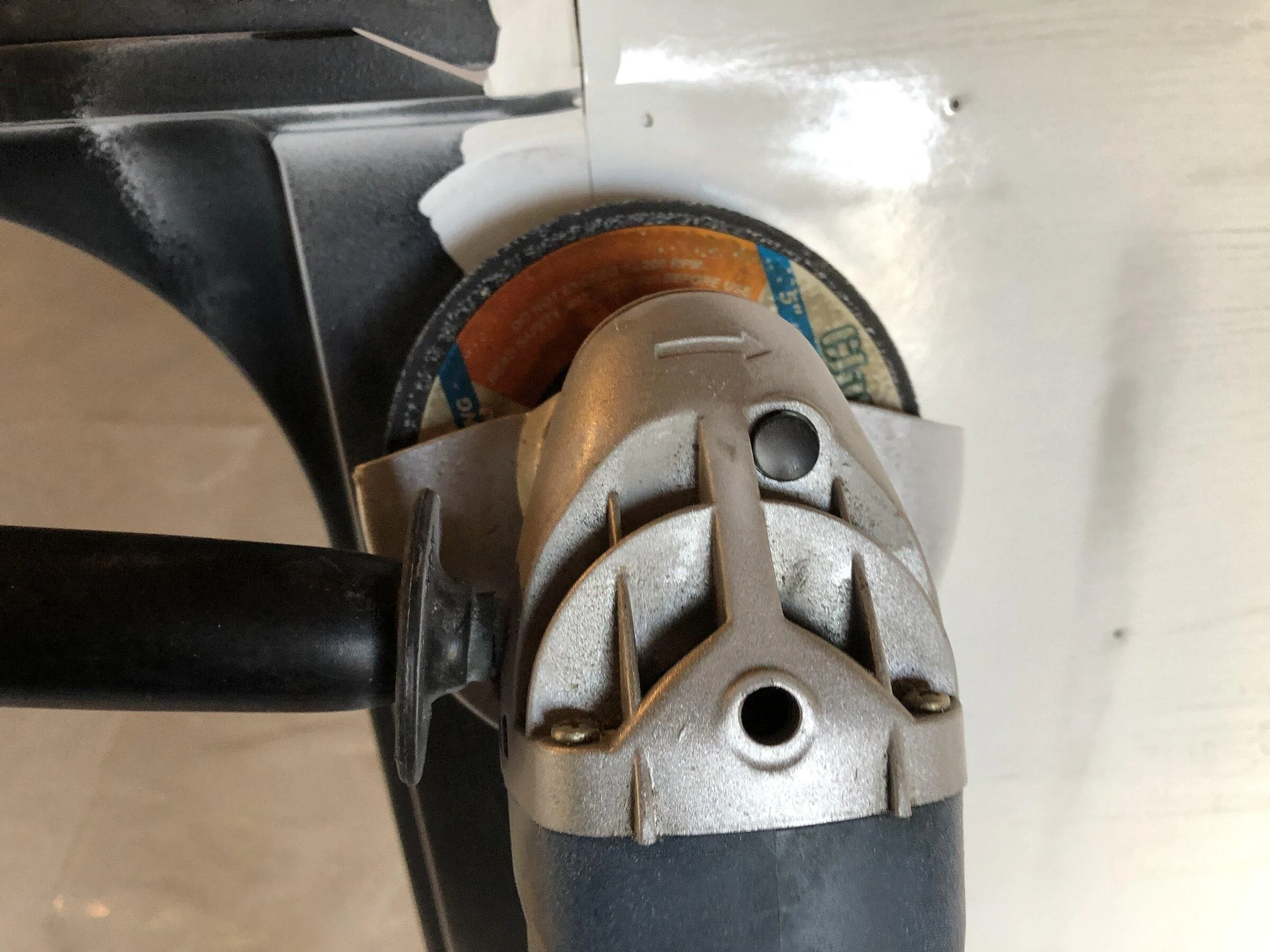

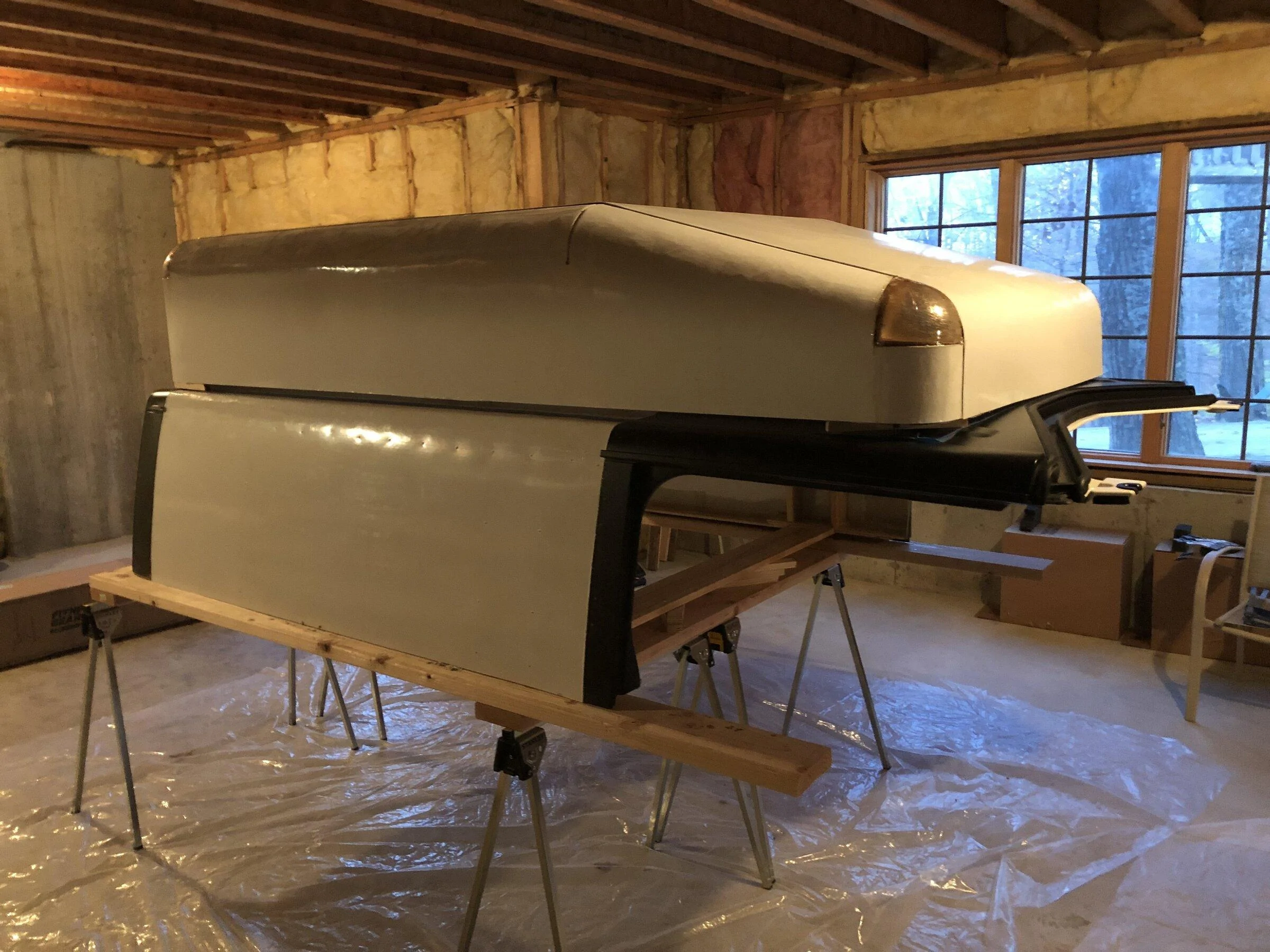

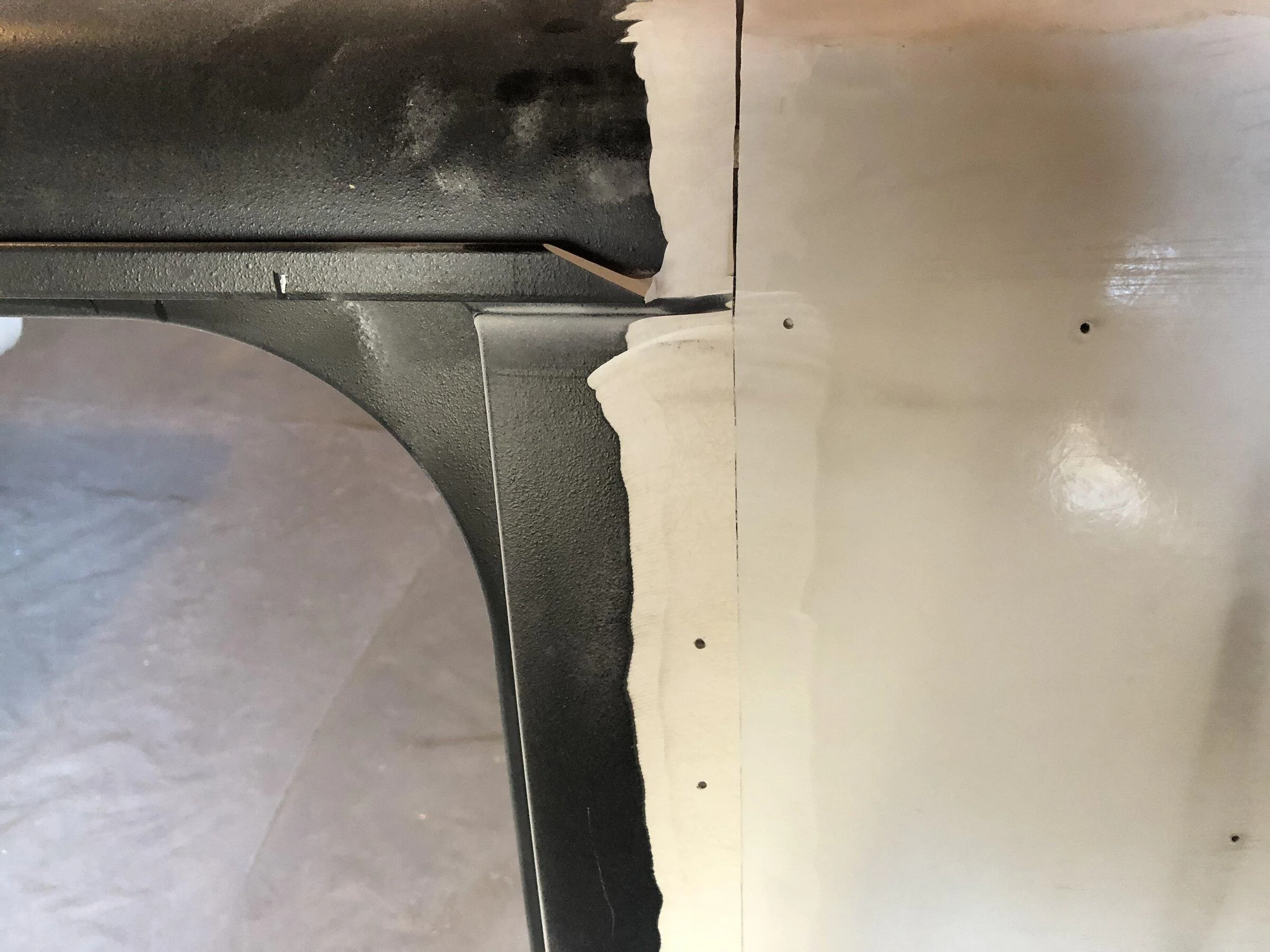

To strengthen the seams, I'm fiberglassing both the inside and outside seams. You need to grind down the seam and fill with a couple layers of fiberglass and resin. After this, I'll sand down the entire shell, fill holes and seams with bondo, repeat, and it will be ready for primer.

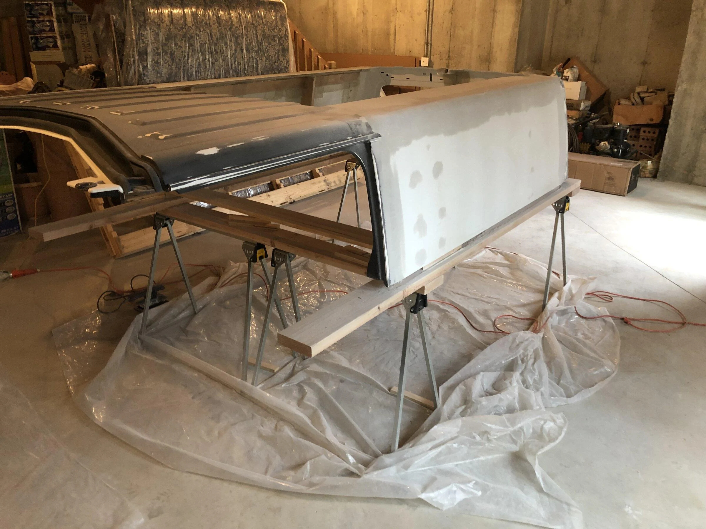

Glassed the seams, sanded the whole shell, bondo'ed it, and ran out of sand paper. Next weekend, round two of bondo/sanding. Wish I didn't have all the dimples from the screws I used to hold the skin down.

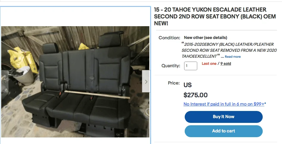

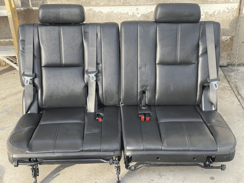

Here's some more potential camper seating ideas, and I think they'll fit lengthwise (58" & 54" long) in the bed. Upholstering custom seating is expensive, and these are cheap, plentiful on eBay, and even come in leather. Boy those Yukon seats would look good, but I'll be giving up a lot of under seat storage.
Jeep Gladiator Gladiator Expedition Rigs Screen Shot 2021-12-07 at 3.30.35 PM
Yukon third row seats might be better since they are shorter (49" long) and thinner. Looks like the seat belts are also attached.

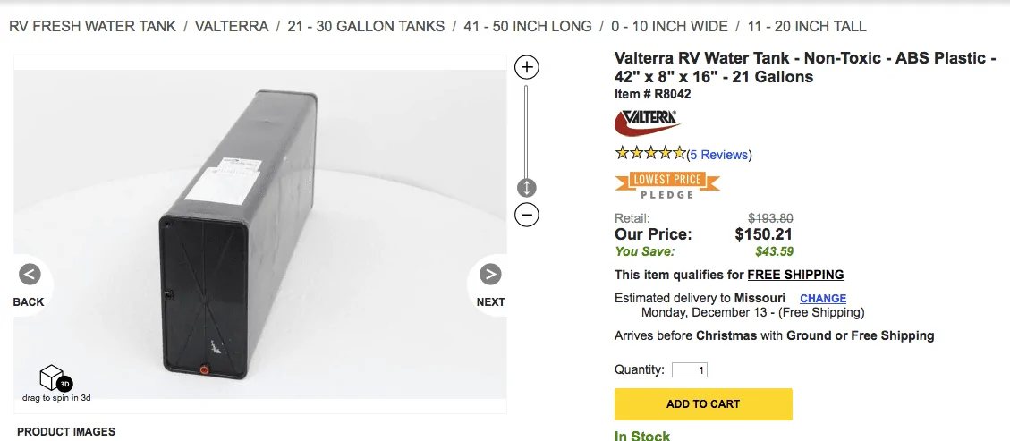

Here's a perfect size water tank that would fit on the front wall of the truck bed and fit under my seats, in case I go built in instead of jerry cans.
Jeep Gladiator Gladiator Expedition Rigs Screen Shot 2021-12-10 at 5.53.23 PM
