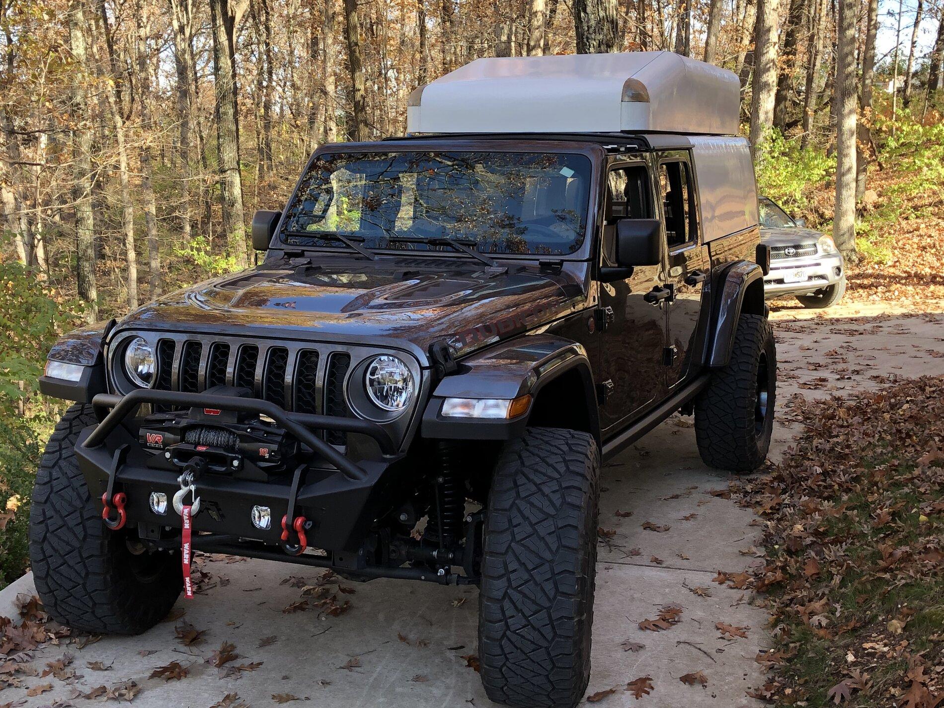

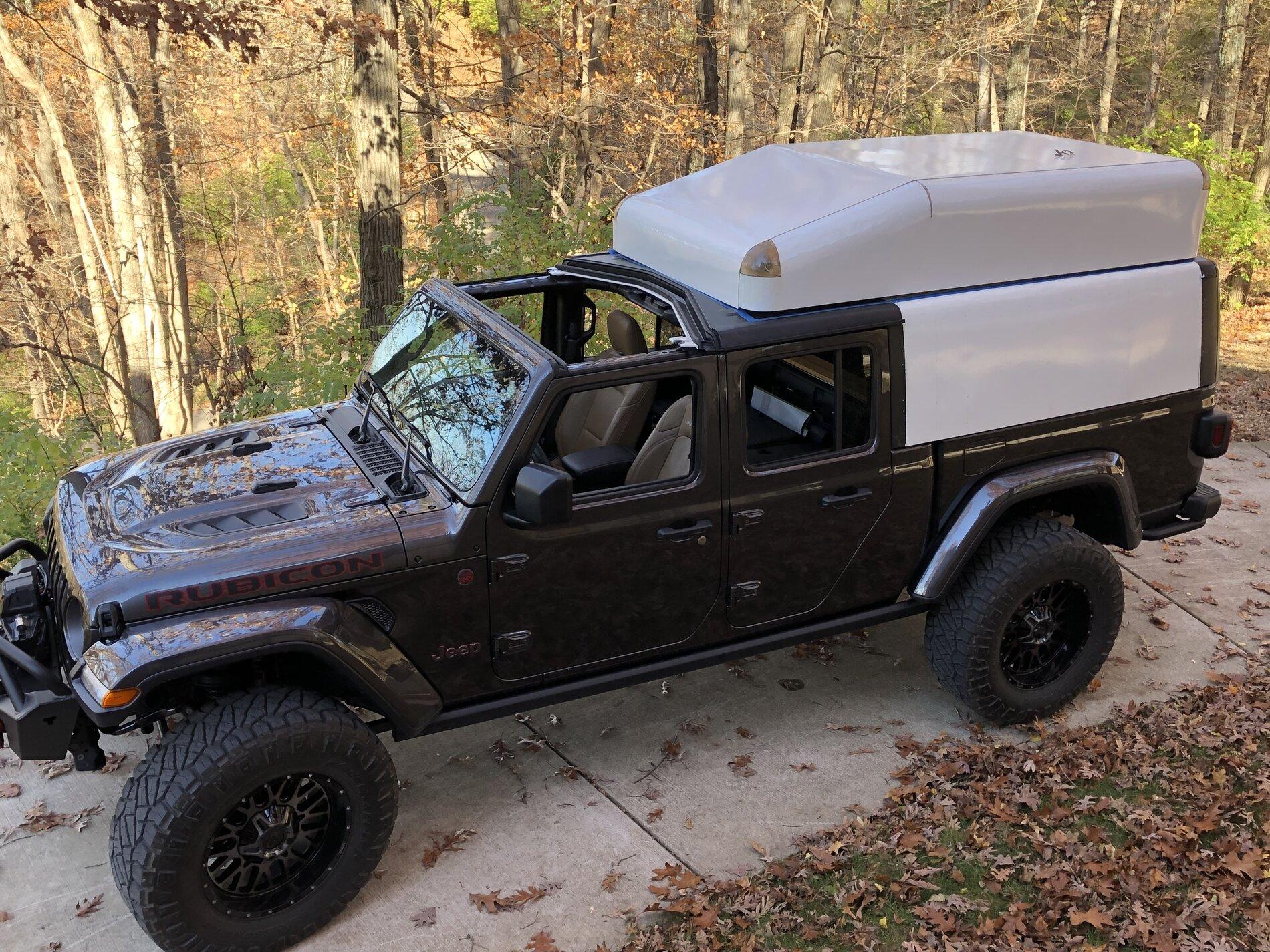

Beautiful day to test fit the camper.

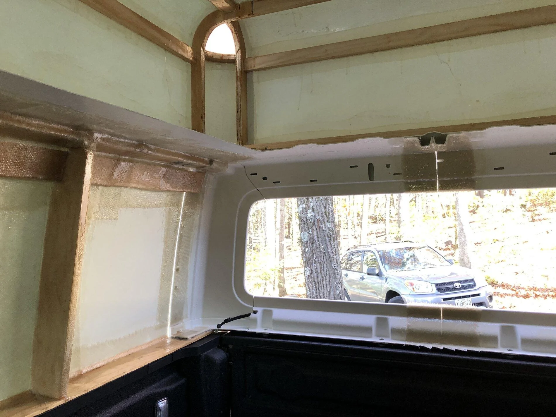

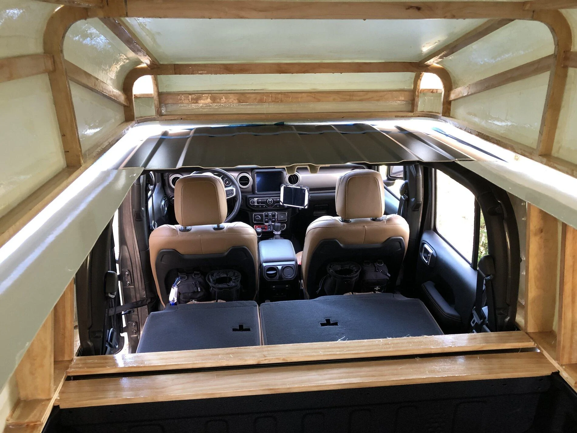

I'm 6'2" and I sat inside with plenty of headroom. I can walk around (bent over) inside with the top down. It won't fit in my garage, but I can make another low top to switch out for around town mod. Still a lot of body work, painting, insulating, and trimming out the inside yet.

Still need to trim the top and bottom fiberglass to match, but it will be pretty open inside when done.

Maybe i missed the issue of the bed flexing differently then the cab. Is that a issue? Looks good overall.
It indeed is an issue, not sure how big of an issue, but the outcome is not optimal when you for instance mount an awning on a shell and the rear roof...
Unless one doing extreme off roading I suspect it will be fine...

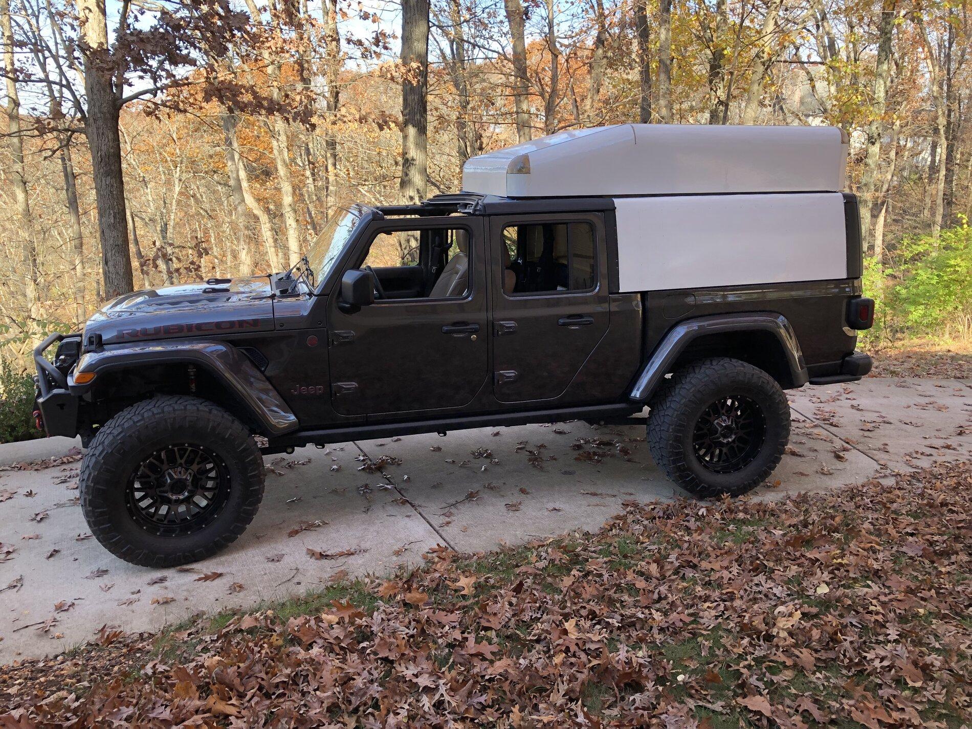

Here’s another of the profile.
Pertaining to bed flex I've been pretty quiet about my real plan.
Plan A) I'm designing in an allowance for 1/2" of flex between the cab and bed. The biggest risk will be if I flex more than 1/2", I will bend and possibly snap off the fiberglass bolt retainers. A good engineering rule of thumb is to design in a controllable weak point. It will break before damaging the entire structure. It's something like shear pins used with tractors.
Plan B) If the 1/2" allowance isn't enough, I designed in an area to cut the cap in half. There would be an accordion rubber gasket between the cab and bed area of the lower shell. I'm optimistic that plan A will work, but plan B is there just in case.
How are you planning on attaching the topper? Through bolting through the bed rails? C-Clamps like a typical truck topper?
Any insight on how you're planning on designing in the allowance for the flex? Slotting the mounting holes?
