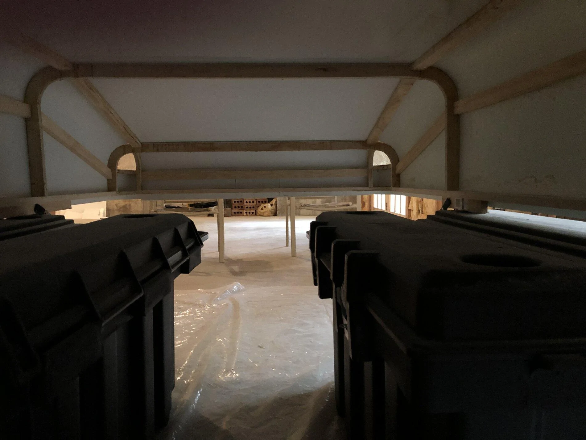

The conversation about heating the camper has now spilled over to insulating the build. The better insulated, the less heating I will need. The wood ribs on the build, give me great areas to insulate the walls and roof. The next question is spray foam, foam roll or panels, thermo fill blankets, or good old fiberglass (blah). Here's a good video that shows spray foam, peal and stick, and blankets along with pricing and difficulty. I haven't decided yet.

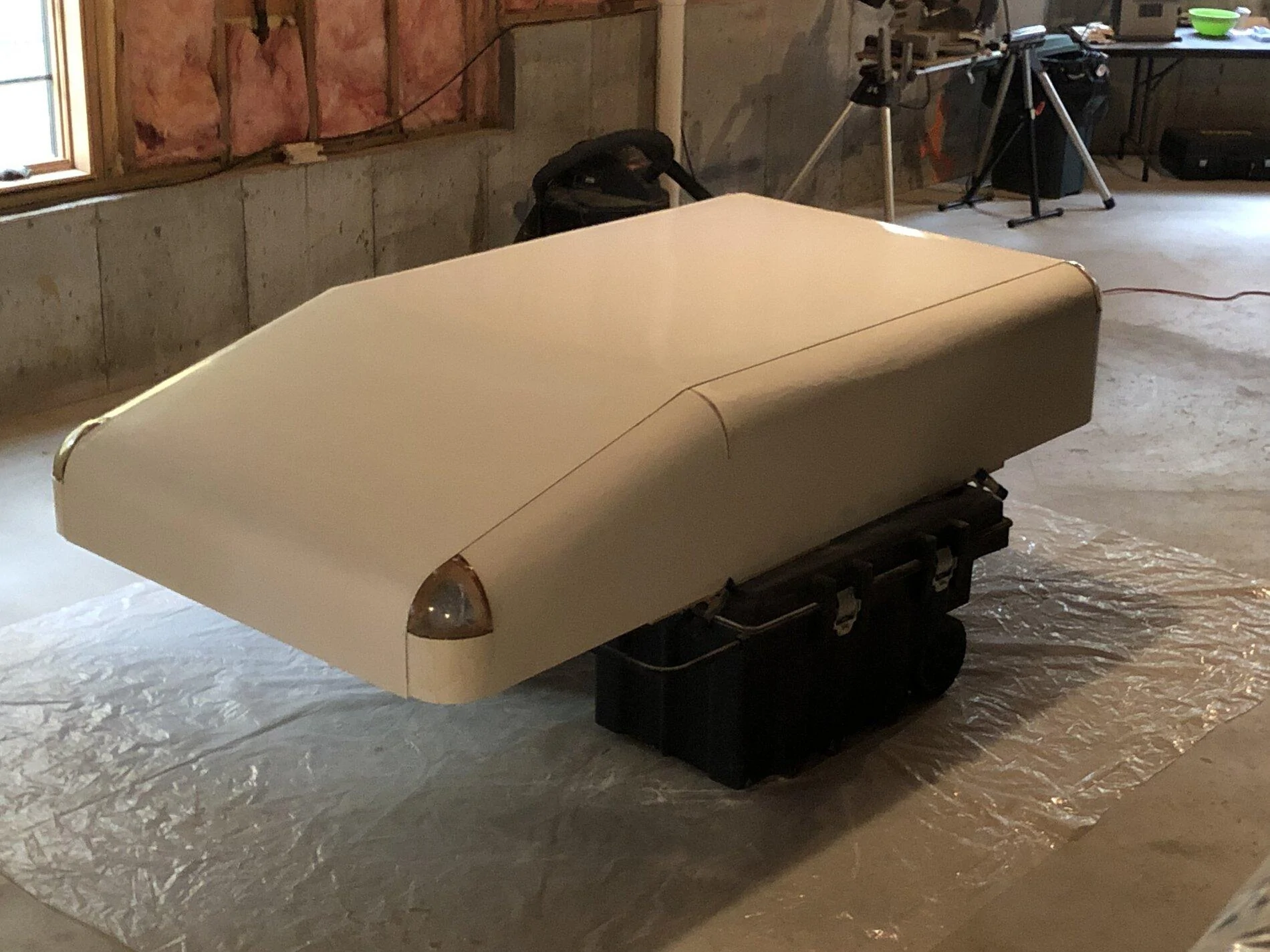

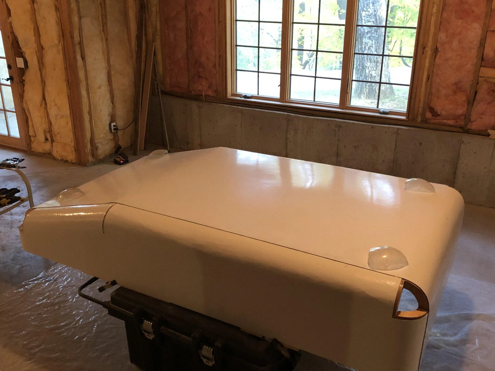

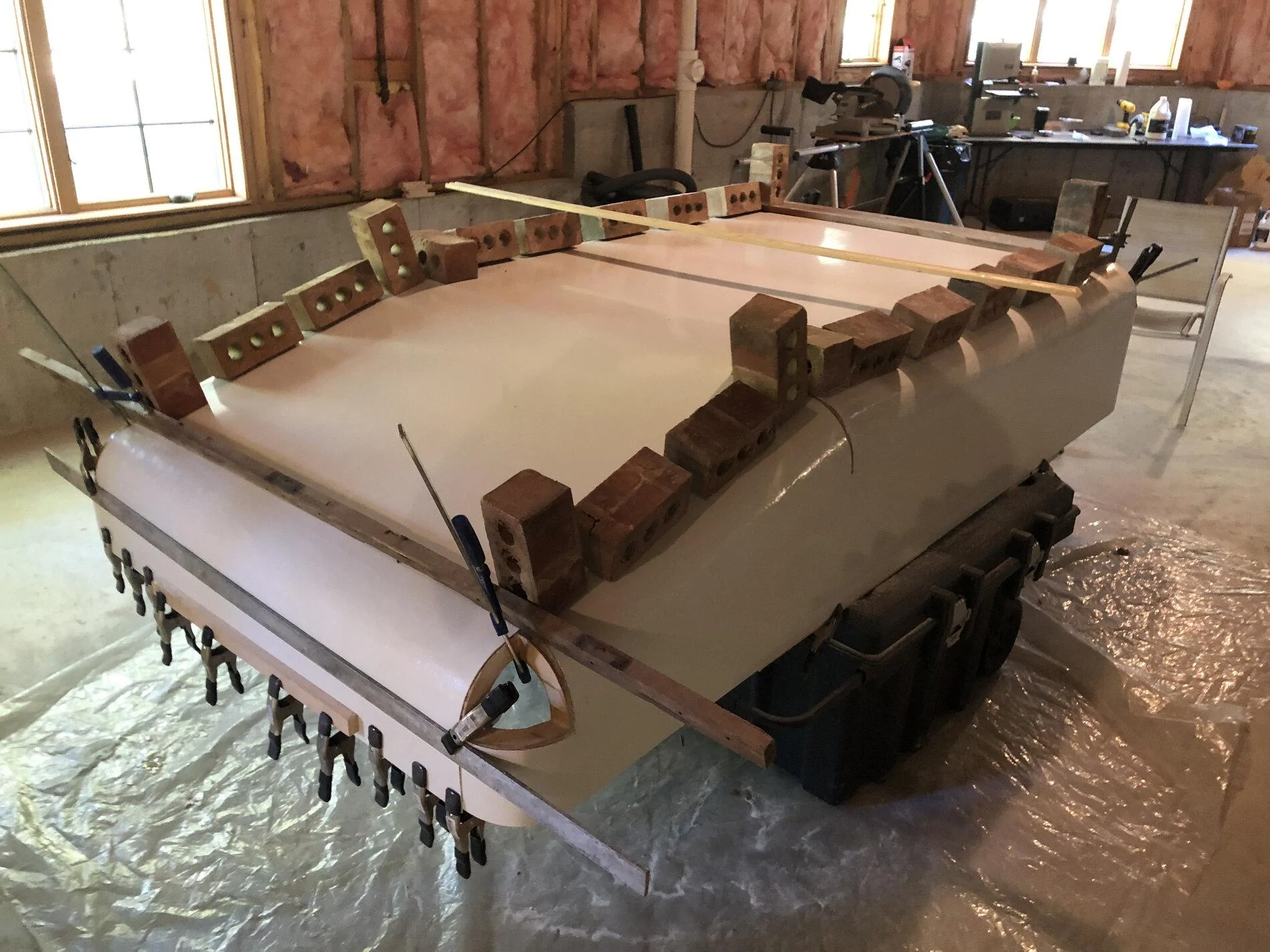

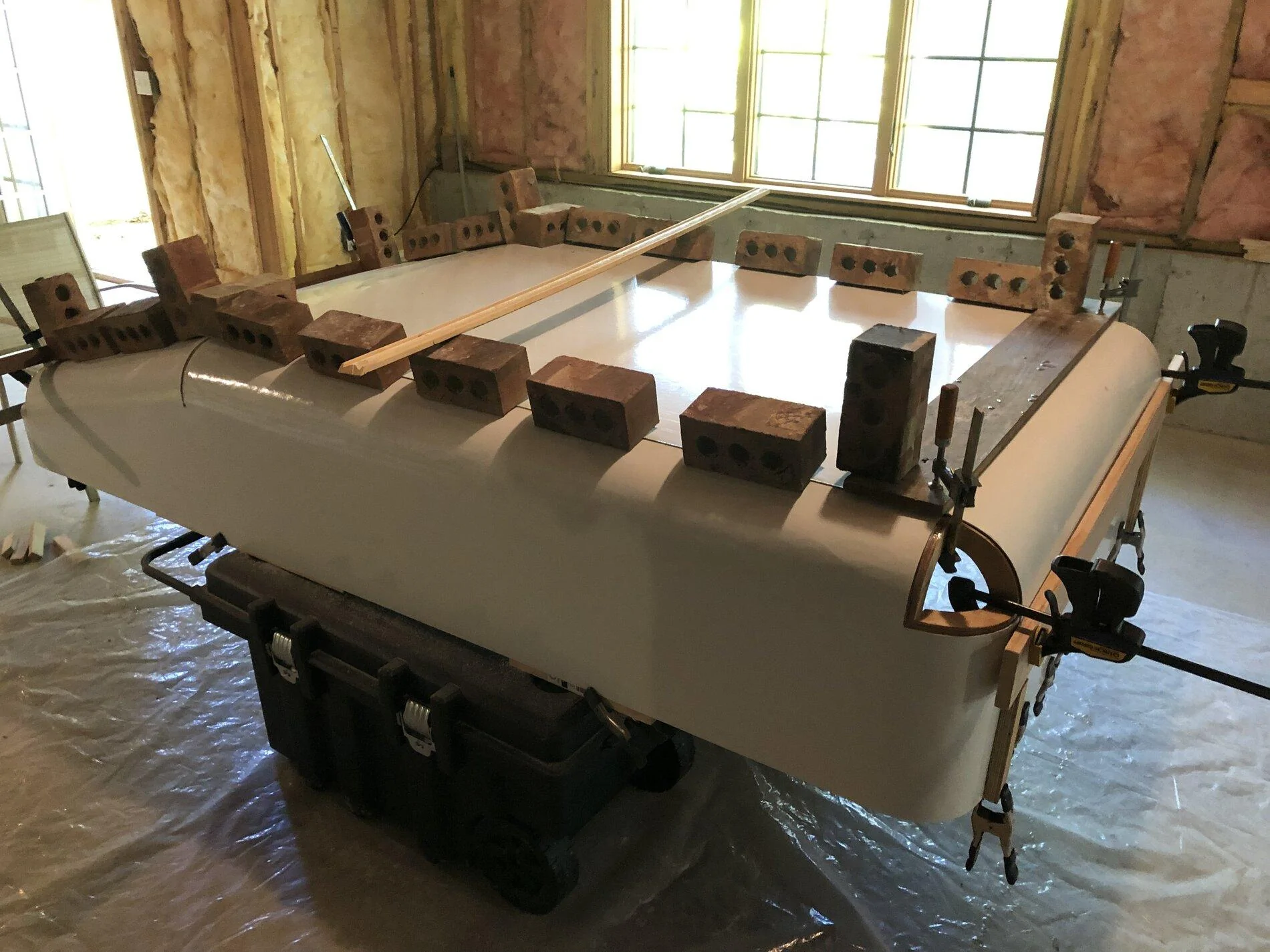

Finally glued the top down. The bricks are holding the seam tight since I can’t reach it with clamps.

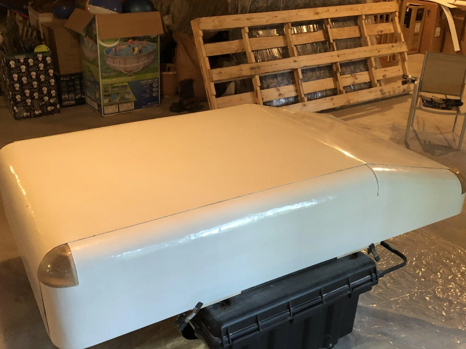

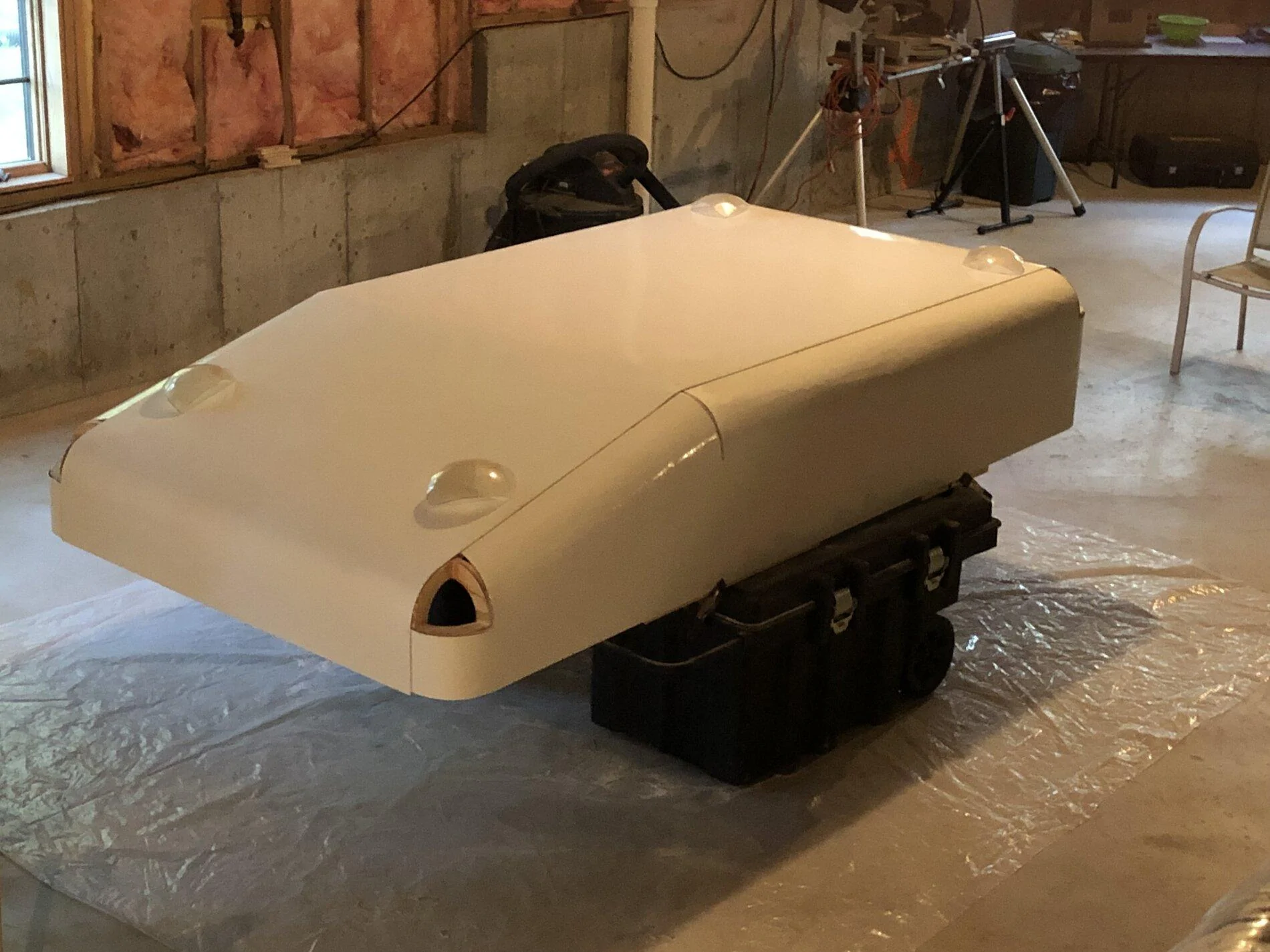

Next up fitting the salad bowl corners and the John boat will be sea worthy;)

What are your plans fir a finish? Gel coat? Paint? Bed liner?
Finish paint Crystal Granite to match the Gladiator. It still needs a lot of work before finish paint.

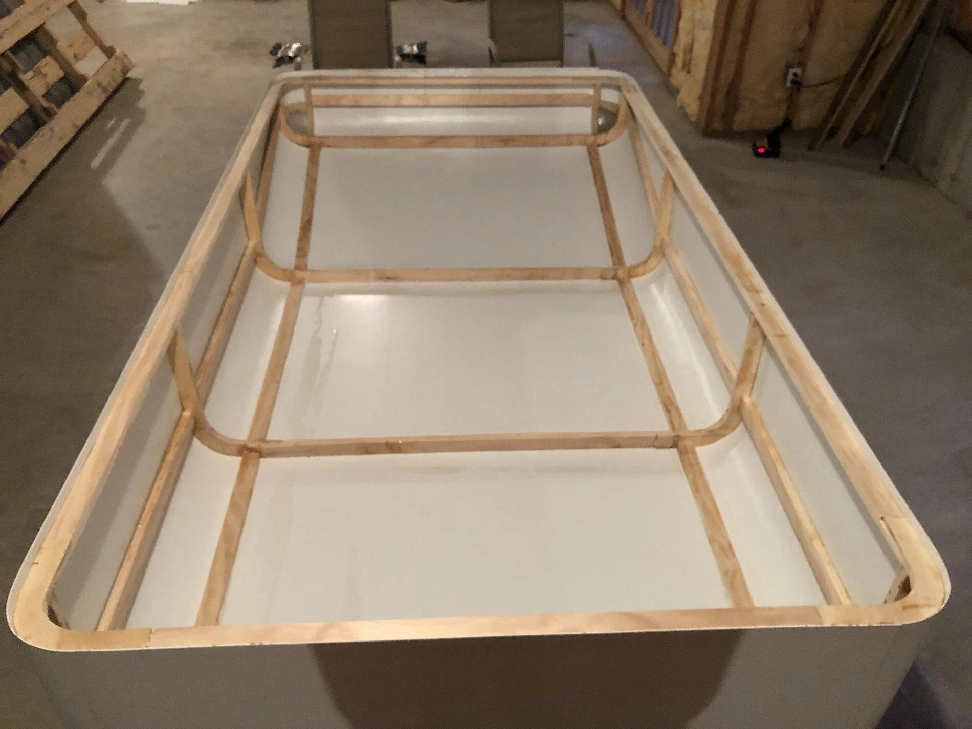

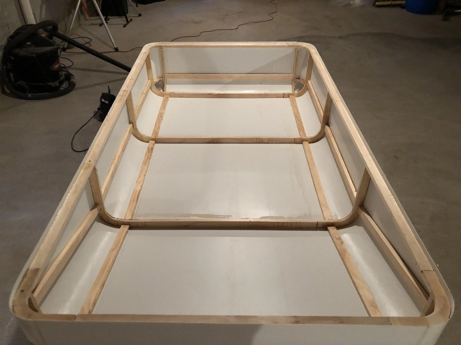

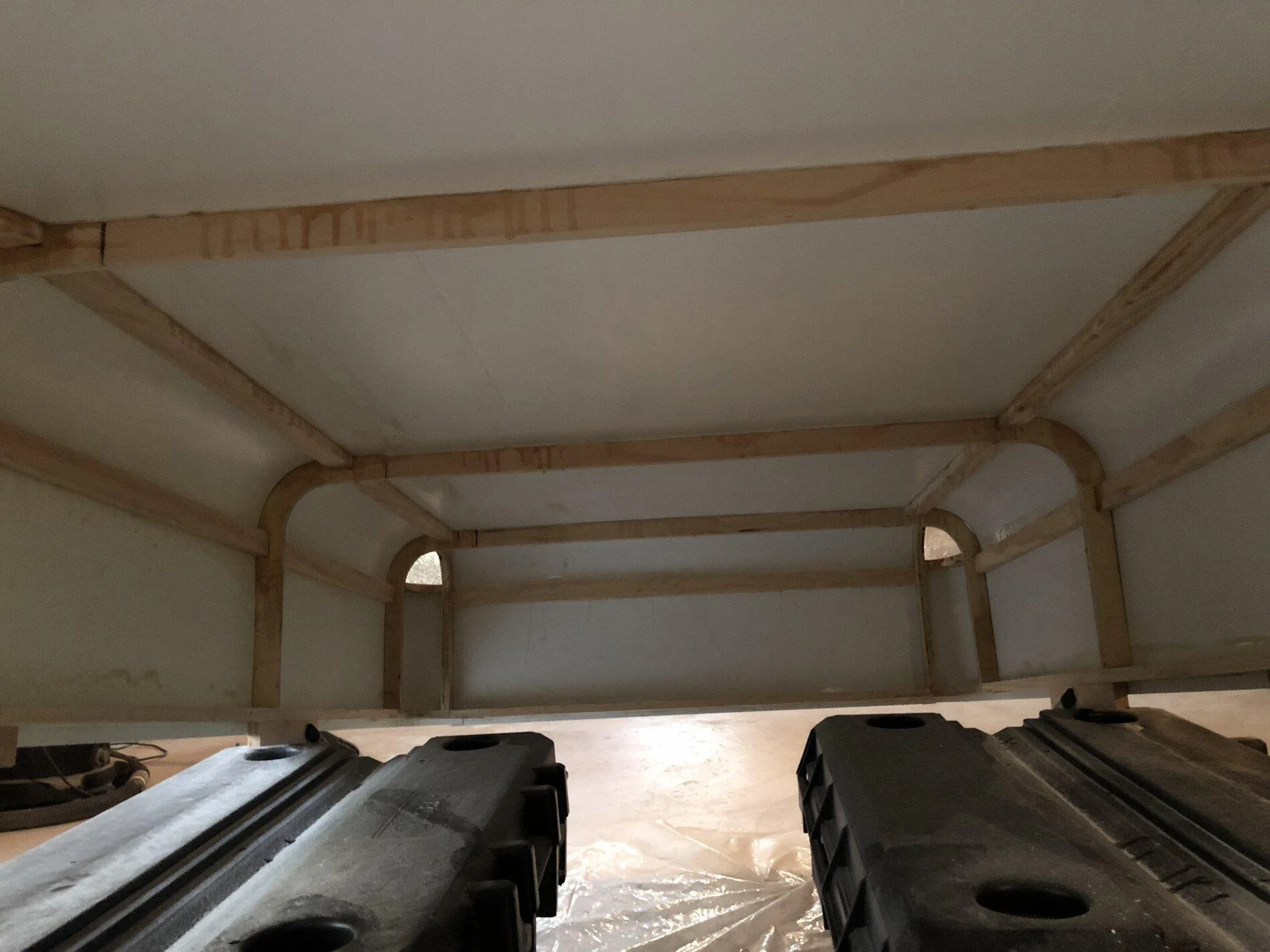

I'm going to use fiberglass to strengthen the connections from the wood ribs to the FRP panels, and also add a layer of glass to the corners. This might take a while, the freezer is empty and it's Deer Season.
