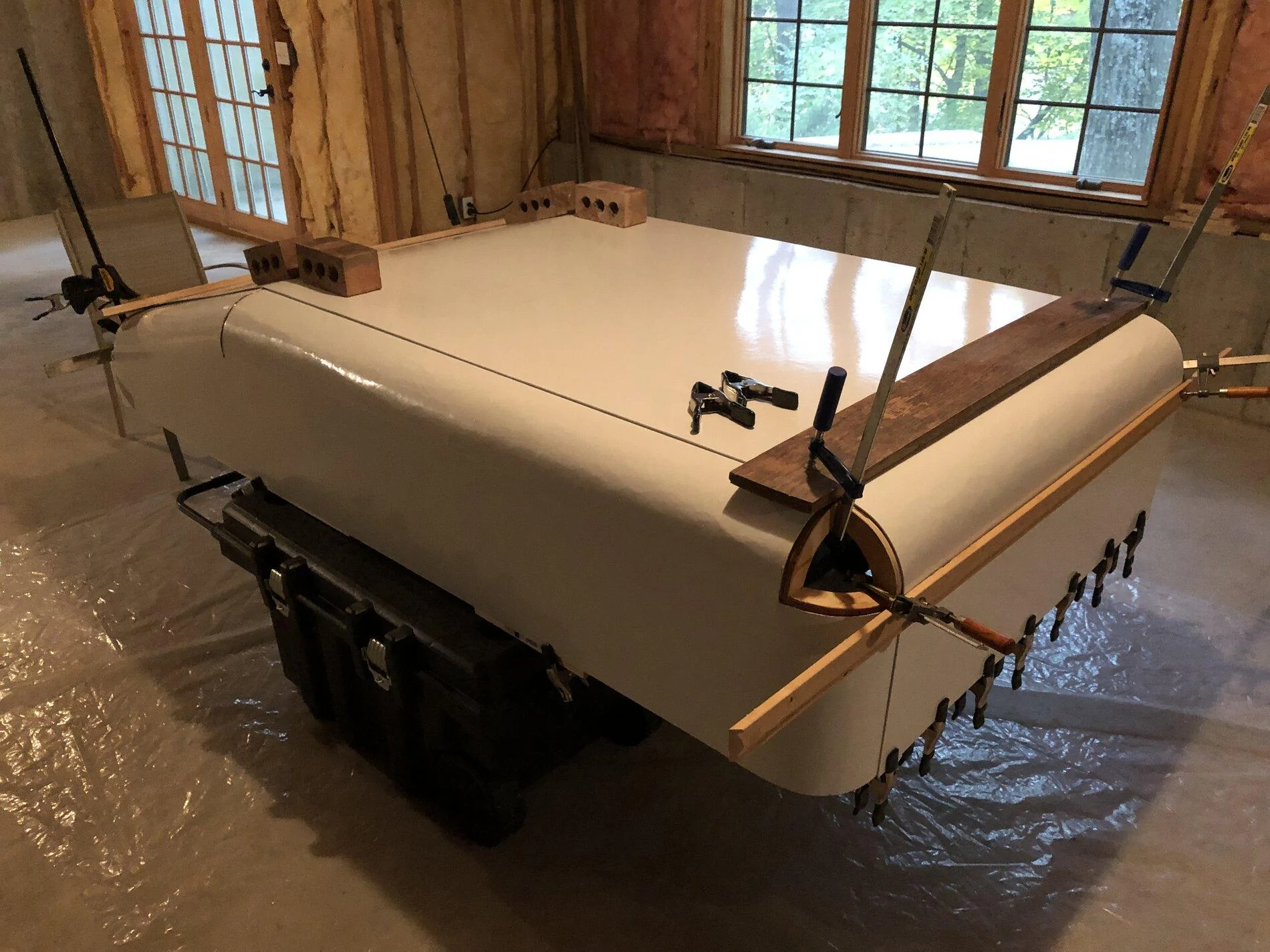

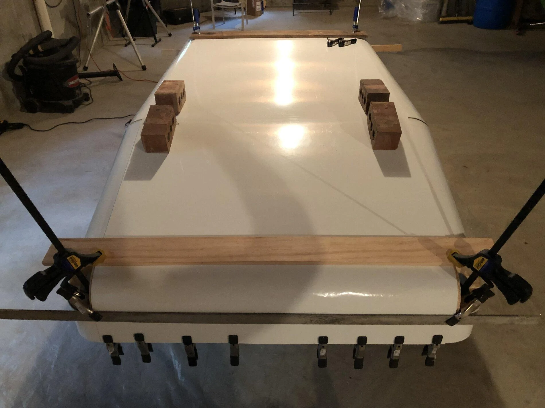

Just a bit of fine tuning before I glue the top sheet with resin.
I'm thinking about running and bending some aluminum 1" X 0.125" aluminum down the long seam lines (another thing on the long list of projects). It would hide the seam and provide a rigid attachment point for a roof rack or other items. It might also look better, breaking up the large bland surface.
Would that be advisable if you want to put a solar panel on later?

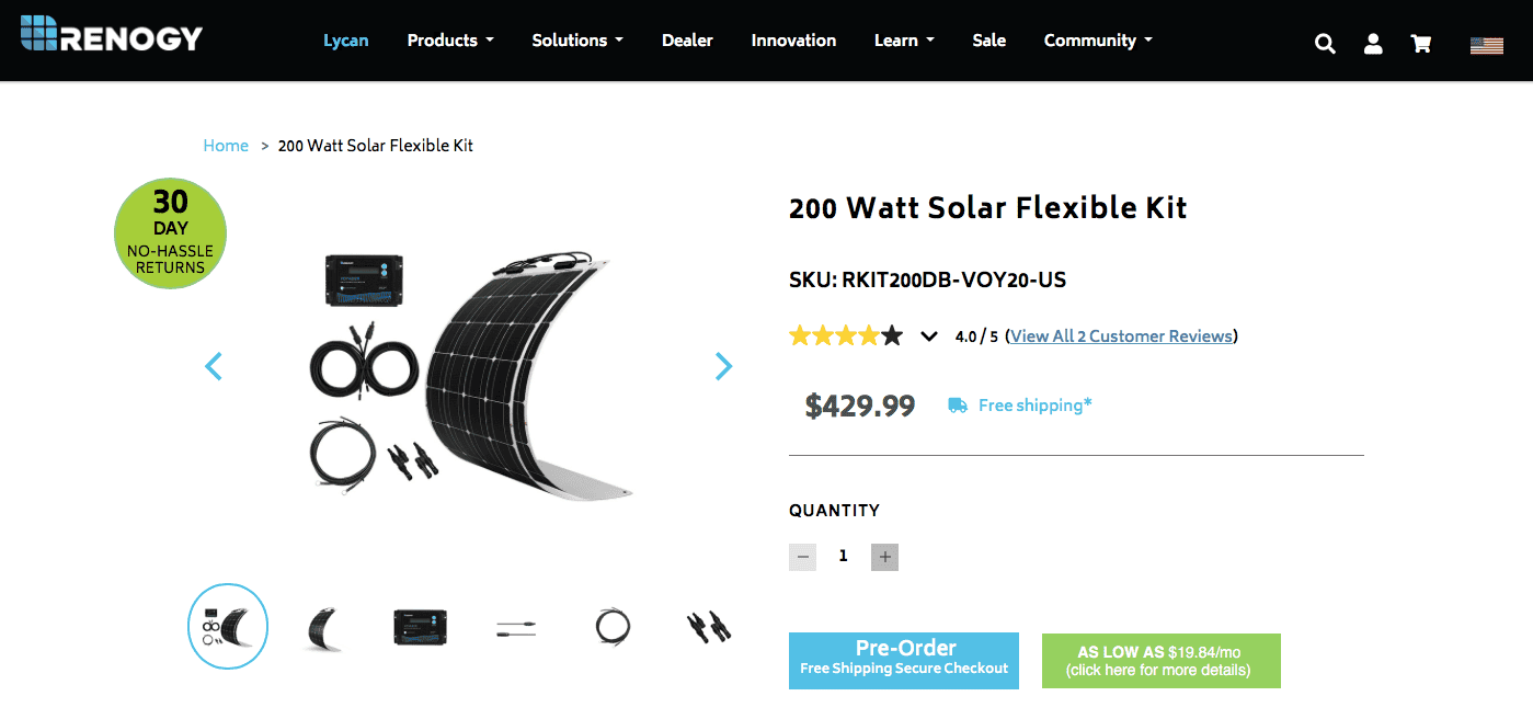

Good catch! I thought I would have enough room to fit two thin panels side by side, but I won't. Looks like thin Panels are 21" wide and I'll only have about 40" between the rails. I wonder if there are some 18" wide 200 watt panels. Back to the internet...
Do you think 175 to 200 watt would be a good size?
If you had any gap between the seams I was thinking about aluminum T-bar. It could go in the seam then be glued or riveted in then sealed as you go.
Good idea. I'll have to do some shopping to see what's available at the hardware store. I'll have to find another solar panel(s) to make sure I have enough room for them later.

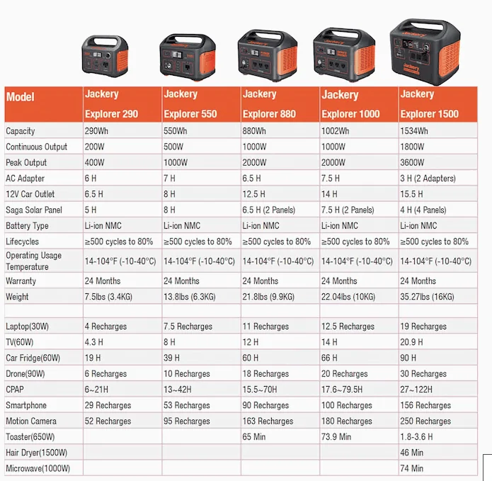

Here's a nice chart showing charge times and run times. One potential downside is that the Jackery's Lithium batteries may only last 500 cycles. The newer Lithium Iron Phosphate batteries coming out now can last 3,000 cycles. For camping, 500 cycles might last me forever, but if you wanted to use it daily, the Jackery may only last a couple years.
The 500 cycles on a Jackery is the lifespan for a full 100% charge. So it will still be useful after 500 cycles. So it may have another 500 cycles where its able to charge to 90% or so. (That's not the actual figure. I don't know what it is). But the 500 cycle life doesn't mean it is useless and done then. It'll go much longer than that, just with lessening capacity as the cycles pile up. It woudn't surprise me if it lasted, say, 1500 cycles at 85% or better. So I wouldn't lose too much sleep over the 500 cycles life when you see what it really means.
I've got a small Jackery 240 that I've had for almost 2 years and I don't know how many cycles it has, but it still gets to 100% and is performing perfectly. I run my Jeep refrigerators and charge my drones with it, among other things.

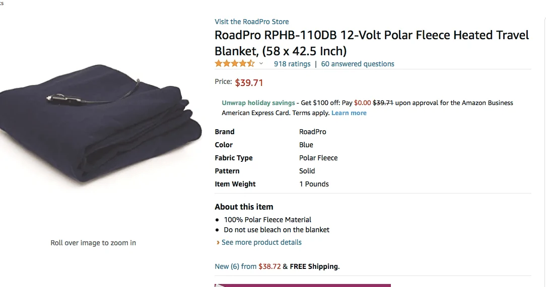

On second thought, electric heat is expensive, but might not be out of the question. It's really a question about insulation and size of the camper. A 50 watt to 100 watt electric blanket is practical and a Jackery 1000 would run a 50 watt blanket 20 hours. Even a Lasko 200 watt heater could last 10 hours on a Jackery 2000. Those numbers are running full on, and could last a lot longer on a thermostat. Don't need the fridge on in the winter to save power.
Remember Tesla cars have electric heat also.
