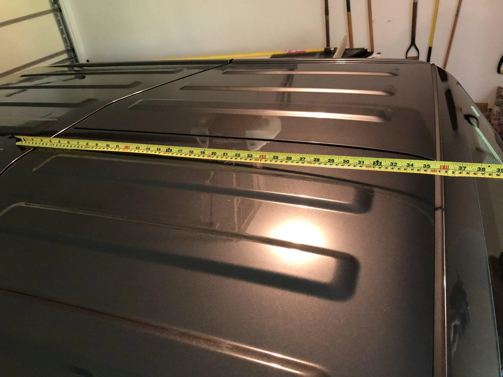

I might be mistaken, but I thought you were trying to keep the ability to use your Freedom Panels over the front seats? The other thing I would check into is how much wind noise you end up with if the spare is mounted there. You could test that ahead of time. The Freedom Panels at the shortest point are only 26", so you might have up to 12" of tire hanging out over the front of the windshield. Even set back you will still have an overhang, and if you have a forward-hinged cap, you will need room for that to pivot.

Good point about hangover! My RTT starts about 2" past the Freedom Tops and it looks like 38" tires would hang right to the top start of the windshield (see picture below). It would be a tight fit.

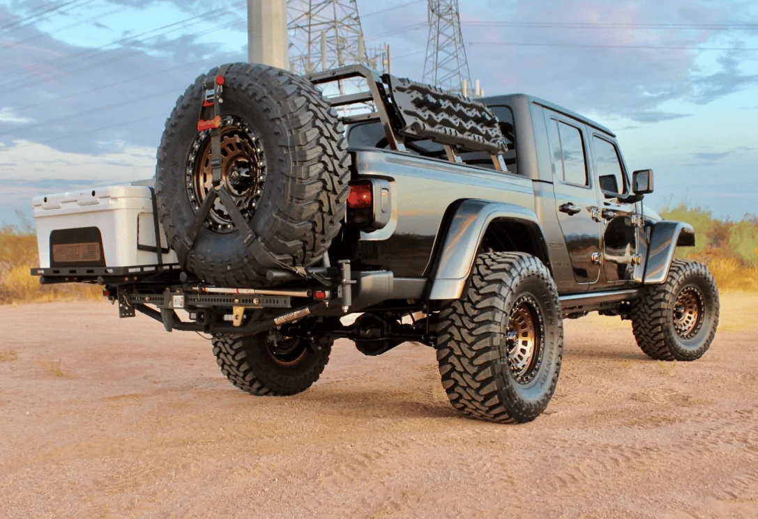

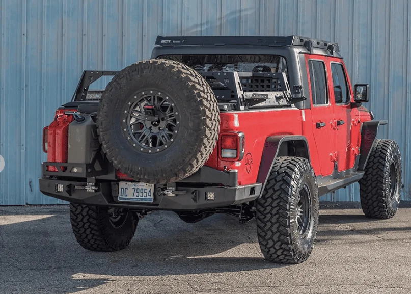

I hear you. Those tires are a beast just to lift into the bed. I still like the idea of mounting it on a back bumper. Maybe by the time I finish the build, there will be some more options on the market.
I like the bumper below, but I think it comes to about $3,000 with all the options (ouch!).
The second picture is a hitch mounted spare, which I'm a bit skeptical about, although it sure looks good and is quite a bit cheaper.

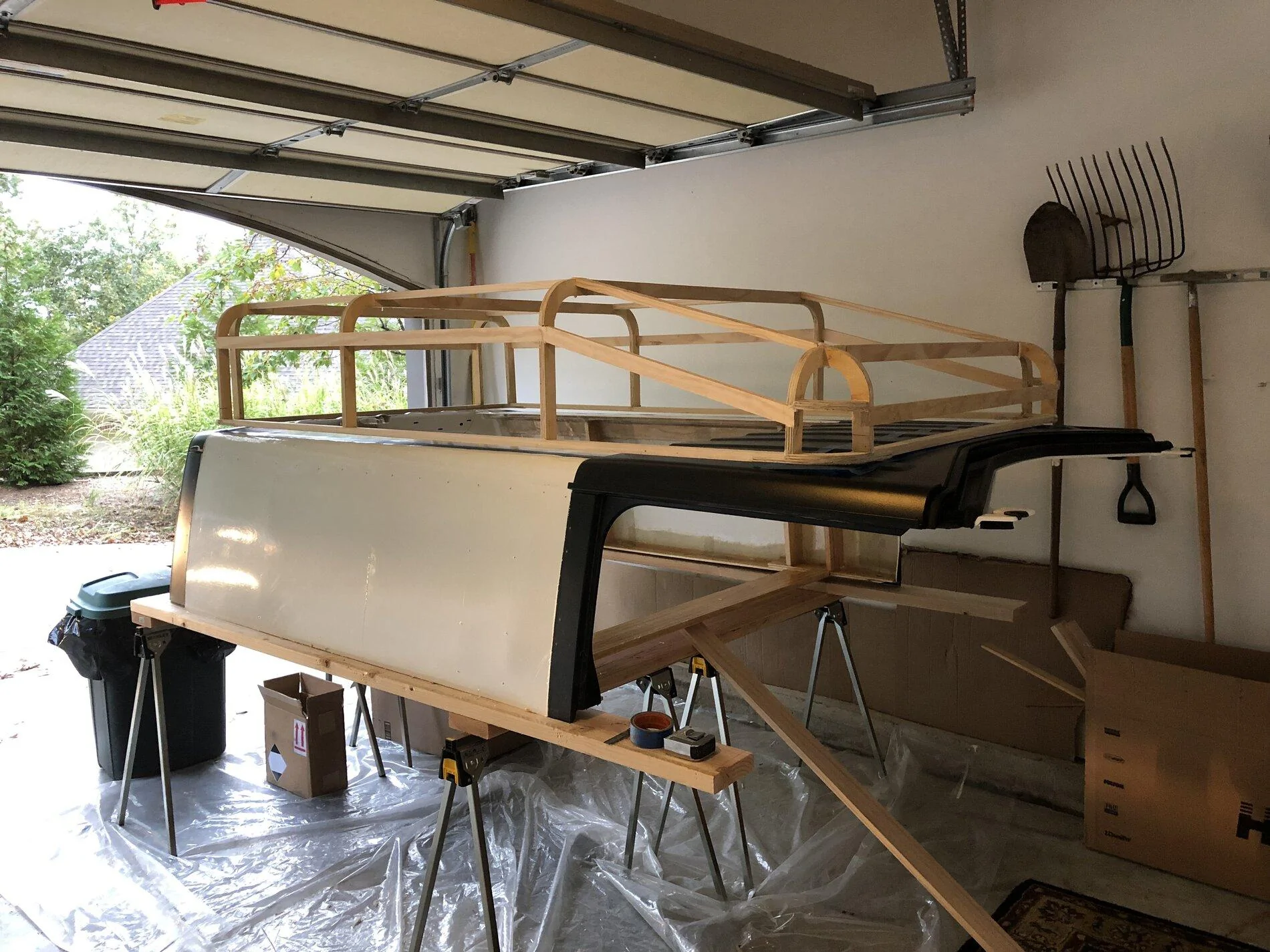

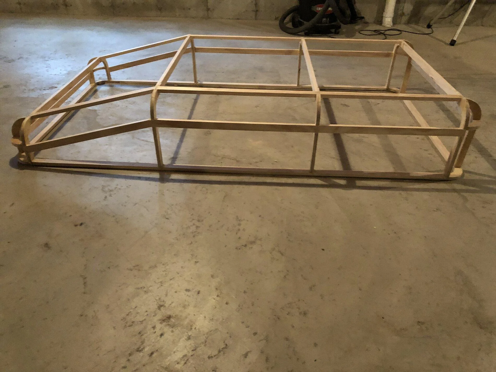

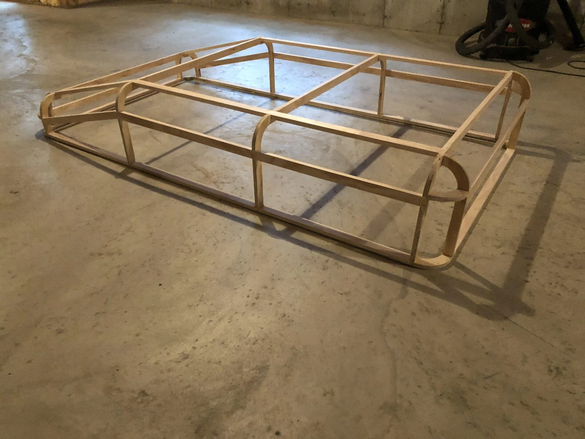

Here's the Roof Top Tent structure fastened together. In case of emergency, just flip it over for a John Boat!
Jeep Gladiator Gladiator Expedition Rigs IMG_5480
Jeep Gladiator Gladiator Expedition Rigs IMG_5481
Mules
Mules
Aug 27, 2020
1,197
3,272
St. Louis MO
'20 Gladiator, '93 Landcruiser, '77 CJ, '88 Bronco
Engineer

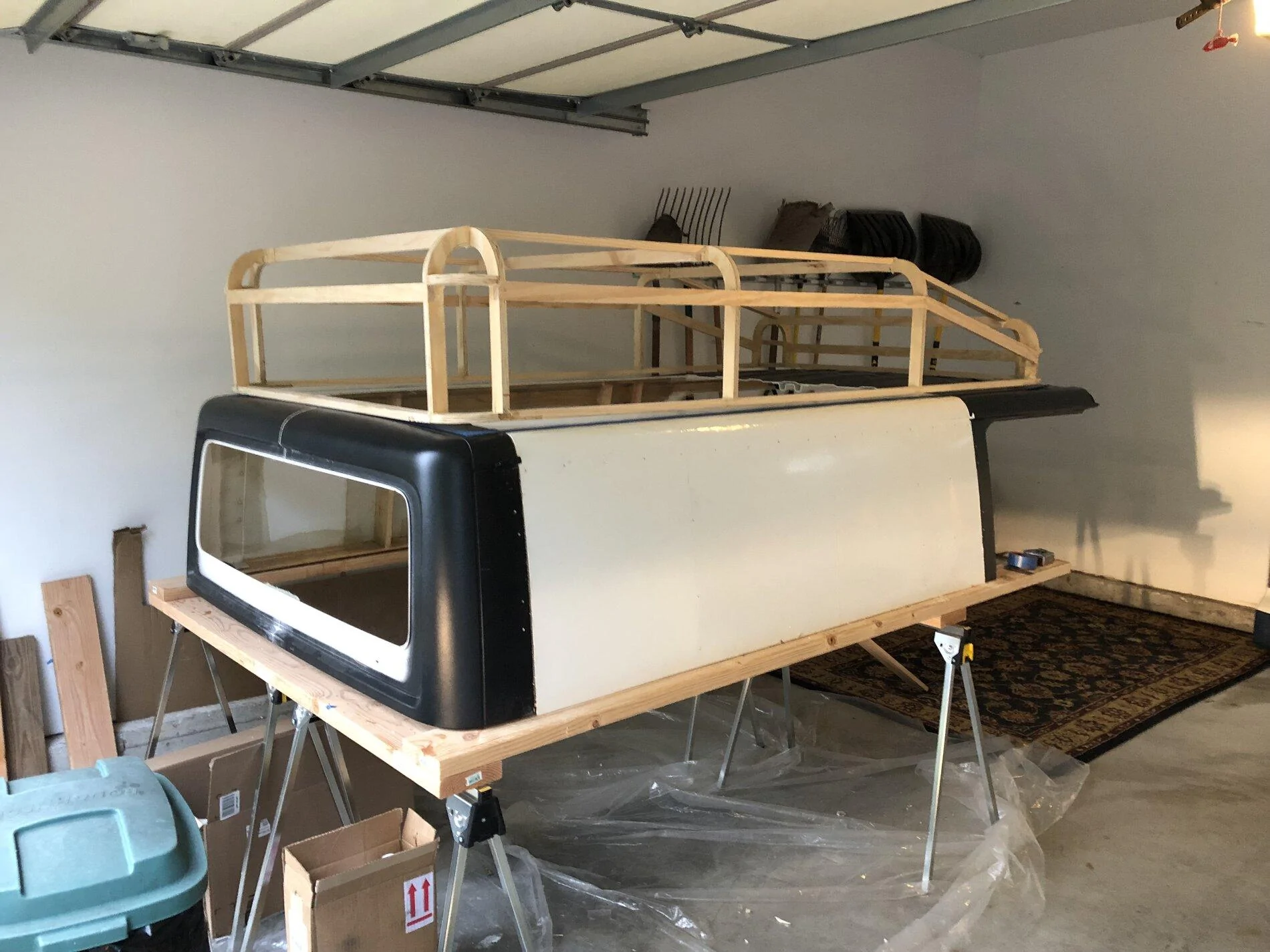

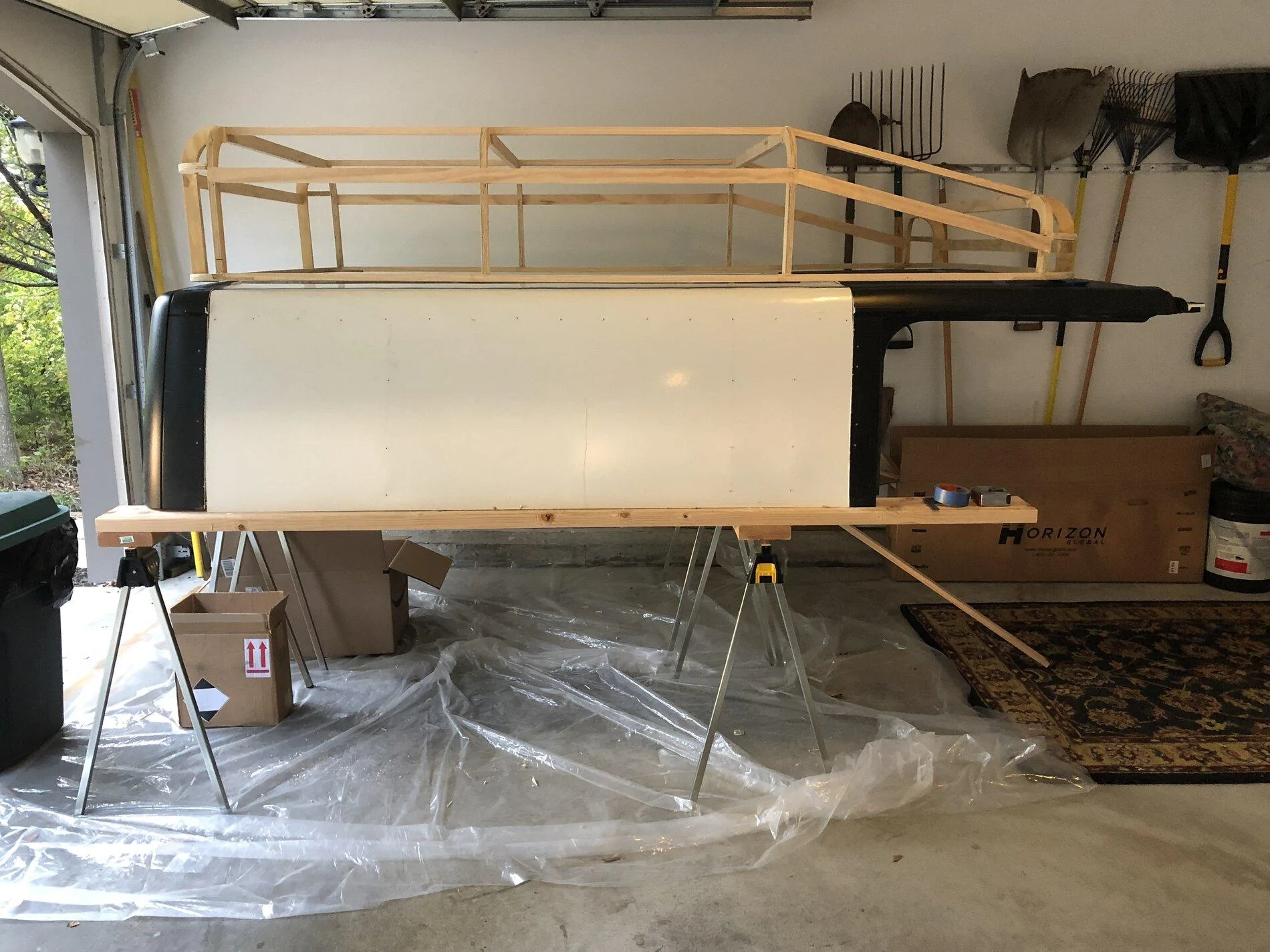

With the added height, I should be able move around inside, when needed, without putting up the RTT. Later on, I could build a low profile top, for my daily driver and fitting in the garage. Just clip on the tall top for camping.

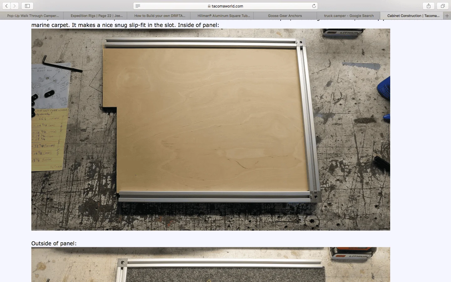

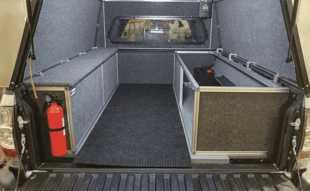

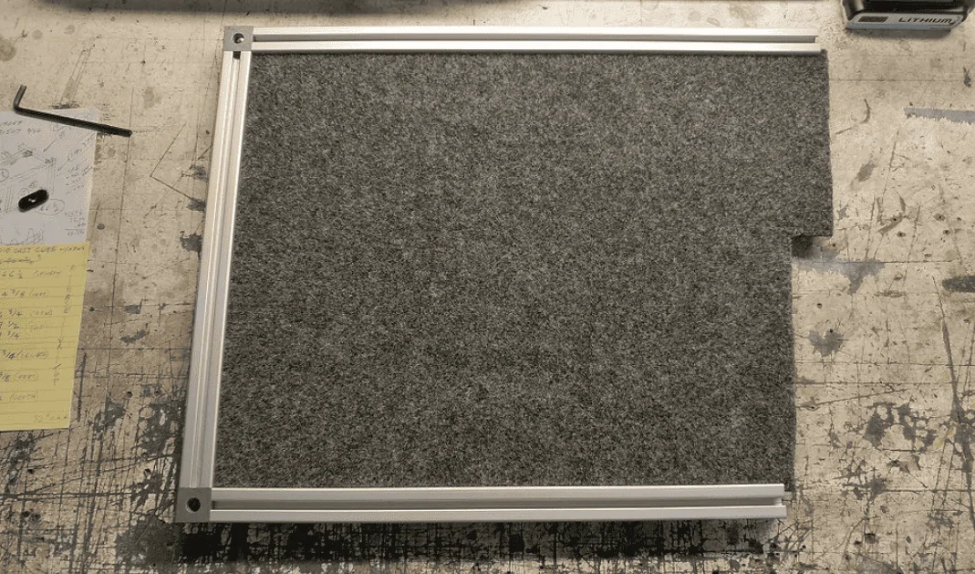

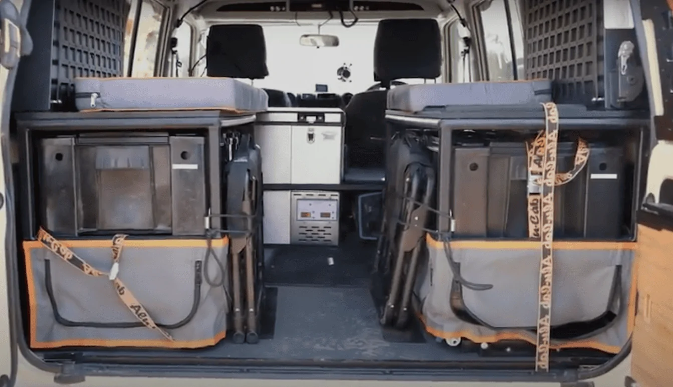

I've got too many ideas still floating in my head for the interior build. Do I make it from plywood, square aluminum tubing, or T-Slot aluminum. T-Nutz has 1" T-Slot aluminum about as cheap as 1" aluminum tubing. The T-Slot price goes up considerably when you add in the corner pieces, accessories, and shipping. My end goal is to build the interior layout light and simple, so that I can quickly take it out and use my truck bed. I'm leaning towards something like Goose Gear but carpeted like the pictures below.
I also like the square tubing design on the bottom. The idea there is to keep the seat frames open and use pelican like boxes for storage.
Jeep Gladiator Gladiator Expedition Rigs Screen Shot 2021-10-23 at 9.39.32 AM
Jeep Gladiator Gladiator Expedition Rigs Screen Shot 2021-10-23 at 9.39.22 AM
Jeep Gladiator Gladiator Expedition Rigs Screen Shot 2021-10-23 at 9.39.06 AM
Jeep Gladiator Gladiator Expedition Rigs Screen Shot 2021-10-23 at 9.52.02 AM
Any thoughts from you DIYers?

I’ll be doing T slot for my build. There are a lot more panel options as well when using T slot in my opinion. Versatility wins over the cost at least for me.
