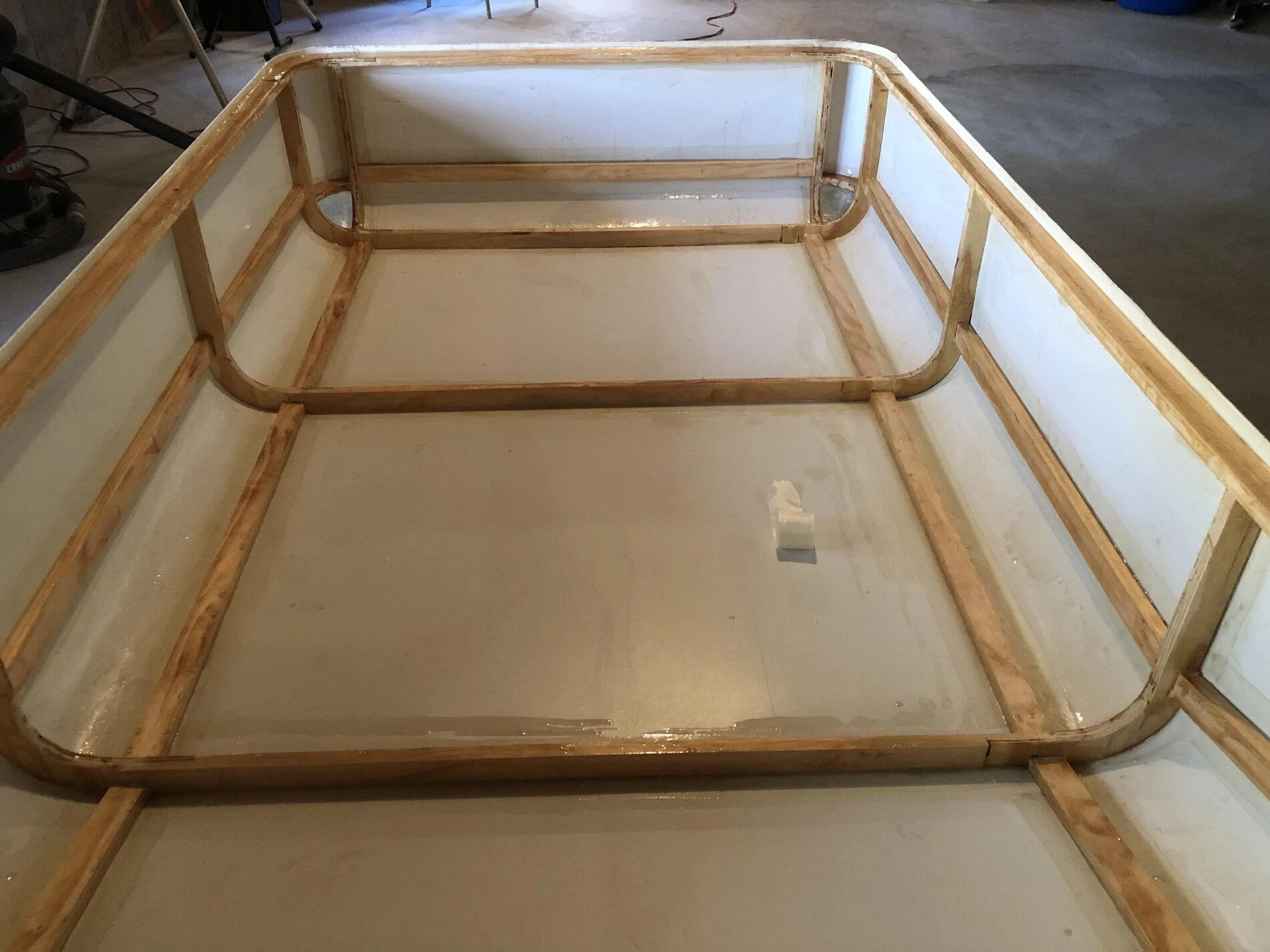

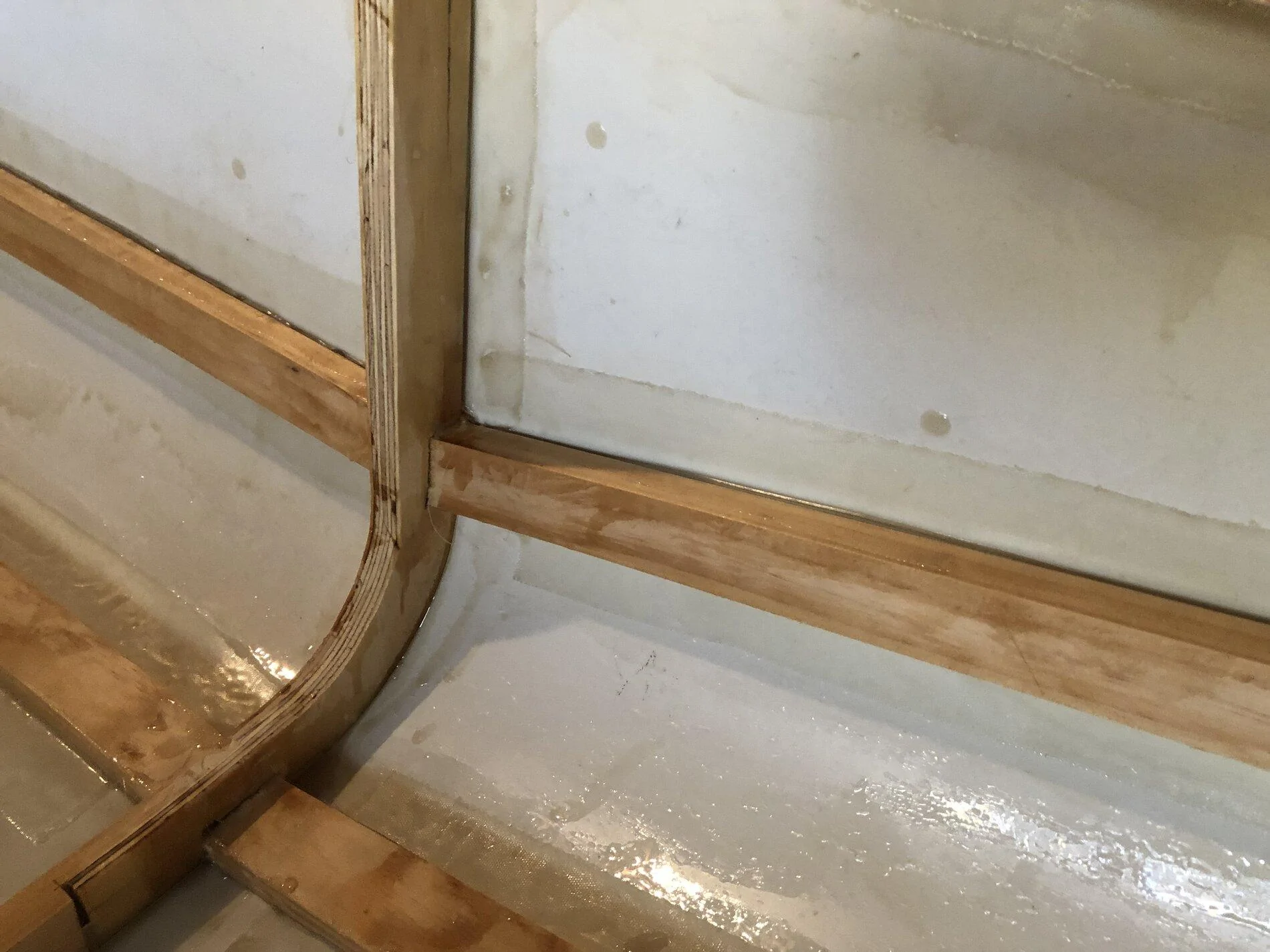

I just finished glassing the ribs to the outside panels. 2” wide woven glass worked nicely. It’s hard to see since it is transparent.

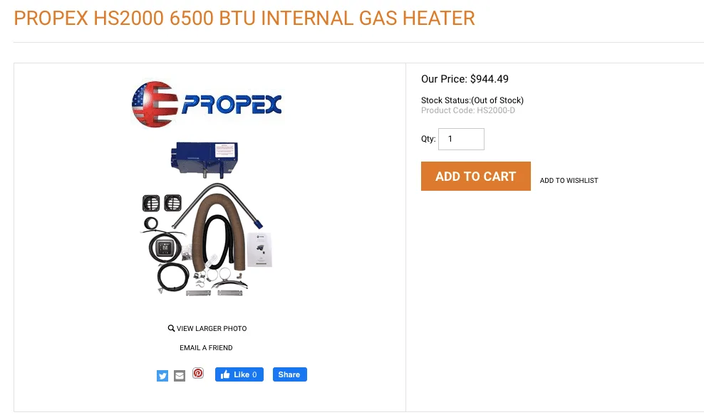

I finally found a propane heater similar to the diesel ones with external exhaust, but a bit pricey.

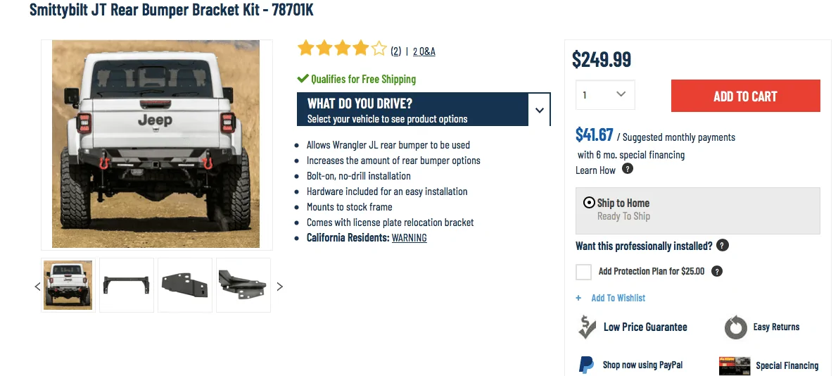

I keep looking for a swing away rear tire mount w/bumper. There are a couple out there but the price quickly goes over $2,000. I just came across this bracket that lets Gladiator owners install JL bumpers. There are a lot more JL bumper/spare tire options out there at much lower prices.
I also called Fab Four (my front bumper), and they said they would be releasing a rear mount spare bumper this January. I like Fab Four because they are US made, heavy construction, and powder coated. If you don't get powder coated, don't be surprised if your new Jeep has a rusty bumper in a couple years.
Remarkable craftsmanship!!! I cannot wait to watch as you complete it...

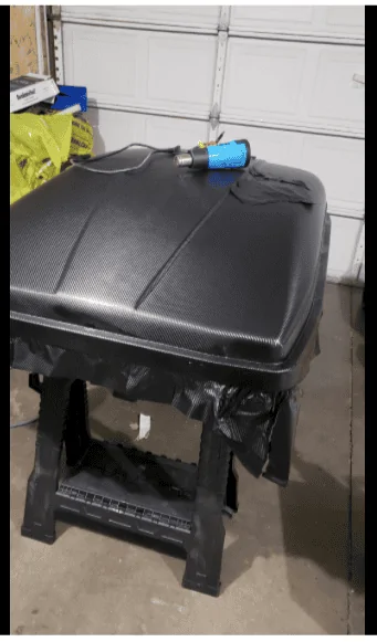

After a bit of final fitting, it will be time for bondo and paint. My idea is to have a professional paint it to match my Metallic Crystal Granite Gladiator, which will look great but cost some coin. Being the thrifty (cheap) DIY'er I am, I'm thinking about doing it myself. I'm thinking about priming it myself and doing a vinyl wrap like the Amazon carbon fiber wrap pictured below. They also have black camouflage wraps that might look good.
Jeep Gladiator Gladiator Expedition Rigs Screen Shot 2021-11-18 at 12.05.29 PM
Any thoughts on the subject? Any experience with vinyl wraps on 4x4s?

What climate will you be in mostly? Vinyl wraps have a lifespan largely impacted by climate. Extremely hot and dusty climates will have a much bigger impact on lifespan. If you do go that route spend the additional money for a high quality brand and for the automotive specific materials (3m and Avery are both good quality)
