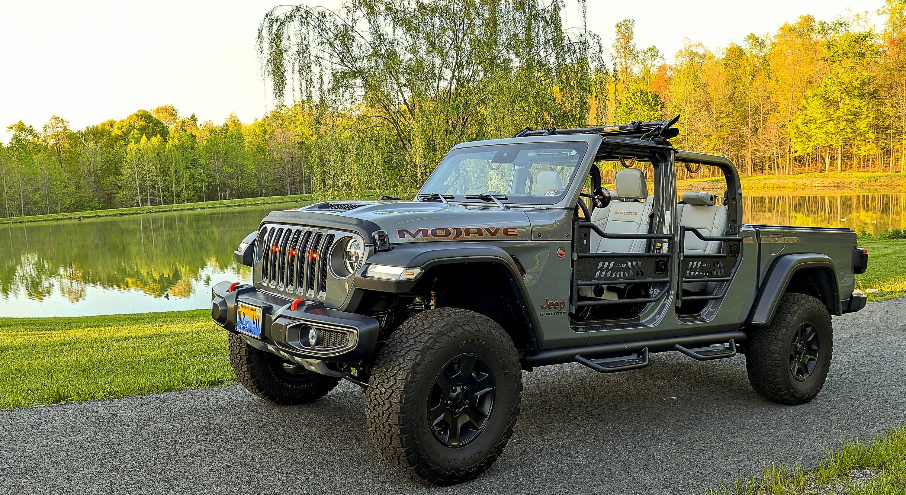

2023 Jeep Gladiator Mojave; 2022 Ford Bronco BL 2-DR/M
Steel hood with faux scoop,
reinforced frame
bolstered seats
Fox 2.5" internal bypass remote reservoir shocks
wide Dana 44 axles
cast iron knuckles
2.72:1 low range (up to 50 mph in 4 low)
4.10 gearing
1" taller than Rubicon in stock configuration
hydraulic jounce bumpers
strengthened front upper control arms
strengthened lower control arm mounts
strenghtened cross members
reinforced shock towers
rear track bar has a larger outer diameter, larger bushings, and a higher strength tube
wheels 7.5 mm shallower backspacing than Rubicon
"racing grips" steering wheel
rear locker can run in 4 high in off-road plus mode
orange things
