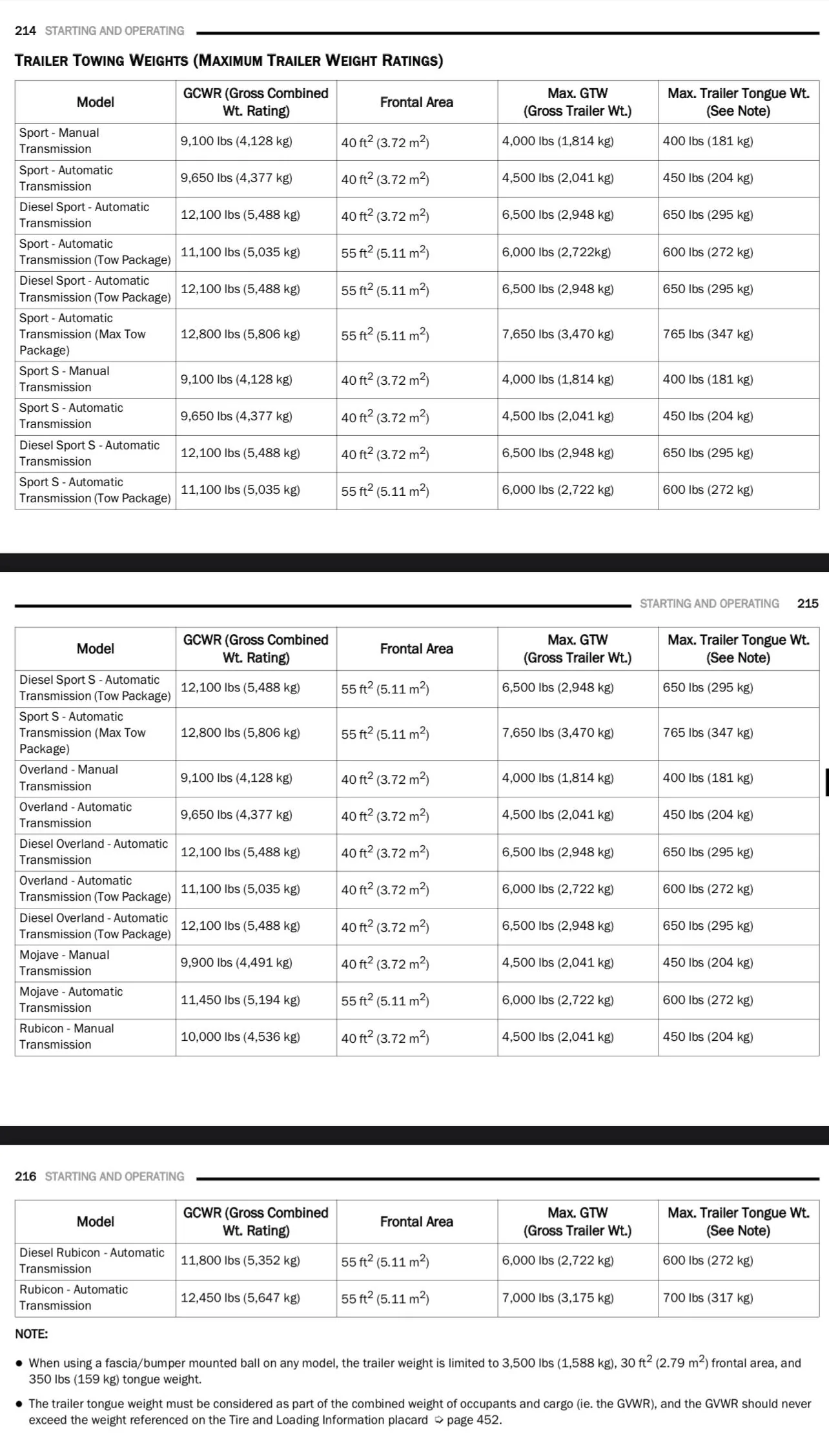

So technically, the way it works as I understand is: They rate the frame, axles, and brakes for its max capacity, meaning 7650 for the jeep with the wide axles. Then, once they start adding bits, i.e. soft suspension, lift, heavier skid plates, steel bumpers, etc, they reduce the rating to compensate.
SO by definition, any Rubicon/Mojave is a "Max Tow" in that it has the frame, axles, and brakes for that designation, but, the added bits to make it a Rubicon/Mojave reduce the weight rating. Also mentioned is the cooling fan, a small piece that does not effect your actual tow capacity, but will effect your ability to tow any capacity with real meaning for an extended period of time.
This guy is completely correct . Look at the diesels they tow less why cause the weigh more already. The Rubicon Auto tows more than Rubicon standard why? Cause clutch is a weak point. It is all factored in ever package . Mine say 7000 , and 700 tongue weight No way in Heck I would ever want to tow like that at its max. Wind shear alone will tear you UP. Just pull less or get a diesel.

Why if the Jeep Gladiator Mojave that I'm buying has included already all equipment for the MAX TOW PACKAGE, it only can tow 6000 pounds as by the VIN said.??????
Because it is a Mojave not a max tow. Max tow is only available in the sport or sport s.

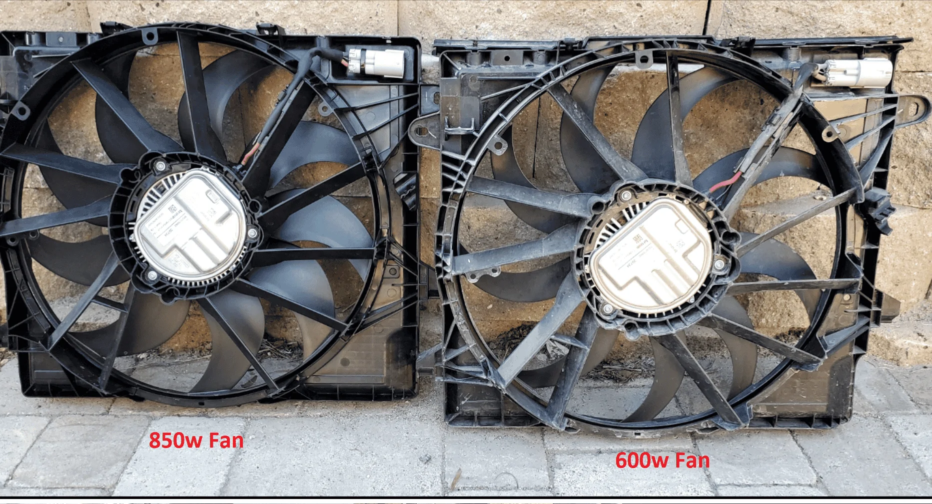

Mojave doesn't have the 850w fan or 240a Alternator unless it was optioned with the towing package for the fan and alt, or the aux switches for just the alt.
There is a myth that Mojave comes default with the HD cooling fan. It doesn't. It comes with the same 600w fan all the other Gladiators without the towing package get.
Out of curiosity, if they don't come with the tow package stuff, then why is the tow rating the same with or without the package on the Rubicon, Mojave, and diesel? I was under the impression that they all already have that stuff, otherwise they would be rated to tow less. That's the reasoning on the Sport and Overland, because adding those items along with the hitch gets you the higher rating. It would stand to reason if they didn't have those already, then they should have a lower rating too.

Without the tow package and aux switches, Rubicon and Mojave get the base 180a alternator, base 600w cooling fan, and base battery.
Tow Package:
Class IV receiver
850w fan
240a alt
Bigger and better battery
Aux Switches:
Aux switches ( duh )
240a alt
Neither:
600w fan
180a alt
Turd battery

7 Pin trailer connector and "trailer sway control" on the window sticker it was essentially the max tow package.
ONLY Sport gets max tow. Anything else it's simply a tow package.
ALL GLADIATORS come with the wiring and trailer connectors in the bumper, tow package or not. It's part of the wiring harness for any JT.

If he told you you had the 850w cooling fan you should go demand they put it on there because I can all but guarantee you don't have it unless your sticker says Tow Package and somehow Jeep "forgot" to put on the Class IV receiver. Mojave gets nothing additional for engine cooling by default.
You can get a low mile used one here:
https://www.rubitrux.com/mopar-68272755-radiator-fan-cooling-module-shroud.html
It's all you need to add. Easy swap.

You can see the part # without removing anything, stick your phone down there and snap a pic of the center of the fan. You can tell by the blades as well.
Thanks, this could come in handy as I'm putting together a checklist to inspect when I go to pick up my Jeep. Wasn't sure how I'd spot the 850w fan, 240 amp alternator, or 700 amp battery unless they had stickers on them.
